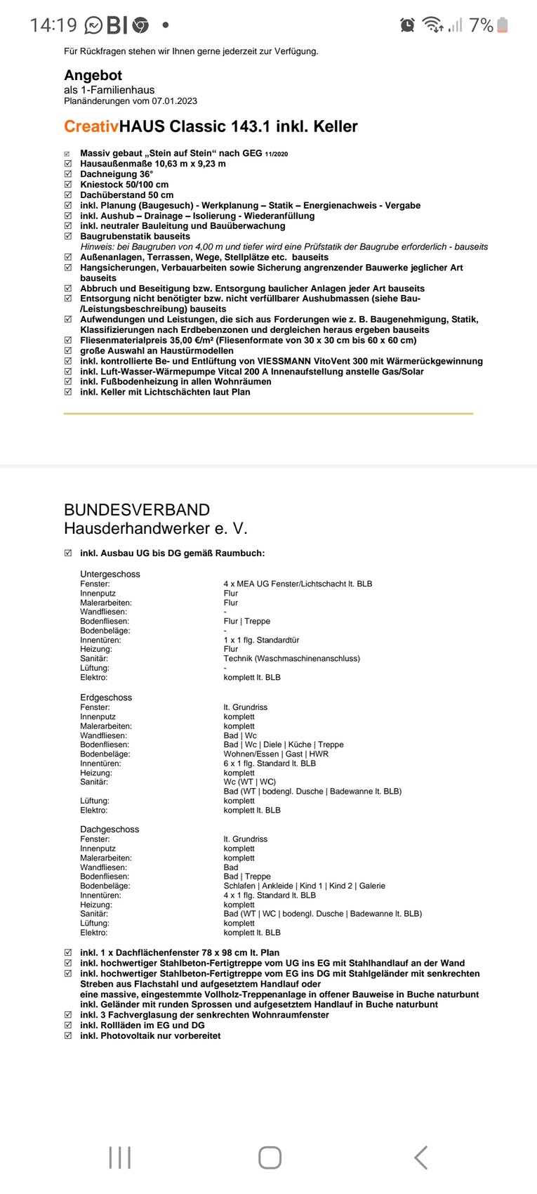

Lauralila88
19 Jun 2023 14:27
hanghaus2023 schrieb:
It’s clearly stated in the contract!!! I have already requested this here multiple times.
Offer
as a single-family house
Plan revisions from 07.01.2023
CreativHAUS Classic 143.1 including basement
 Solid construction “brick by brick” according to the Building Energy Act 11/2020
 Exterior house dimensions 10.63 m x 9.23 m (35 ft x 30 ft)
 Roof pitch 36°
 Knee wall height 50/100 cm (20/40 inches)
 Roof overhang 50 cm (20 inches)
 Includes planning (building permit / planning permission application) – detailed design – structural engineering – energy certification – tendering
 Includes excavation – drainage – insulation – backfilling
 Includes independent construction management and site supervision
 Excavation pit structural analysis by client
Note: For excavation pits 4.00 m (13 ft) deep or more, a verification analysis of the excavation pit is required – by client
 Exterior landscaping, terraces, paths, parking spaces etc. by client
 Slope stabilization, shoring work, as well as securing adjacent structures of any kind by client
 Demolition and removal or disposal of existing structures of any kind by client
 Disposal of excavated materials not needed or not reusable (see construction / scope description) by client
 Costs and services resulting from requirements such as building permit / planning permission, structural engineering, earthquake zone classifications, and similar by client
 Tile material price €35.00 per m² (tile sizes from 30 x 30 cm up to 60 x 60 cm) (€3.25 per sq ft)
 Wide selection of front door models
 Includes controlled ventilation system by Viessmann VitoVent 300 with heat recovery
 Includes air-to-water heat pump Vitocal 200 A for indoor installation replacing gas/solar system
 Includes underfloor heating in all living areas
 Includes basement with light wells according to plan
I just copied this now, couldn’t manage it any other way
Bauangebot: CreativHAUS Classic 143.1 inkl. Keller mit Listen und Plänen
