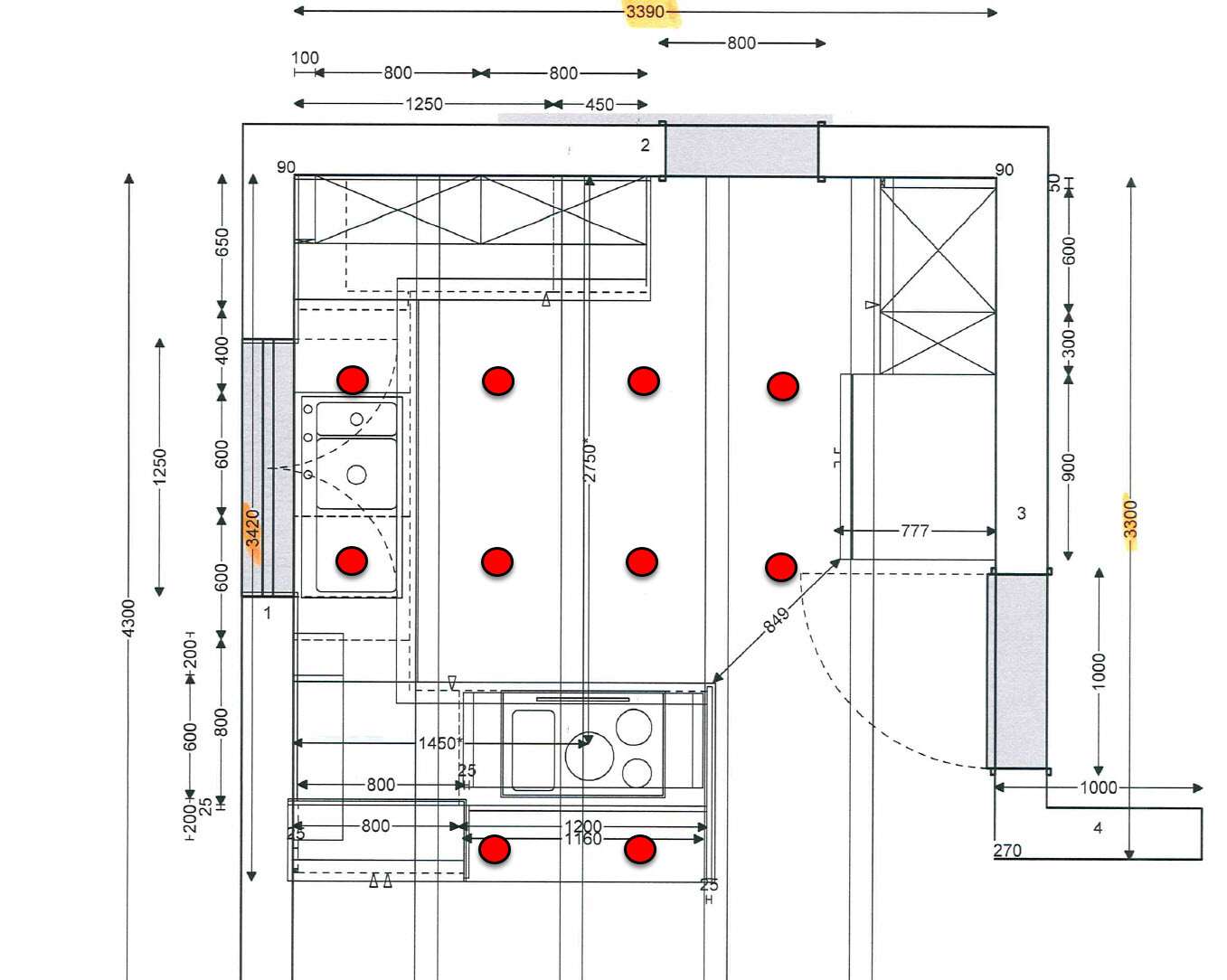

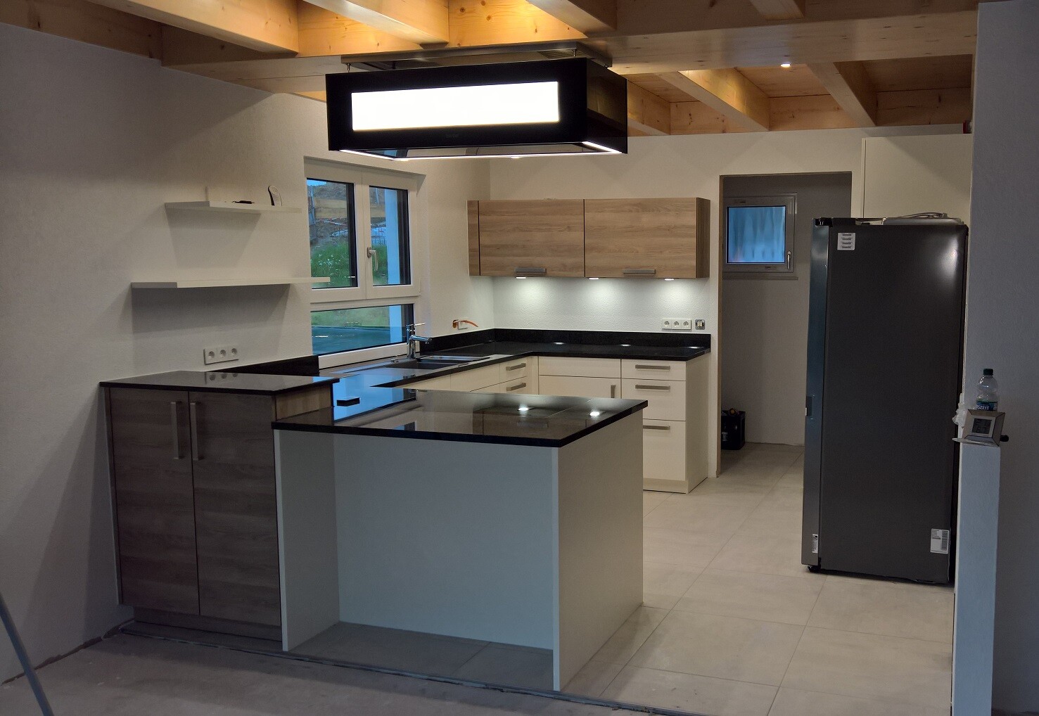

We have 8 recessed lights in our kitchen, plus two more above the dining area. They are evenly distributed throughout the kitchen, with two positioned directly above the sink. The lights are 3.5W at 2700K. Above the stove, we have a recirculating range hood with built-in LED lighting, and there are also LED lights installed beneath the wall cabinets. The lighting is perfect in every area and great for working. I wouldn’t want to change anything.
I’ve attached our kitchen plan with the approximate positions of the recessed lights marked, as well as a photo of the finished kitchen. The positions are estimated and not exact to the centimeter. I need to measure again since I didn’t create the drawing digitally.
