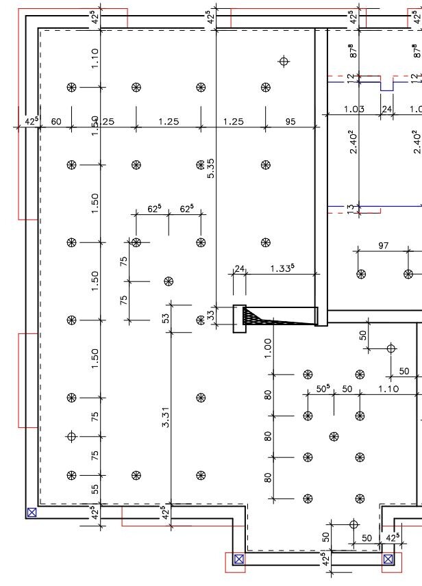

Hello aytex, lighting intensity often depends a lot on personal taste when designing a house or apartment. My in-laws sit almost in the dark during dinner, while I prefer it quite bright.
What I did was first decide on one type of LED (for me, 230V 4W GU10 LED spotlights), then I ordered several samples from different manufacturers and tested them at home in the dark. This helped me get a good feel for the required spacing.
The room and furniture layout also plays a role. In my living/dining area (42m² (452 sq ft)) I installed 20 spots arranged in a 1.50 x 1.25 meter (5 x 4 foot) grid, and in the kitchen (14m² (151 sq ft), where I like it a bit brighter) I used 8 spots arranged in a 0.80 x 1.00 meter (2.6 x 3.3 foot) grid.
