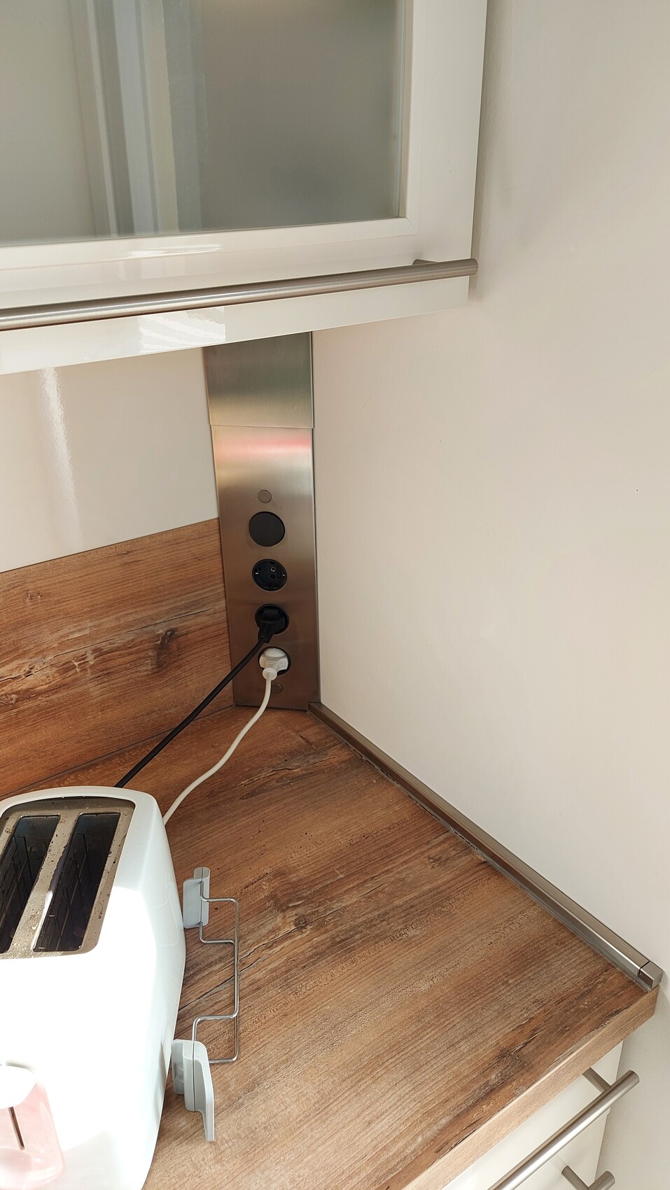

Benutzer20014 Feb 2022 09:36Pitiglianio schrieb:
They unnecessarily take up space on the countertop and also tend to collect dirt. Not at all. Anyone who plans properly – and that includes having a countertop deeper than 60cm (24 inches) – will actually appreciate these.
Not to mention the rather expensive solutions. I believe that starting from 40€ for the double socket plus drilling, the price might even be cheaper than some electricians.
