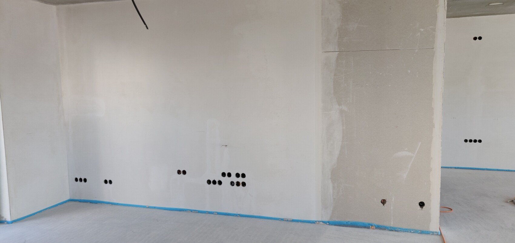

This is what it looks like at our place.
The recessed floating TV cabinet includes:
2 x TV outlets (in one box)
2 x CAT7 duplex ports
7 x power outlets (theoretically all individually switchable)
Speaker cable connection for 5.1 surround sound
(Cable duct 10x6cm (4x2.4 inches) from cabinet behind TV)
Additionally, I have routed speaker cables inside the wall here, plus power for a subwoofer, as well as power outlets for vacuuming on the right and for a Christmas tree on the left.
