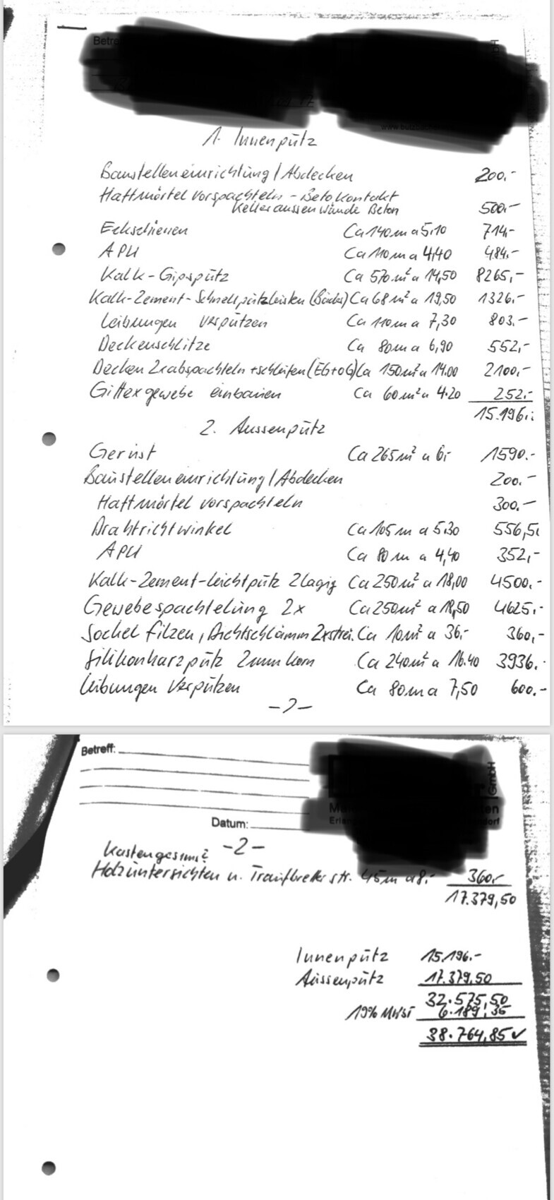

Here is an example of what such an offer might look like. However, it is from late 2017 and the price will actually be lower since the scaffolding will not need to be dismantled again.
The building has 2 full floors with 140 sqm (1507 sq ft) plus a basement made of cast-in-place concrete, where only the interior walls in the basement will be plastered additionally.
