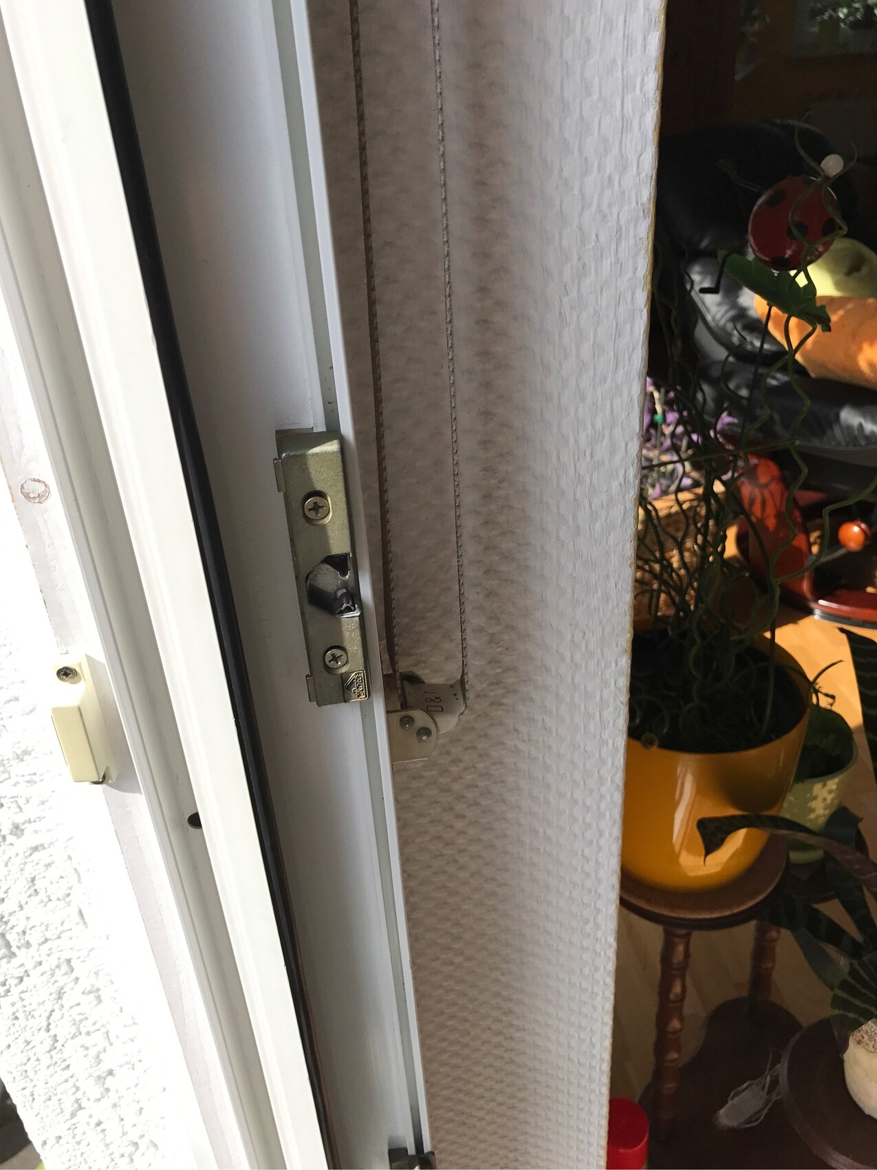

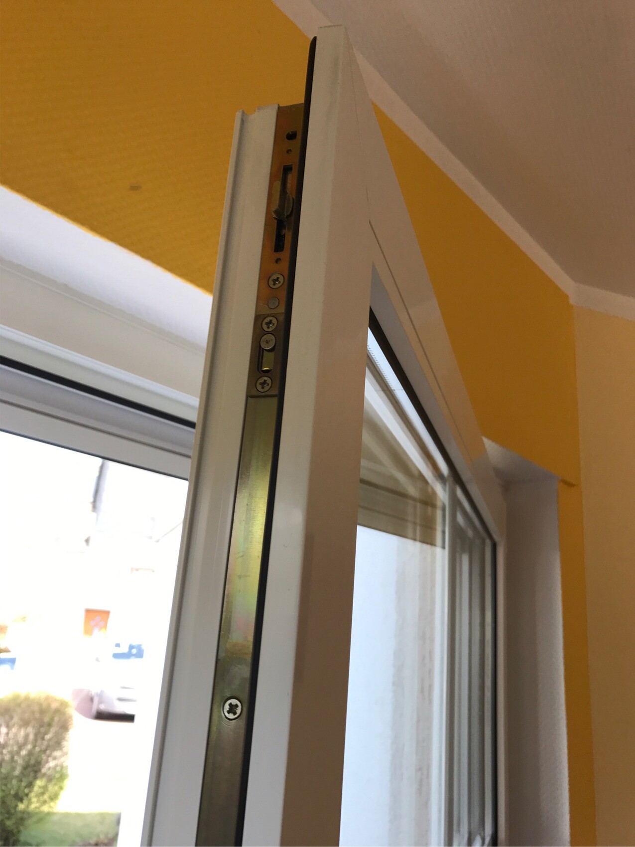

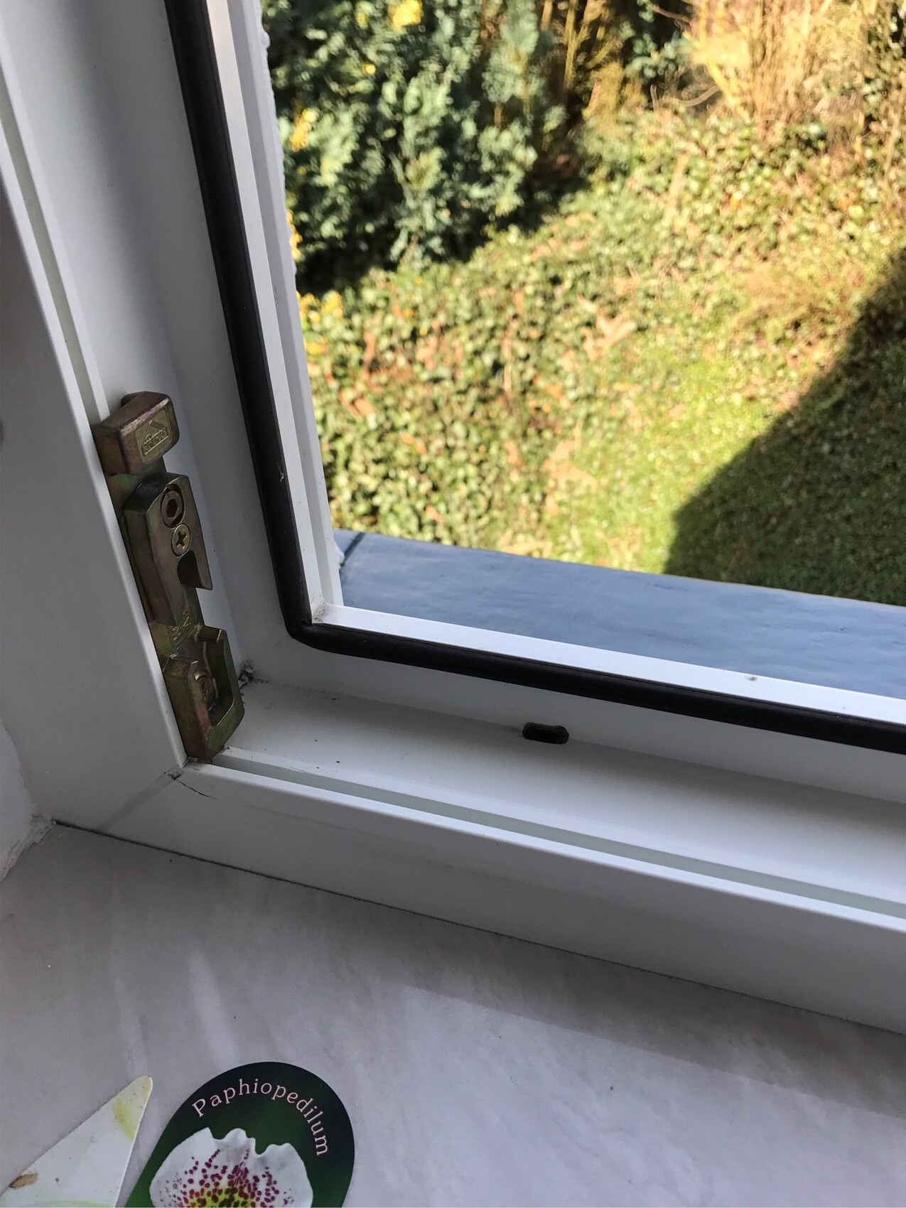

I took photos of the windows in the house. They also have locks installed. The windows are 23 years old and are located on the ground floor.
The question is whether these locks are sufficient when the window is closed, or if it would be worthwhile to retrofit mushroom head locks.

Door frame with metal door lock, interior with plant in the background

More pictures
Close-up of a white window frame with guide rail and fittings
Close-up of a white door frame with metal fitting and hinge, yellow wall behind.

The windows still appear to be in good condition. Retrofitting mushroom head locks is a manageable effort with significant benefits and is highly recommended on the ground floor (as well as in the basement and on upper floors for windows above garages or canopies).
Caspar2020
27 Mar 2017 08:03
Regarding burglary protection: Without mushroom head locking pins, a burglar does not need 10 seconds to pry open such a window.
