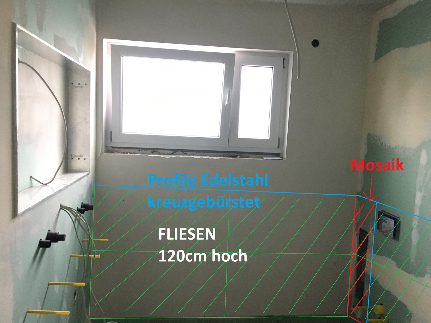

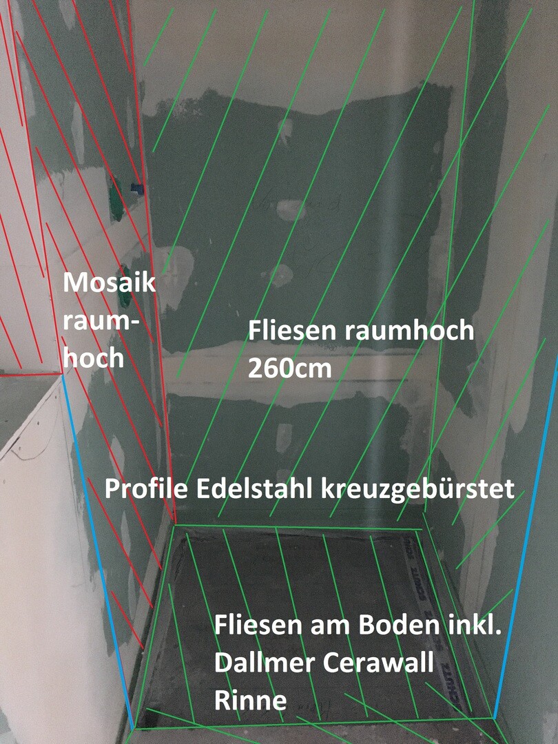

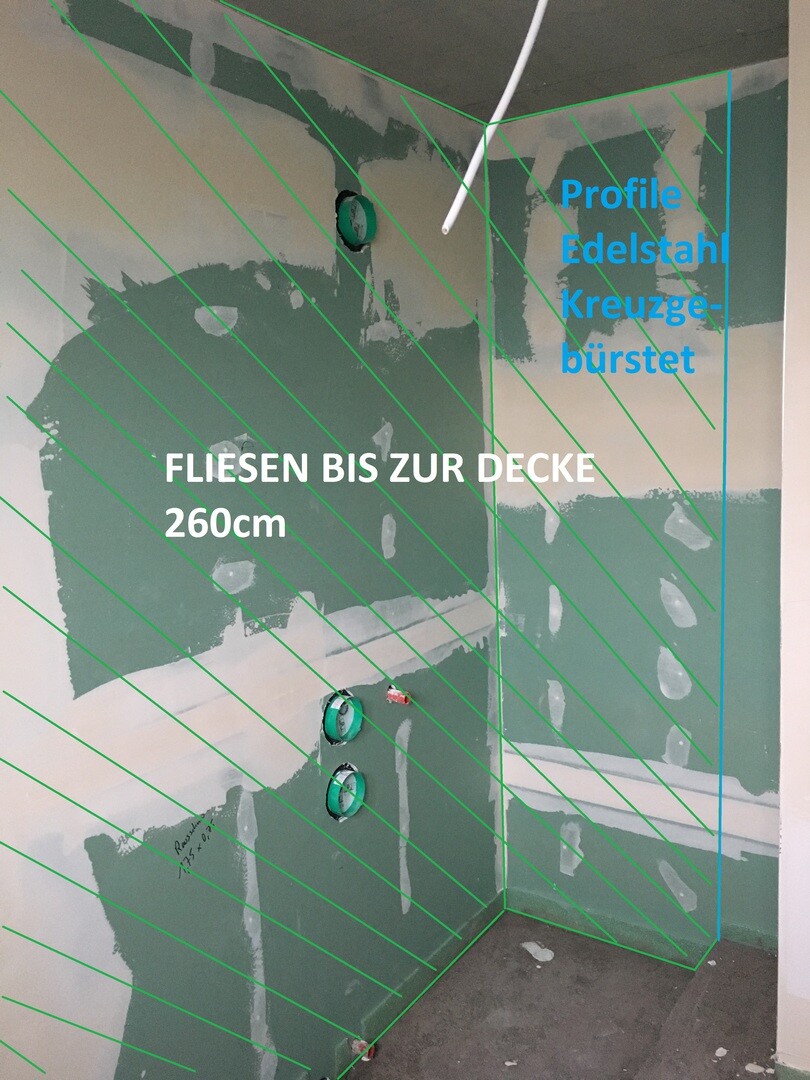

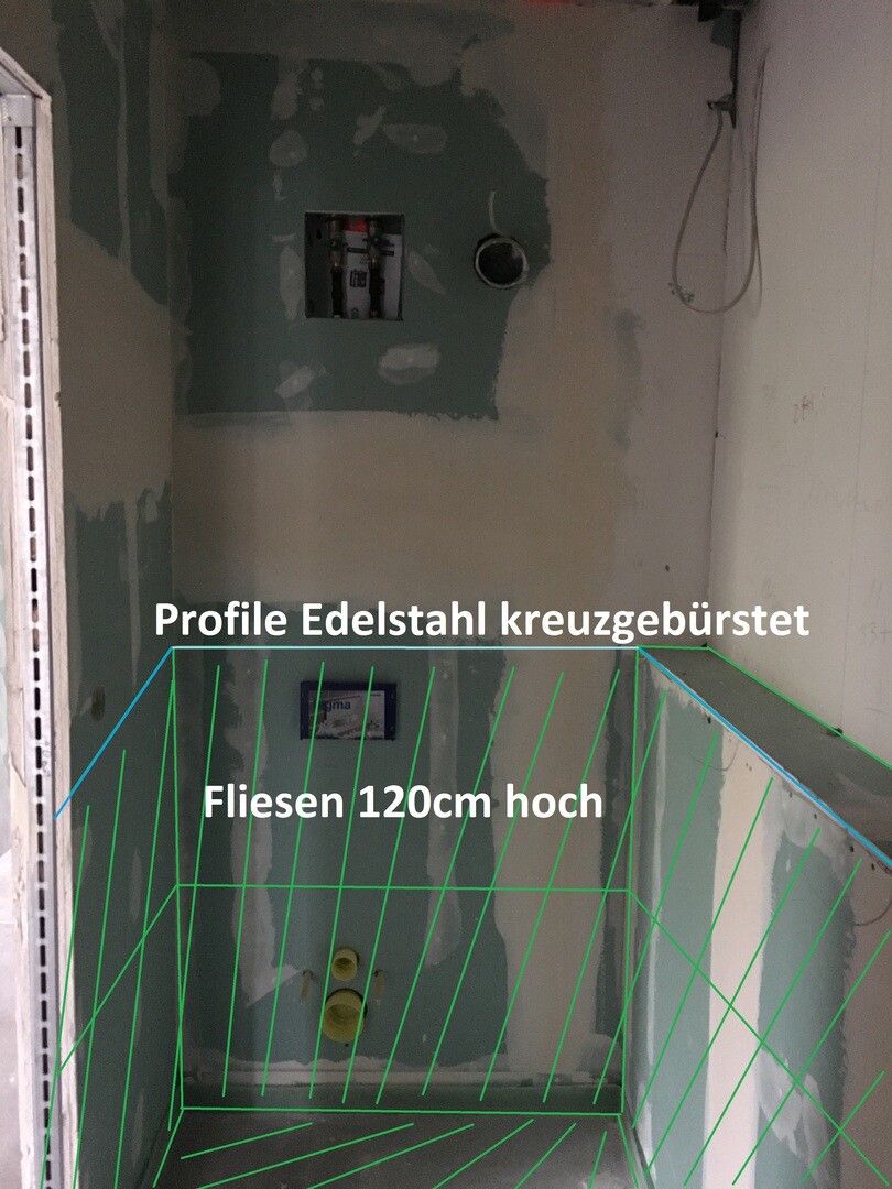

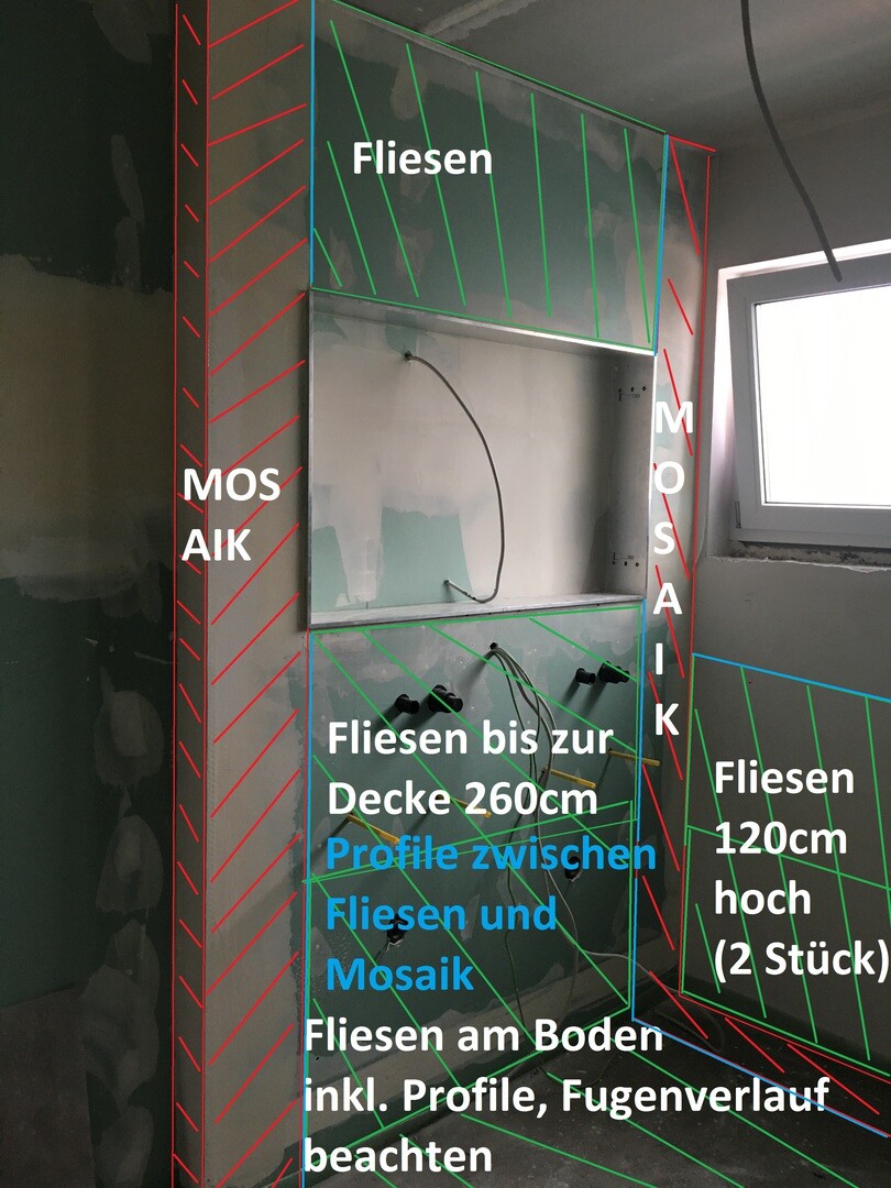

Here are the pictures of the main and guest bathrooms, including the "professional tiling plan."
Working time: 7 to 10 working days. Quotes range between 4,500 and 5,000 EUR (excluding VAT) and include:
Priming walls and floors, waterproofing, building in the bathtub, and, of course, laying the tiles. Except for the tiles and stainless steel profiles, all materials are included, such as adhesive, epoxy resin, etc.
The price seems reasonable to me, considering there is quite a lot of work involved.
The tiles and mosaics are the Maps of Cerim model from the manufacturer Florim.
