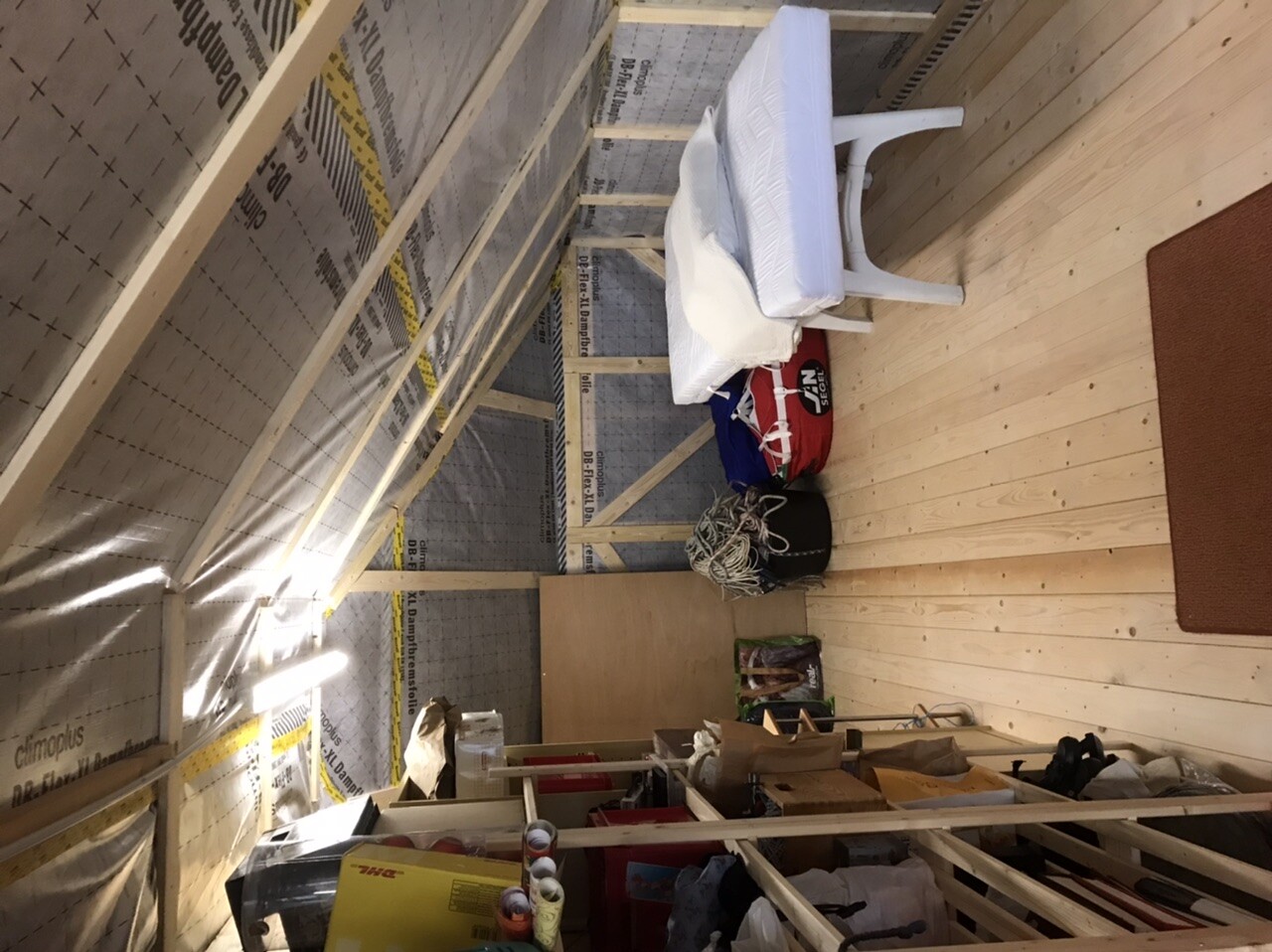

We have an unheated attic, accessible by stairs, insulated with glass wool, featuring a Velux window and a stud frame. It serves as a wonderful basement alternative. Dry, frost-free in winter, and not too hot in summer, making it suitable for storage. Additional cost in 2017 was approximately 15,000 with insulation done as a DIY project.
Hausbauer202126 May 2021 22:06Nordlys schrieb:
We have an unheated attic space, but it is accessible by stairs and insulated with glass wool, including a Velux window and a stud frame. It serves as a fantastic basement substitute. Dry, frost-free in winter, and not too hot in summer, so everything can be stored there. Additional cost in 2017 was about 15,000 with insulation done by ourselves.I think that’s great; that’s what I had in mind except we could do without the fixed stairs. So, it’s possible to do without heating after all. Did I understand correctly that the entire roof is insulated or only the ceiling towards the attic?T
T_im_Norden27 May 2021 07:24Nordlys used a construction method with a vapor retarder.
