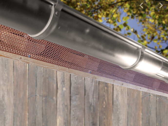

Normally, cold roofs are not covered. If they are, there are stricter requirements to prevent mold and avoid moisture buildup.Exactly. You probably blocked the ventilation grilles, right?H
Heidi196517 May 2021 20:40Where are the ventilation grilles? It was the same company responsible for carpentry, roofing, and interior finishing. They should know what they are doing or should have warned us about the expected issue.

Where are the ventilation grilles? The same company handled the carpentry, roofing, and interior work. They should know what they’re doing or at least have warned us about this expected issue. Around there...
