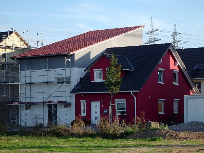

In principle, semi-detached houses do not have to be identical. Here is an extreme example:
The disadvantages of such development are obvious...
