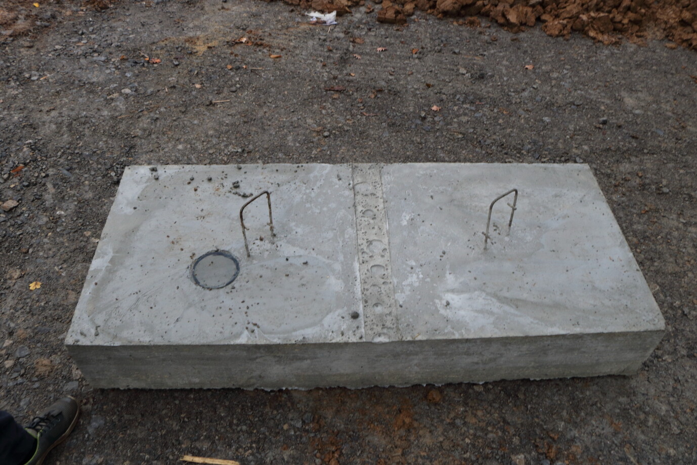

We are getting an air source heat pump. The electrician gave the concrete contractor a drawing so that the latter could build a foundation. He did that as well. According to the drawing, he placed the recess for the supply line in the front left corner. Then the heat pump was delivered and temporarily placed on the foundation; see photo. It stayed there for months. I then asked what would happen with the black component. The boss replied, "That will be inserted into the heat pump." By that point, he really should have realized that this wouldn’t work.

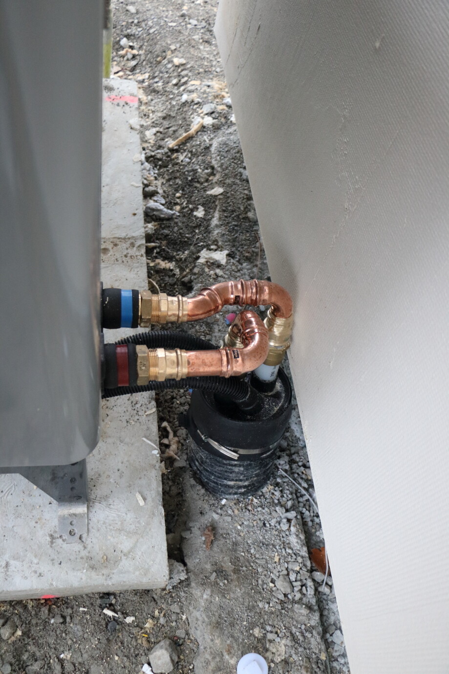

Now the connection was made. And what a surprise: it is not possible to position the heat pump centered on the foundation because the recess is in the wrong place. Then the electrician installed this part; see photo. I am simply appalled and the chief electrician’s reply was: "That was a communication problem. My employee installed the heat pump way too high. It will be lowered further, about 5cm (2 inches) above the concrete. Then a frame will be added around it, filled with gravel, and then it won’t be visible anymore." Am I being too demanding? It’s a miracle they even managed to anchor it so close to the edge. Will that hold in the long run? The concrete contractor is not at fault. He worked according to the electrician’s drawing.
What can I demand now? Ideally, I want them to redo the entire foundation properly. That means the electricians can't do it themselves. They could commission the concrete contractor, but I will not pay for that.
How did you install your heat pumps?

FoxMulder2429 Jun 2021 23:50That looks quite unusual. The screws at the edge of the concrete definitely won’t hold in the long term.
Decoupling the air-to-water heat pump is only really necessary if it is attached to the house (wall mounting or house foundation).
We also installed our air-to-water heat pump on a concrete base, which was a requirement from the manufacturer. However, the drainage is connected within the hole in the foundation. The district heating pipe comes into the air-to-water heat pump from the back. Since this hardly fits properly when positioning the heat pump and the pipe is very stiff, angled pipes like these are used.
