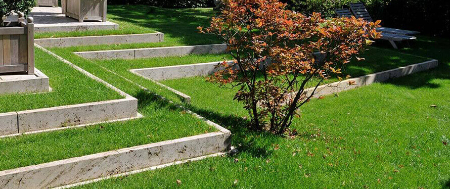

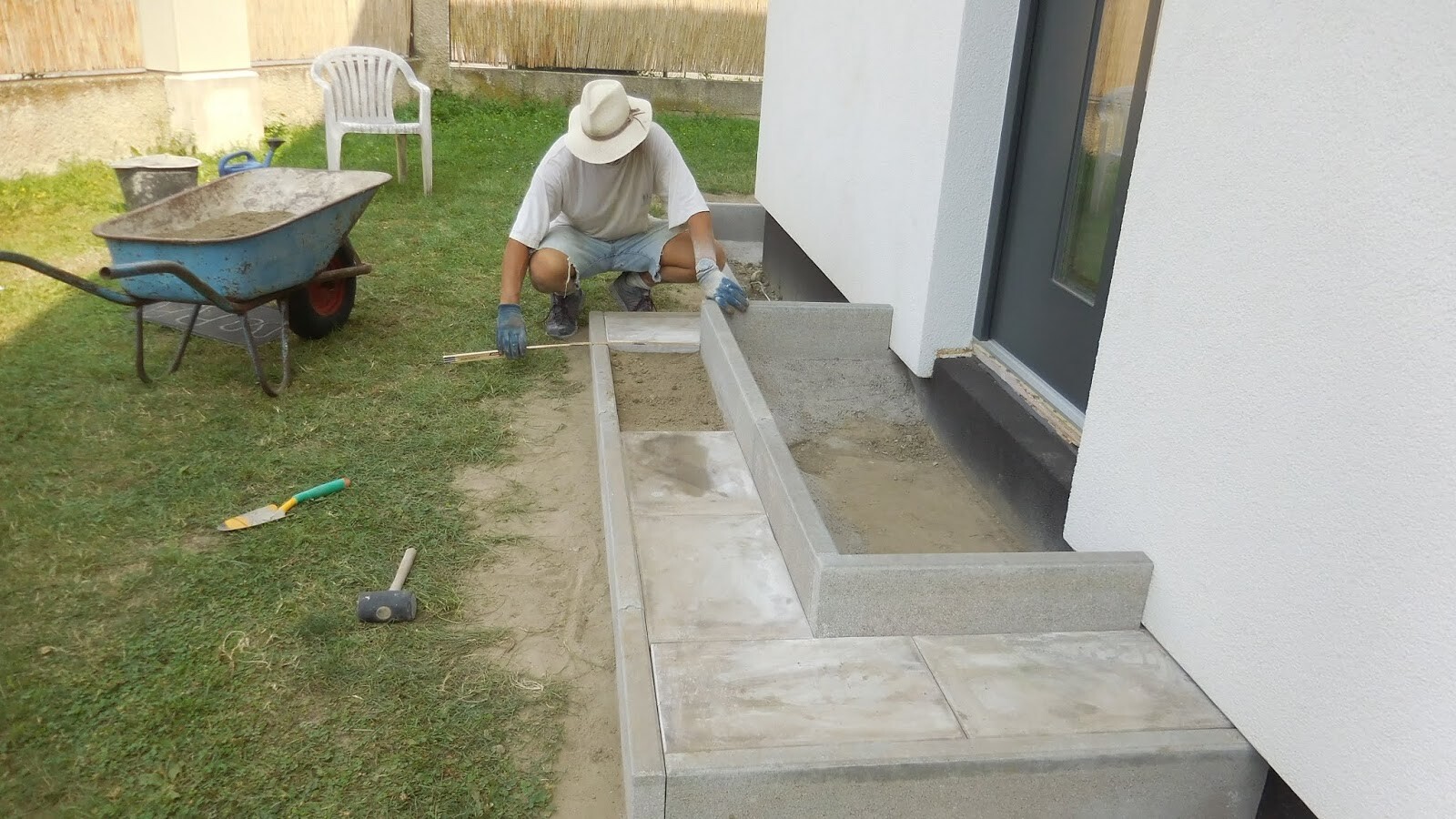

I have seen many pictures where edging stones are used as step borders for patios or garden stairs. The steps there typically stand about 15cm (6 inches) high and are visible from the front. Or for flower beds adjacent to lawns, where the beds are at least 10cm (4 inches) higher than the lawn, and one side of the edging stone is clearly visible.
Is there perhaps a rule of thumb stating that one-third or half of the stone needs to be set in concrete to hold firmly? If I were to use a 40cm (16 inches) stone, would a concrete depth of about 20cm (8 inches) be enough?
