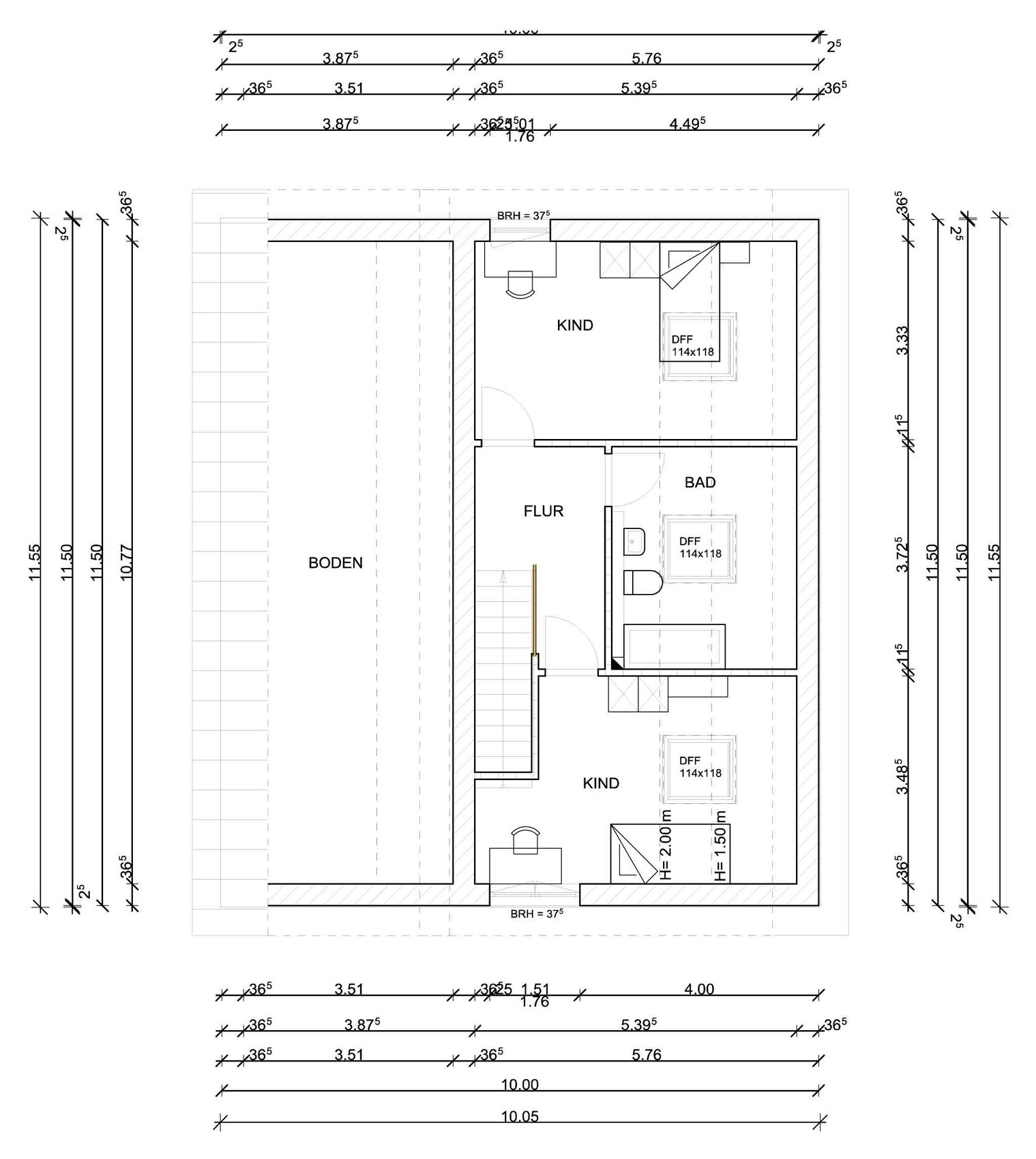

Bauexperte9 Oct 2014 11:57Hello,
Attached you will find the loft plan of a building project we will start soon. There are already two children in the household, and the client is expecting again; so far, five children are planned. For this reason, the design fully explores the limits of the zoning plan. Aside from the fact that you probably won’t need a bathroom in the loft, the design highlights the available storage space with a staggered mono-pitched roof.
Best regards, Bauexperte
