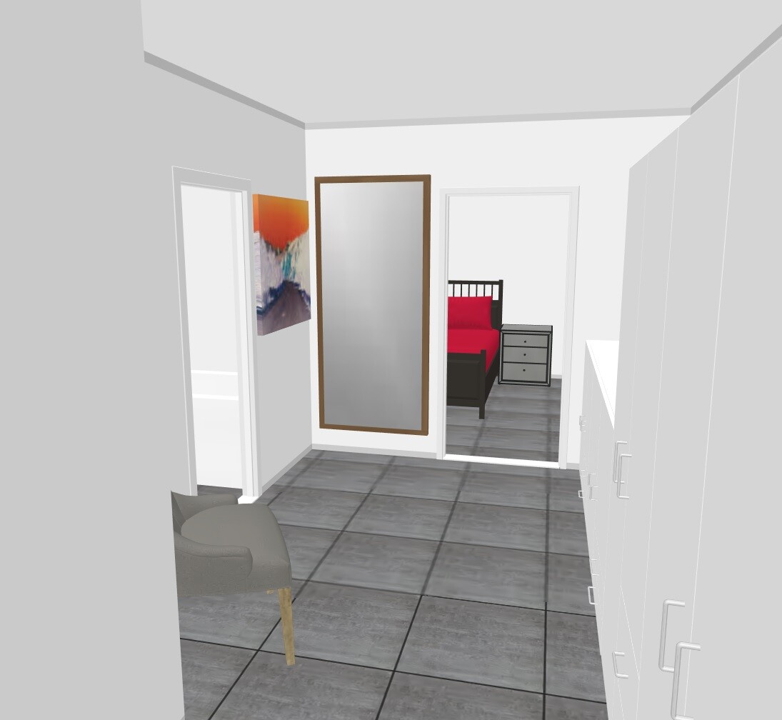

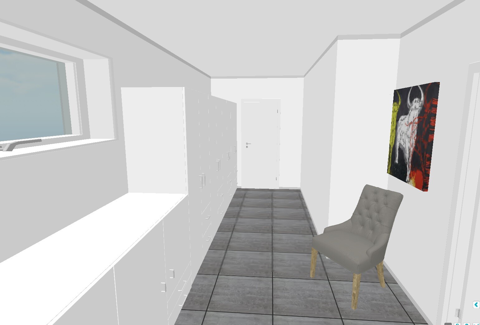

The dressing room layout includes a 4m (13 ft 1 in) wardrobe wall, with space next to it on the left under the window for a 2m (6 ft 7 in) dresser. In the wider area north of the bathroom, there is also room for a mirror and a chair. As @kbt09 correctly pointed out, there is also space for shallower cabinets behind the door at the bottom of the plan. Attached is a picture showing how we imagine it.

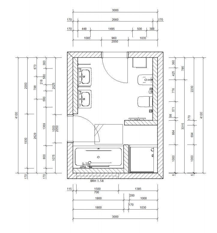

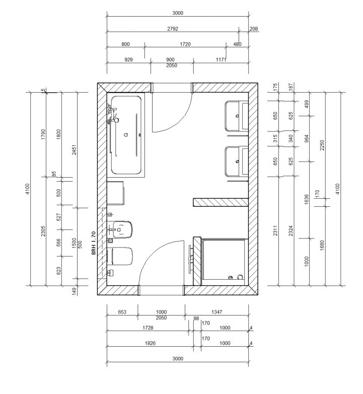

We are still quite unsure about the master bathroom; my wife wants a special solution, while I would simply arrange the fixtures along the left and right walls. The window in the bathroom would be a sort of clerestory window, but that is not yet fixed. The door to the south terrace will have frosted glass, which also solves the privacy issue.
Attached are two examples of how we roughly envision it. In one of these, the door would be located on the west wall. Nothing is finalized yet. Besides kitchen planning, this is now our top priority.
I chose the door to the master bathroom too small, but it will be a standard size—thanks! Yes, the issue with the small passageway to the toilet is still puzzling me. Beans are often eaten but are not the problem. We definitely need to address this.

The cloakroom is currently planned to the left of the door to the utility room, where there is space for a 2.40m (7 ft 10 in) wide wardrobe. The door to the storage room under the stairs is also far enough to the right. At the same time, there is the option to install a glass partition between the two windows on the north side to create an entrance vestibule, but that is optional.

This bathroom layout:
definitely appeals to me more. The shower will still need a door. I would have it hinged at the top of the plan and open inward.
However, I would probably leave out the window at the bottom of the plan. It’s hard to clean anyway with the bathtub in front of it. And if it’s absolutely necessary, it should have fixed glazing.
