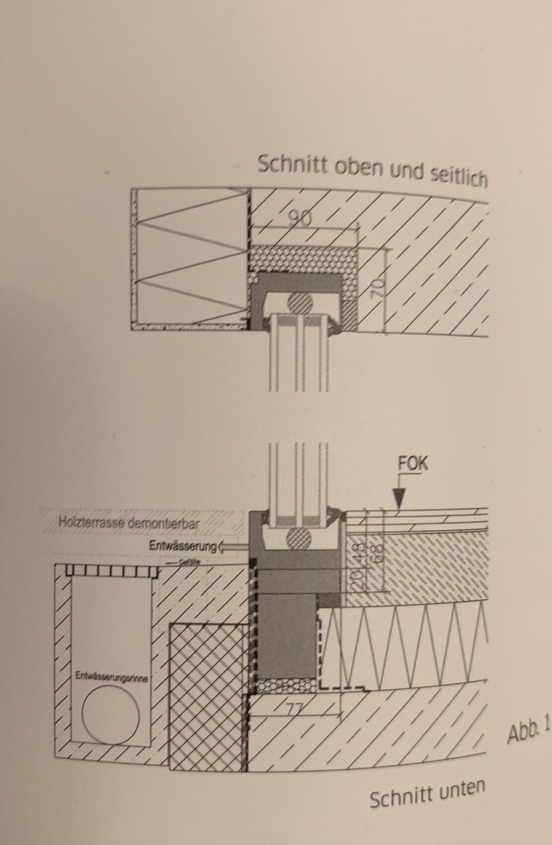

The invisible aluminum frame is hidden here within the screed, side wall recess, and ceiling. I’d be interested to know how that is installed.

@11ant Thank you! How the loft system is installed can be seen in the drawing attached.
