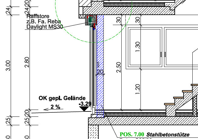

We also have another question that concerns us at the moment: to install external venetian blinds (raffstore) or not.
On the large southeast-facing window front, these can only be realized as cassette-mounted blinds integrated with the window (due to the projecting window seat above, side-mounted blinds are not possible). However, there is no lintel above, so these would essentially be installed directly within the window opening on the window and would probably need to be properly insulated and clad.
We have already received an offer from one company, and we are expecting another one.
From your perspective, does this make sense, or would you rather extend the windows up to the ceiling and use curtains for privacy?
Would you say that the additional cost of 15,000 – 20,000 € from Drutex plastic windows to Josko or Actual aluminum or wood-aluminum windows is also reflected in better quality and durability, or were your comments about lower-quality discount options mainly referring to the wood selection in wood-aluminum?
