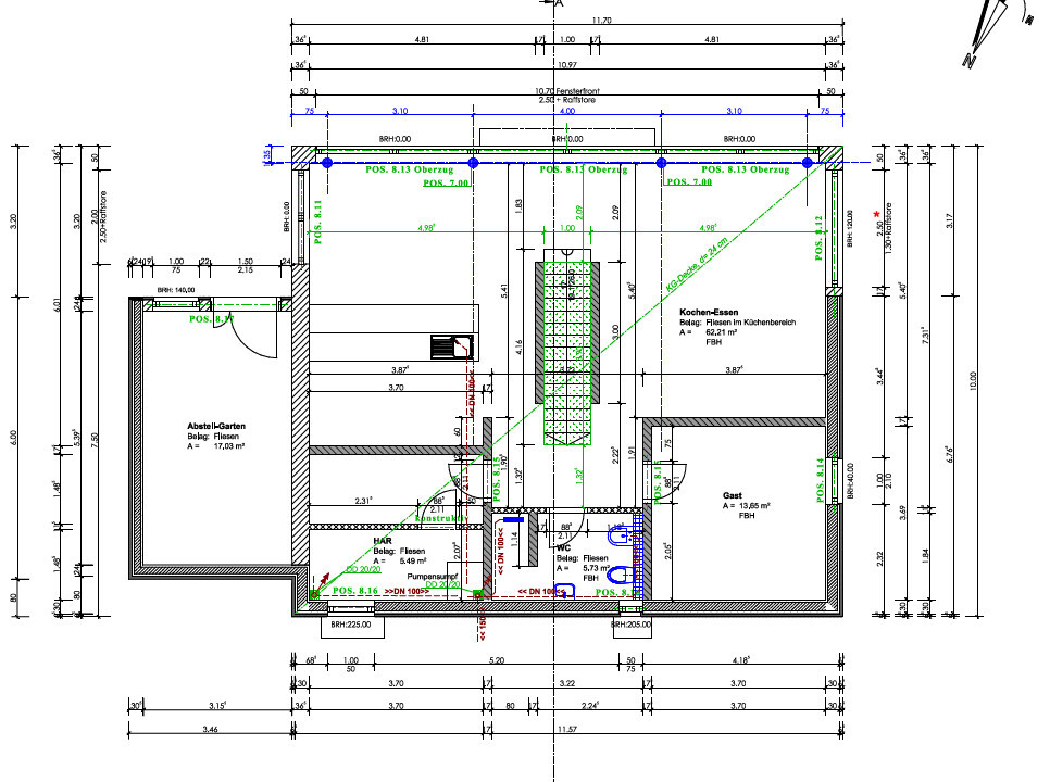

Our single-family house is currently under construction. We previously shared some initial designs here and received very valuable feedback.
We then made a few extra adjustments, revised the plans again, and are now finally building our house on a beautiful hillside plot.
The basement will have direct level access to the terrace – so we have planned the living, cooking, and dining area with a wide southeast-facing window front.
We are now focusing primarily on details such as the choice of window systems, external blinds (raffstore), and so on. At the moment, we are particularly interested in two window systems for which we have already received quotes. Perhaps you have some tips, experiences, or suggestions for us on this and other topics.
For the window front, we have the following options:
- JOSKO ONE system. This is an aluminum window system with an approximate frame visibility width of only 7cm (3 inches). The lift-and-slide door also has a similarly narrow frame, so it does not immediately catch the eye.
- Actual Cubic F Line combined with the "LOFT" all-glass system. Here, practically only the lift-and-slide door is framed with a visible wood-aluminum frame. The fixed windows next to it would be visually frameless and designed as "glass-to-glass joints."
- Drutex Iglu Energy uPVC windows: the most affordable option. However, skylights would have to be installed here because windows are not available in the full 2.80m (9 ft 2 inches) ceiling height.
While the first two options do not have a significant price difference (Actual being the cheaper one), the Drutex solution would be approximately €15,000 (about US $16,000) cheaper overall for all the windows in the house – but also with the least appealing material.
We would be very interested to hear your thoughts on this subject.
Thank you very much, and have a nice evening everyone!

Wow, quite a few changes there – did someone perhaps send their architect packing (or did they retire, and now the junior is in charge)?
Something like this: We collaborated with architects on the design and are only managing the construction ourselves together with the engineering firm.

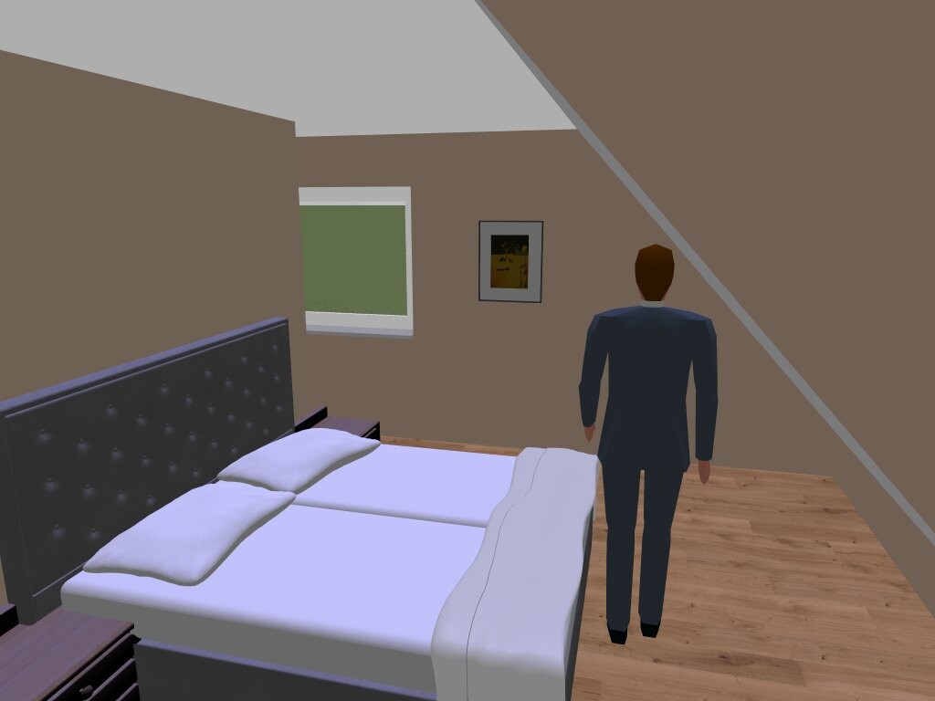

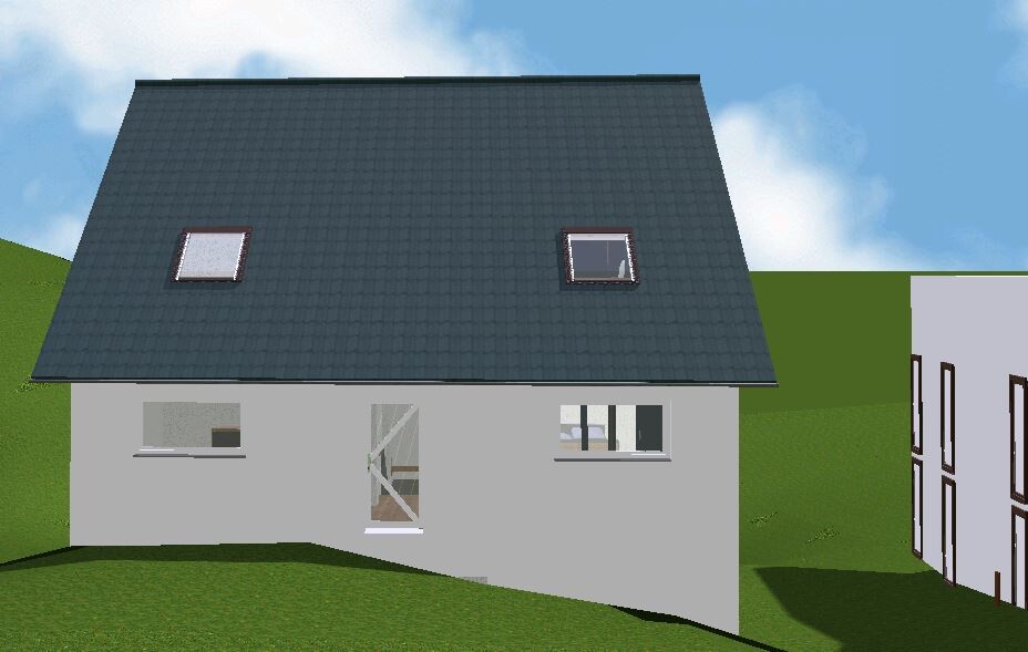

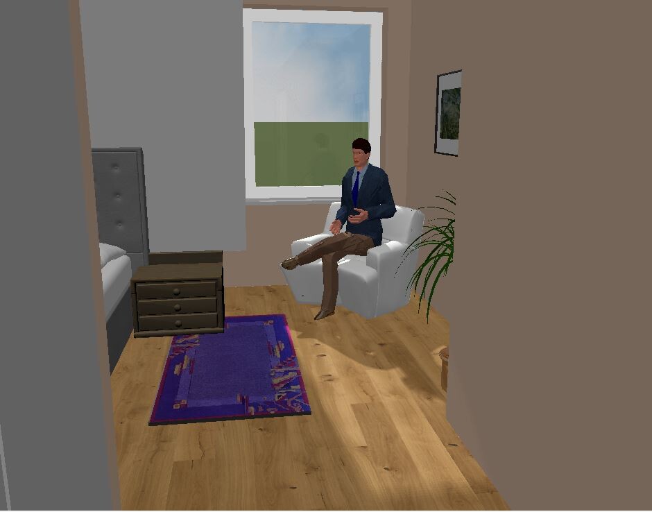

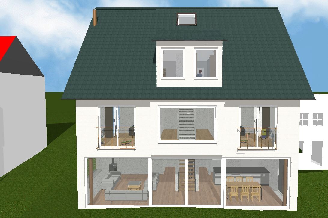

Here are a few 3D views – the color choices (windows, roof, etc.) have not been decided yet, and we would also be interested in your opinions on this.
