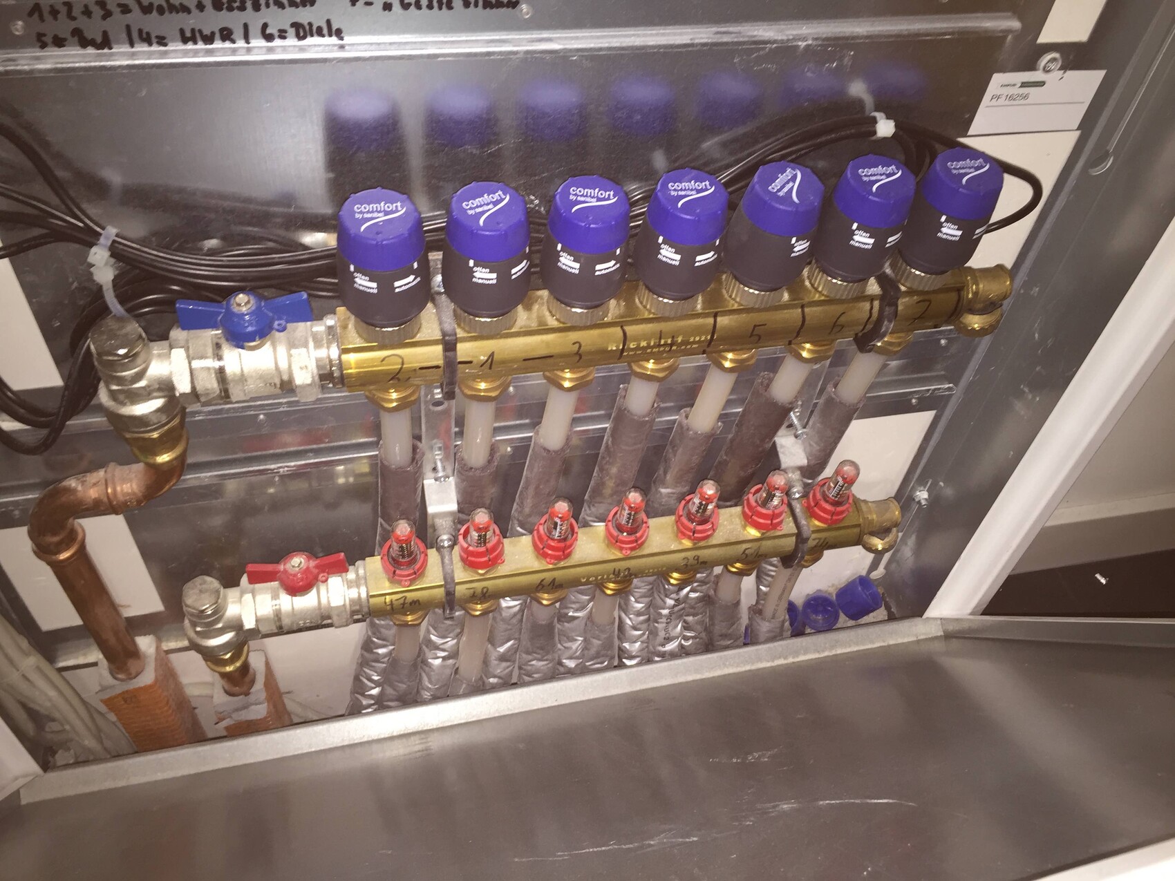

Knallkörper31 Oct 2017 14:29Joedreck schrieb:
Can you see the flow at the manifold after all...?Yes, the original poster should check that. The flow rate must drop to zero when the room thermostat is turned off, or at least to a minimum when the room temperature is around 22 or 23°C (72°F to 73°F) (you can hear a quiet click when turning the dial indicating the control threshold is passed).
If this does not happen, there is likely an electrical issue, and the supply temperature is irrelevant at this point. The heating system cannot be properly adjusted if not all heating circuits can be operated correctly. So it is essential to open the manifold and test each room thermostat actuator one by one.
Great, I think that’s it.
All (13!!!!) electronic controllers were set to "open."
I switched them all to automatic mode and set 1-2 thermostats to maximum; I heard the clicking and then saw (with a delay) the flow.
Here are photos of the two control units, now all without flow; red ring "top":
I will proceed as Joe described. After adjusting the design temperature from 47°C (117°F) to 35°C (95°F), I’ll wait for a cool, shady day (0°C (32°F)) and observe how the temperature stabilizes with the controllers fully open (wait time, control cycle 24 hours), then possibly increase the design temperature moderately.
