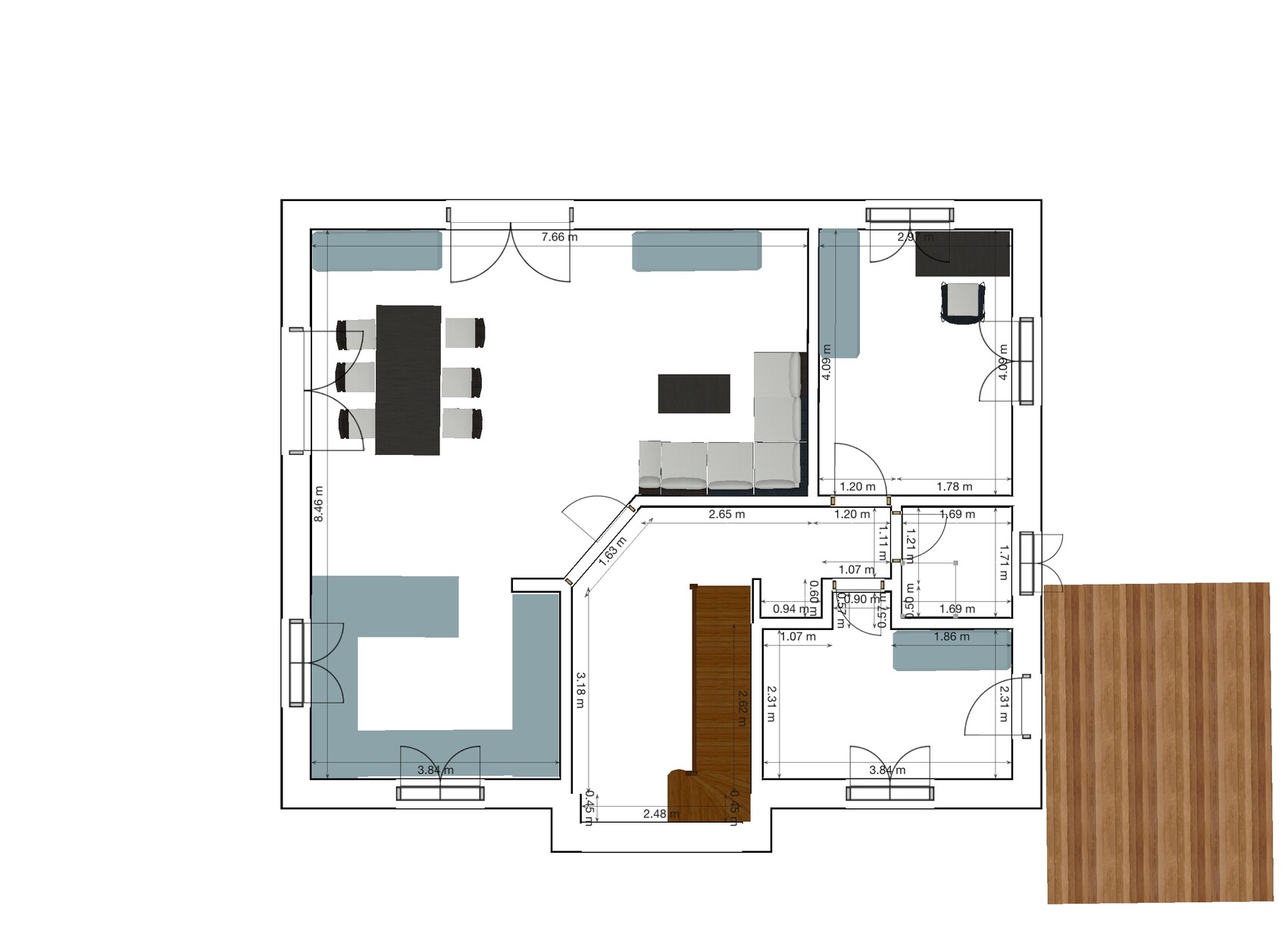

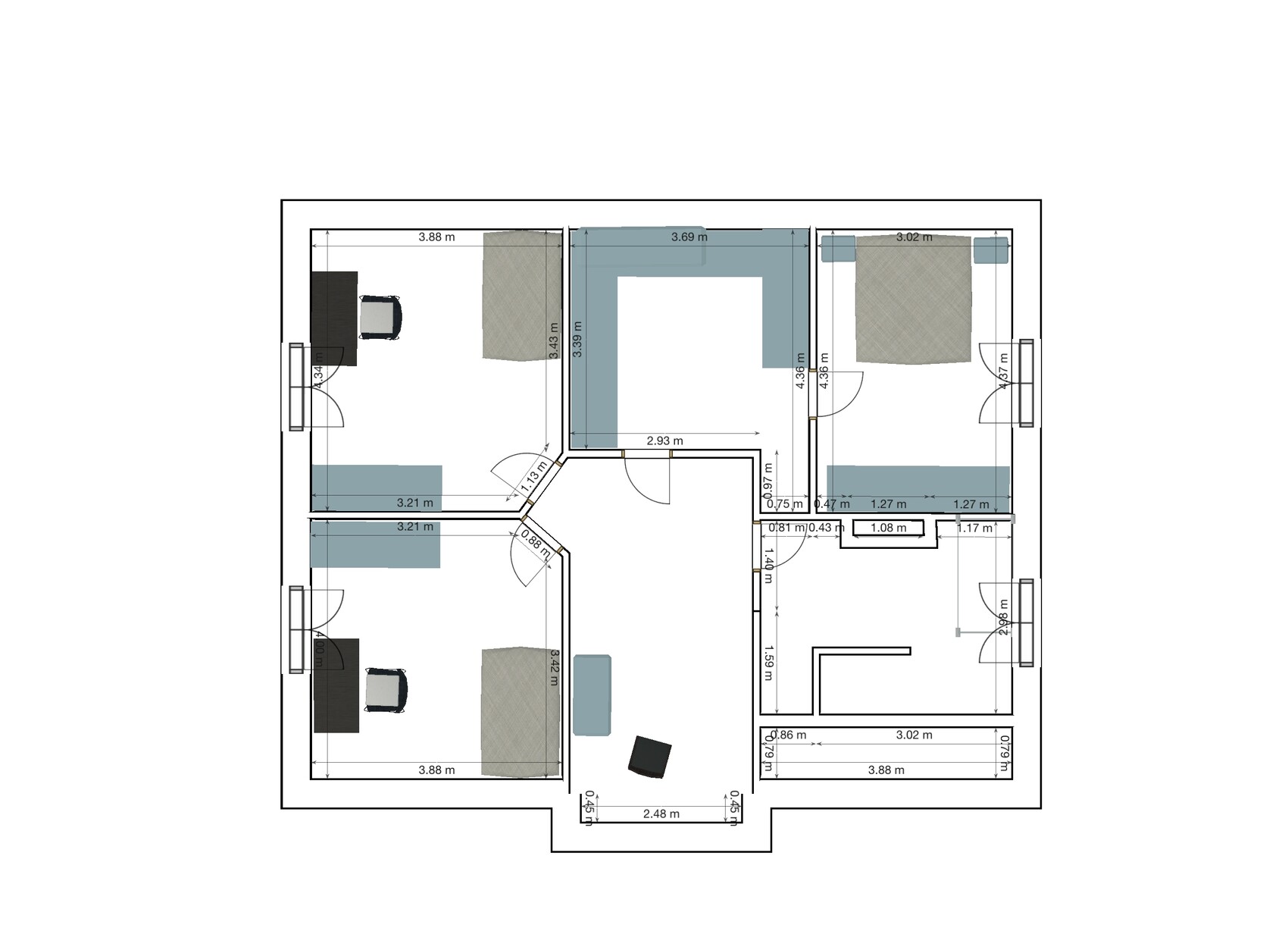

So, we have now planned the furniture in the rooms. Unfortunately, the tool does not carry over the room names into the drawing. However, I hope it is clear which room is which.
Basement floor:
Upper floor:

The middle room on the upper floor is intended to be a walk-in closet. It is so large to allow for extra storage space for items that cannot be accommodated elsewhere on the upper floor. To the right is the bedroom.
Basement floor:
Upper floor:

The 2m (6 ft 7 in) roof line is missing, so the bathroom cannot be properly assessed. The shower might still be in the sloped ceiling area.
What is the purpose of a 302 cm (10 ft) wide bedroom? And what about that gap in the walk-in closet?
Kitchen... peninsula - wall, passageway too narrow.
All doors have a maximum construction width of 80 cm (31.5 inches), resulting in a passage width of approximately 76 cm (30 inches).
