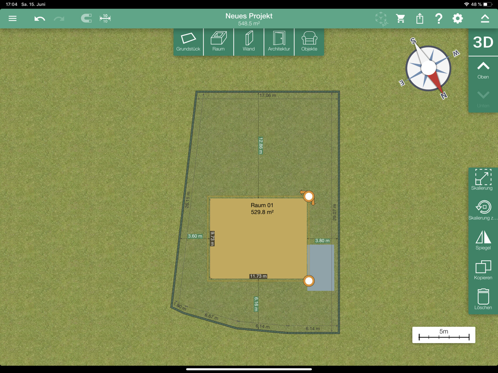

We are planning to build a Frisian-style house (9.7m x 11.7m (32ft x 38ft)). We have finally found a plot that might work. However, we are unsure if the house might be too large for the plot.
Plot layout with brown Area 01 (529.8 m2) on grass, dimension lines visible.

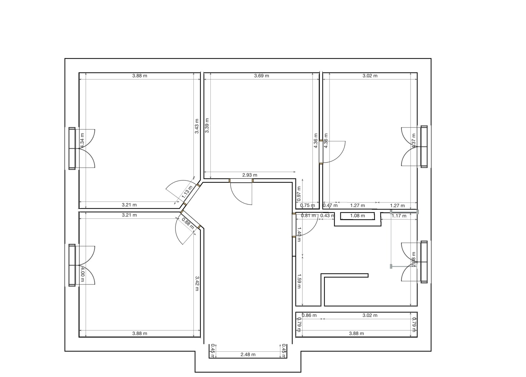

Floor plan of a building with multiple rooms, doors, and dimensions.

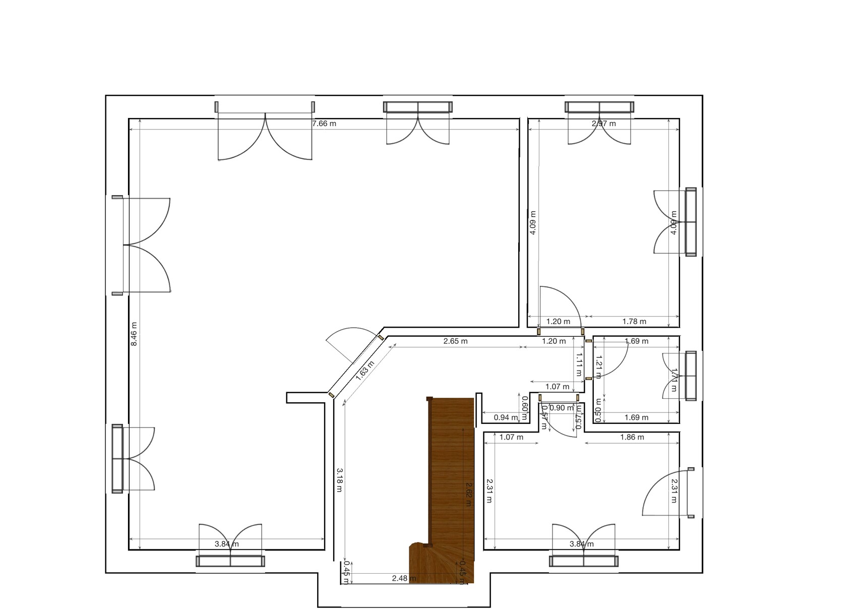

Interior floor plan with doors, dimensions, and brown furniture piece in the center.
Who designed the plan:
- We designed the floor plan ourselves, but it has been "approved" by the builder and Barbar.
What do you particularly like? Why? We absolutely want to build a gallery and create a cozy reading nook there.
What don't you like? Why? We are not fond of a townhouse style. We prefer having a pitched roof.
Price estimate according to architect/planner: 250,000€
Personal price limit for the house, including fittings: 270,000€
Preferred heating technology: only district heating available in this development, otherwise we would have chosen gas.
What do you think of the floor plan? Do you have any suggestions for improvement?
Does the placement of the house on the plot work as is, or is there potential for improvement?
The small box next to the house is meant to be the carport. Unfortunately, the original double carport is not allowed here...

Edit: If you shift the house further to the right so that you stay close to the 3m (10 feet) boundary line, you gain space on the left side. Since the plot slopes slightly, there might be room for a double carport. The floor plan would then have to be adjusted accordingly.

The house fits on the plot. Whether it bothers you to have a single carport instead of a double carport is something you need to decide.
There is not much to say about the floor plan. Please complete the questionnaire and label the rooms. The 2-meter (6.6 feet) line on the upper floor is missing.
Draw the existing and desired furniture to scale in all rooms.
