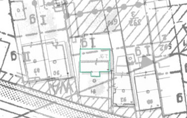

Building regulations:
I am allowed to build quite far into the plot.
On the sides facing neighbors, I must either keep a 3 m (10 ft) setback (then windows are allowed, but the house will be narrow) or build fire protection walls without windows. With fire protection walls, the distance to neighbors can be more flexible. Actually, building up to the property line is required, but there are many “alley” access paths to the gardens, which I could use. And I would like to have such a path.
The existing building is shown in turquoise here.

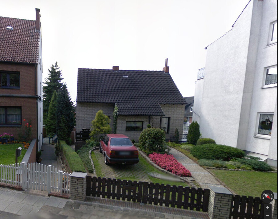

The "house to be demolished" is set very far back, leaving a large front garden. The neighbor on the right side has installed a vertical row of windows at the level of my front garden. Possibly not legal, but I don’t want to confront him and would prefer to find a solution that also satisfies him to some extent. So ideally, I don’t want to block his windows.

Here is my attempt to position a bungalow with a side entrance on the building regulation plan. The entrance is placed further inside so windows can still be positioned on the side. (At least that’s what I thought.)

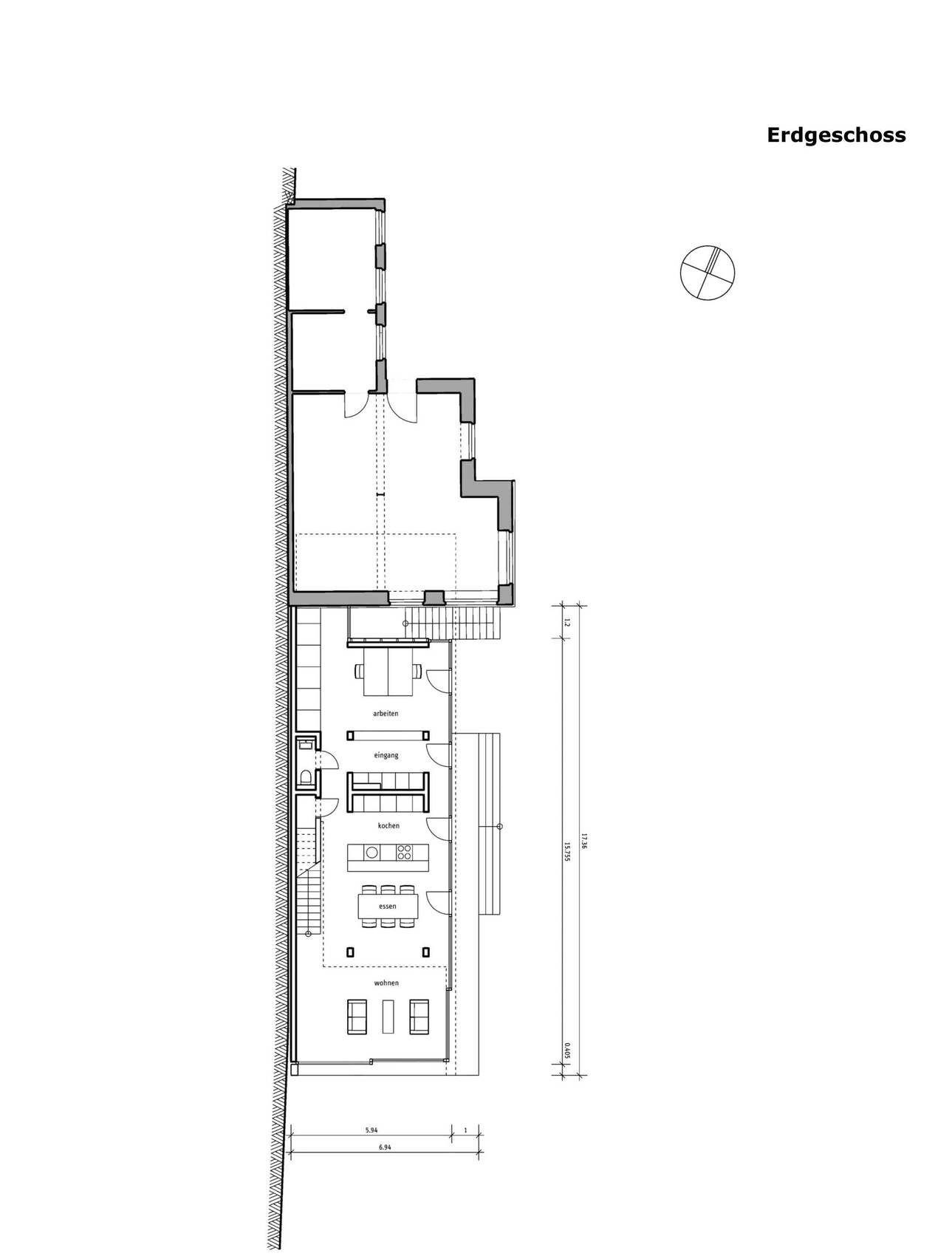

I think you should quickly let go of the fixed idea of building a bungalow on your plot. You won’t be able to implement it practically, even with the most creative architect. Besides, a bungalow would simply get lost among the existing buildings in this area. I rather see a variant of a long house with a basement on your plot; however, you will need to increase your budget for that – which, in my opinion, you would have to do anyway, since bungalows aren’t inexpensive.
Why a basement: You bought a sloped plot; bringing in fill soil will almost certainly cost about the same as building a basement, and I don’t know anything yet about the soil conditions.
Why a long house: the plot allows it, and it's much easier to plan than a design where the lighting has to be “patched together” due to restrictions.
I’m also quite sure that the neighbor to the right (standing in front of the plot) didn’t install blacked-out windows. A three-family house usually requires a formal building permit / planning permission, and its execution is closely monitored by the building authority.
Suggestion: consider a long house; accessibility can also be achieved with a reasonably wide staircase. Living space (with a view of the garden – why would you leave this highlight unused?), kitchen, and utility room in the basement; bedrooms and bathroom on the ground floor. We once planned something similar for a self-employed beautician; unfortunately, I can’t find those designs right now. But I have at least something in my archive to help illustrate what I mean.
Please disregard the rear extension and the back staircase. Imagine the floor plan rotated – work space in the front (which I would designate as a utility/laundry room) and living areas in the back. The width limited to 6.94 m (23 feet) even allows for a light well in front of the guest WC and kitchen, which is no problem at the rear anyway. Then you can have bedrooms and bathroom on the ground floor with separate access downstairs via the staircase. A good architect – and there are certainly plenty in Bremen – will show you many other possibilities. Your plot is not easy, but it is definitely a challenge to plan it so it doesn’t get lost between two- and three-story buildings.
Regards, Bauexperte

I see the situation with the neighbor’s windows similarly – they are not randomly placed in the recessed part of the building. The likelihood of an illegal construction here is very low.
Of course, you could check by contacting the local building authority. Your legitimate interest in reviewing the building permits of both neighbors is established by owning the property. On the other hand, this might not be necessary since you will need an architect to submit your own building application, who should also roughly review the neighboring developments and base the new construction plan on that.

@Bauexperte @ypg and @Dirk Grafe Thank you for the feedback!
I can understand everything: the bungalow gets lost among the other houses, I want to respect the neighbors’ windows anyway, and I also think it’s a pity to skip the basement.
Maybe a half-basement would do...
It’s also unfortunate to give up the upper floor and the beautiful Weser view. But you can’t have everything...
A longhouse is a nice idea. I will meet an architect in mid-November and suggest it to her.
