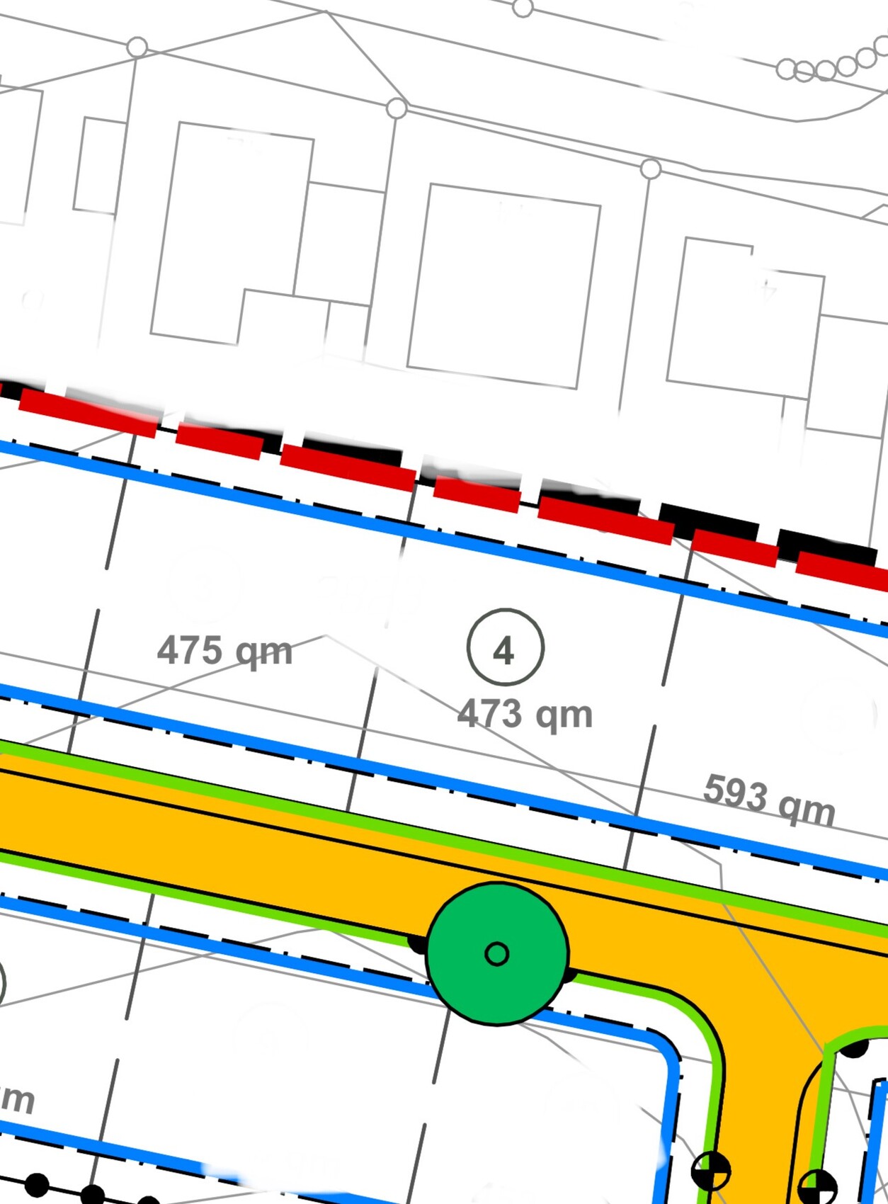

We have the opportunity to purchase a 473 sqm (about 5,090 sq ft) plot in a new development area. Currently, we own a 120 sqm (about 1,290 sq ft) house from 2014 with two children’s rooms and a basement, and we have recently had another child.
Unfortunately, there are no larger plots available here at the moment. I am currently wondering whether a house like the one we envision can be reasonably planned on this site.
Site coverage ratio 0.38, floor area ratio 0.8, max building height 10.5 m (34 ft), max eaves height 5.5 m (18 ft). Three parking spaces need to be provided. Gable and hip roofs with slopes between 22 and 48 degrees. The plot is level with a south-facing street side.
The plan is for approximately 160 sqm (about 1,720 sq ft) of living space, including three children’s rooms, a home office, a main bathroom with a bathtub, plus a toilet with a shower on the ground floor. A garage is currently included in the plans, provided everything reasonably fits on the plot and we still have some garden space left. Basement construction is not yet decided—currently, we have a basement. Possibly an attic could be an alternative? I am uncertain about the maximum height allowances and whether this would even be feasible with two full storeys.
At the moment, our floor plan is similar to a Flair 113 with a basement. What bothers us is the extremely small toilet on the ground floor and the lack of a room on the upper floor.
I would first appreciate some general advice to help develop this idea.
