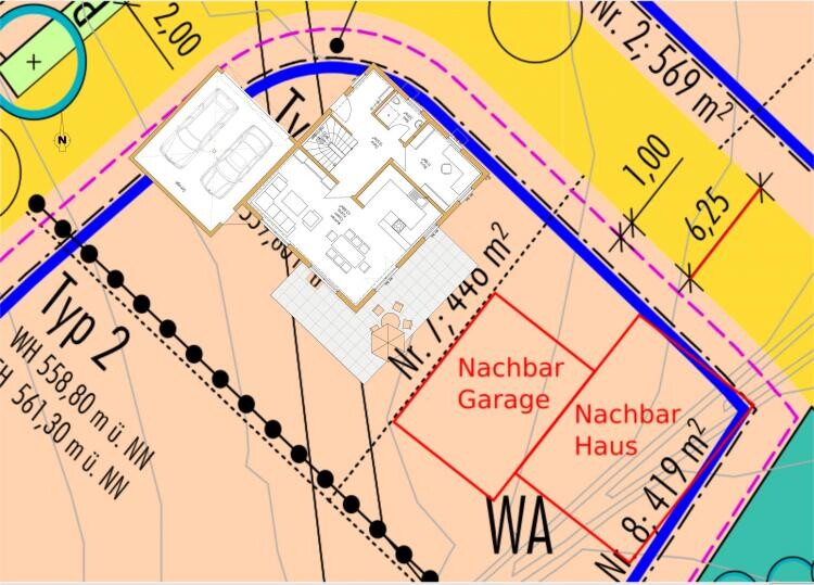

I am currently planning a single-family house with a double garage on a small 448m² (5400 sq ft) plot. I would appreciate any tips and suggestions regarding the placement of the house and the double garage.
- House approximately 10 x 8.5 meters (33 x 28 feet), although the exterior dimensions may still change
- Double garage 7 x 7 meters (23 x 23 feet)
- No slope, or about 0.5 meters (1.6 feet) gradient from west to east
- 2 full floors
- Gable roof
- Basement with light wells desired
- The plans of the southern neighbor are included in the drawings. Those of the western neighbor do not yet exist.
It is plot number 7. Files 01 and 02 show my current rough placement ideas.
The other files (03) show the plot without the house or garage placed. I can also provide an SVG file in which the house and garage can be easily moved. I am still quite unsure about the placement and would really appreciate any suggestions. Thanks in advance.

Because it looks somehow "odd" when the gable is on the short side.No, the short side of the house faces southwest... and that’s where the gable is.

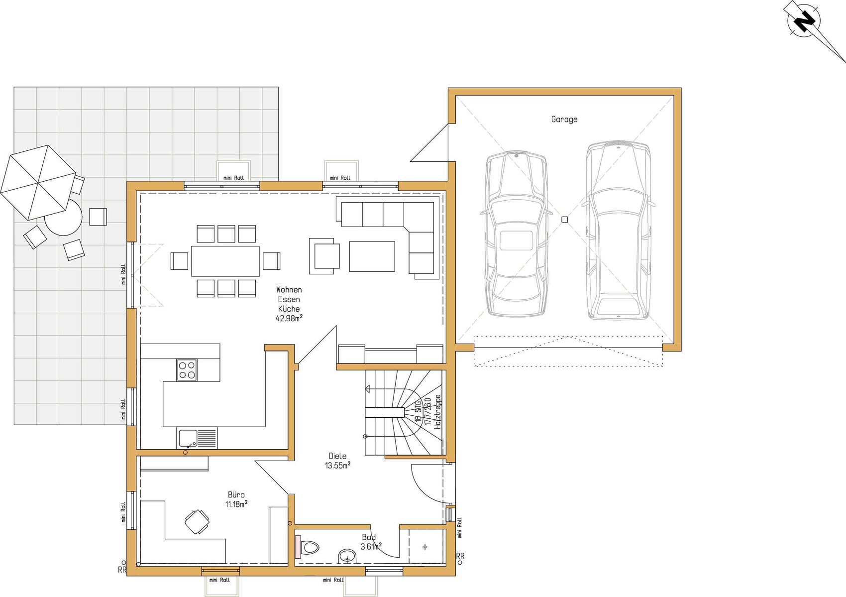

World-e schrieb:
There will be 2 full floors anyway, so double casement windows are not planned.Two full floors? Precisely in that case, I would design the ground floor and first floor in one seamless volume, because a box shape without projections to the front or rear looks very unappealing and hardly resembles a “house.”
Cuboid without recesses or projections What do you mean by that?
Then it is just like the floor plan from my architect. Except the stairs are moved to enlarge the living area, and the garage is shifted to the back.
The gable side will face the southwest garden, and the street will be to the northeast. The eaves sides will be the garage and the neighbor’s garage.
Because I understood that the house will be rotated.
Kisska86 schrieb:
Move the stairs to the right and make the living area widerIs this roughly what you meant with the two different bathroom layouts? The garage remains unchanged.
