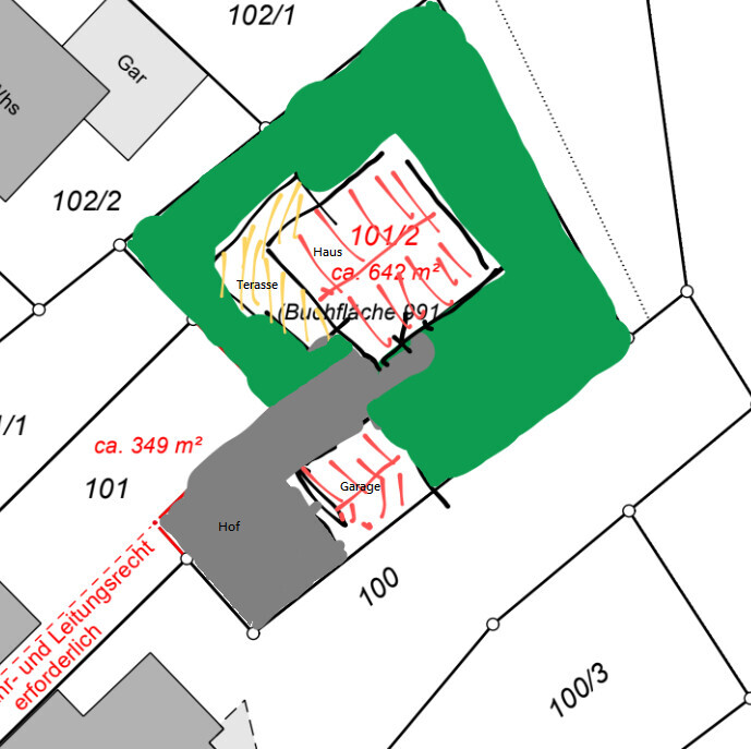

We are still at the very beginning of the planning process but want to approach it as concretely as possible from the start. We are particularly interested in ideas and suggestions for the optimal placement of the house and garage on the plot. This is the main reason for my post. I have made a very rough sketch of how I currently imagine it, and I would appreciate your feedback on whether this makes sense.
Ideally, the terrace should face south and west. However, I am unsure about the best placement for the front door so that it is not directly next to the terrace (which is usually not common, right?). Overall, I would like to have as much sunny area as possible.

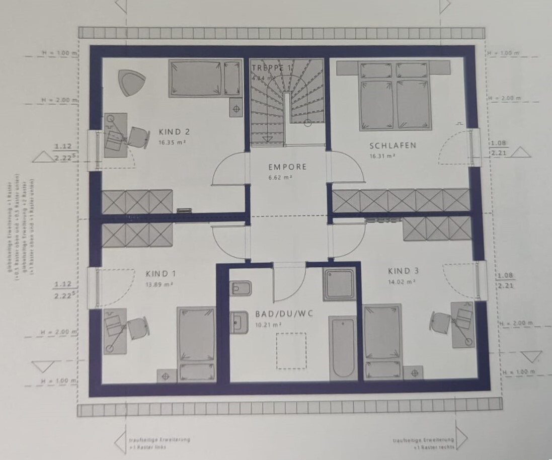

I have attached a standard floor plan that we like in terms of layout. We want as large a living-dining area as possible on the ground floor; the additional room can be quite small. In your opinion, would this floor plan be suitable for the plot?

Rough sketch, initial ideas (please excuse the lack of professionalism):
Ground floor plan:
Upper floor plan:

One disadvantage of the plot is that it is located in the second row. That also has advantages, especially for your garden orientation: you don’t have to worry about separating pedestrians with a front yard and depth.
slonnols schrieb:
is not common, right?). About 25% have this north-south orientation. Streets are developed on both sides.

slonnols schrieb:
current standard floor plan of a prefab house manufacturer I hope it’s a standard model from this manufacturer?
slonnols schrieb:
I have attached a standard floor plan that we like structurally. These can be modified: technical rooms should be near the utility connections. In this case, swap the floor plan, i.e., switch the utility room and the office, and modify the entrance.
But: it’s not very spacious. If you look at the sofa wall, it’s very... short...
