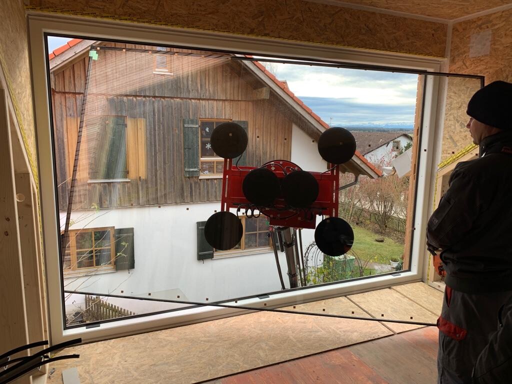

Yes, that is really a pity. We thought for a long time about whether we still wanted the window. Having an unobstructed view would, of course, be great, but it’s unlikely to find a lot where you get such a view. So you have to live with the conditions...Here in our rather plain northern region, this house is a real eye-catcher, and that’s the reason for choosing this window—to create a holiday atmosphere.
