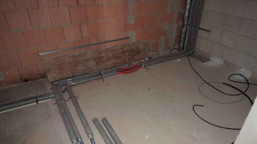

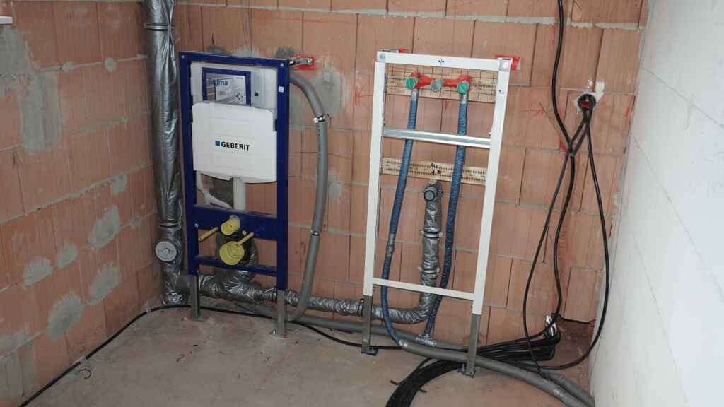

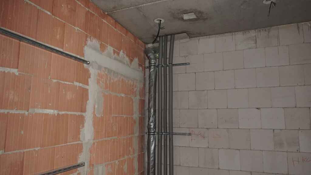

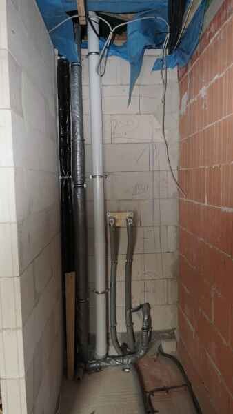

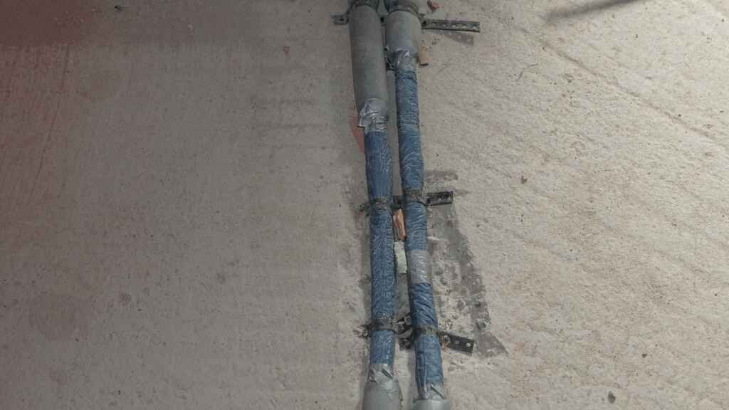

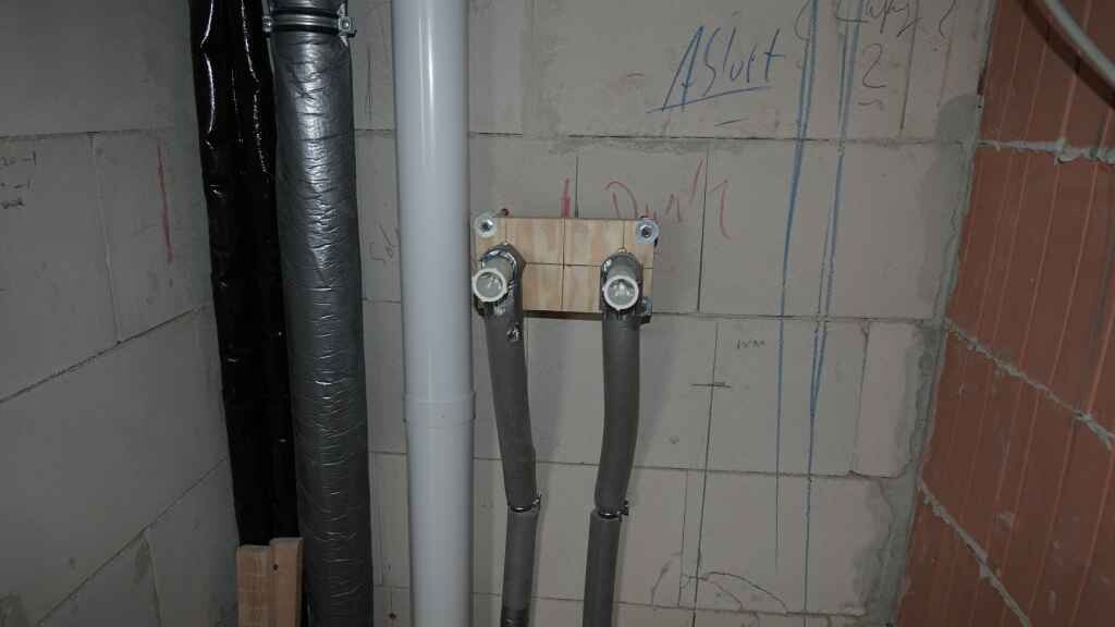

and the second:
Basement with visible pipes, cables, and shell construction walls.
Several pipes lying on the construction site floor, installation lines in the shell construction.
Interior construction site with raw brick wall, vertical pipes, and installations.
Geberit flush tank wall frame with piping in the shell construction.
Insulated pipe/ventilation pipe with insulation on a basement wall, installation area visible
Concrete wall in the basement with installed pipework on the ceiling
Basement floor with rough installations: water pipes and cable ducts visible.
Narrow installation space with sanitary and building services pipes on a wall
Concealed water pipes and sanitary pipes in shell construction fixed to wall supports
PVC pipes and sanitary installation in the bathroom during construction work

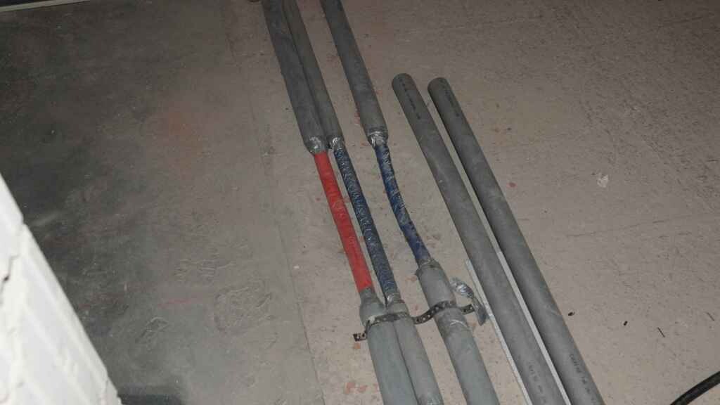

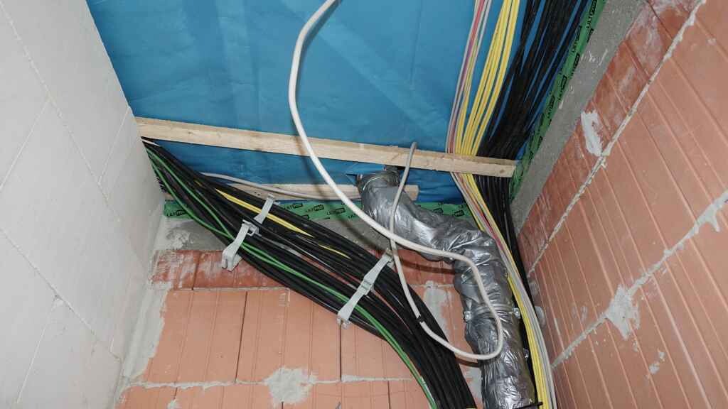

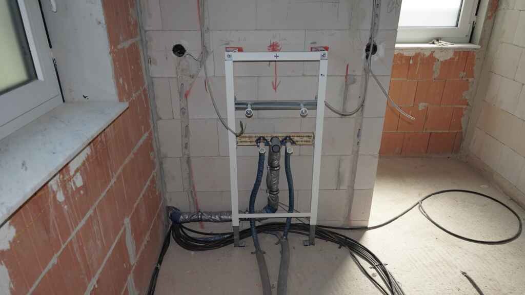

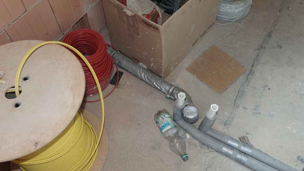

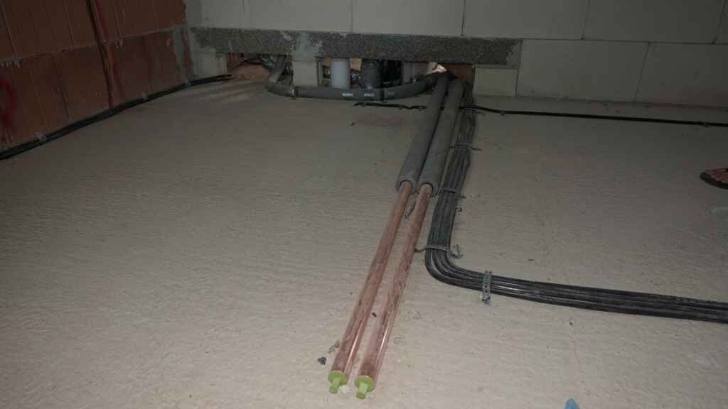

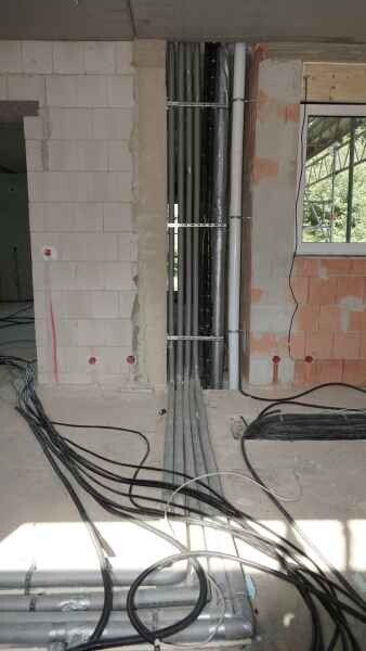

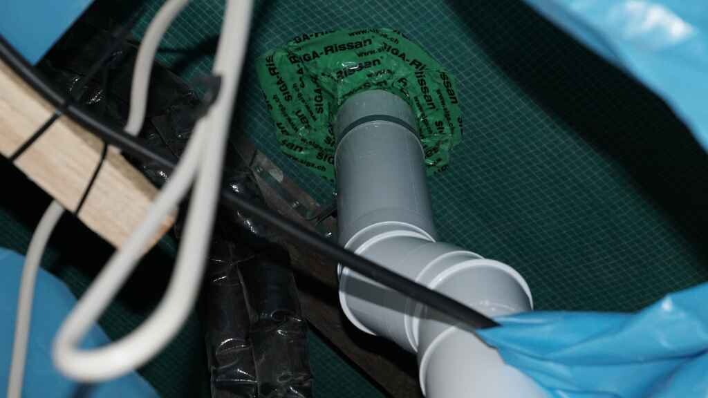

and the third:
Geberit flush tank behind wall frame; cables and pipes visible in construction zone.
Bundles of cables and pipes on construction site; black, green, and yellow cables beside blue protective sheeting
Bathroom in shell construction: metal frame, water pipes, unfinished wall tiles.
Installed metal and plastic water pipes on raw concrete floor during construction phase
Laid cables and metal pipes at construction site, hallway with running cables
Unfinished construction site: cable bundles and pipes inside an open wall cavity.
Construction area: yellow and red cable reels, pipes, and fittings on the floor.

R.Hotzenplotz schrieb:
and the third one:
Have you asked the electrician about the empty conduits for media cables?
R
R.Hotzenplotz
20 Jun 2018 22:01
Yes, he didn’t understand the question, and I wasn’t sure how to phrase it more precisely. However, he knows that an electrical inspector specializing in this area will officially approve everything. So he must be aware that everything has to be done properly and according to standards.
X
xray107
20 Jun 2018 22:33
Yes, he couldn’t make sense of the question and I didn’t know how to phrase it more precisely. However, he knows that an electrical inspector will approve the whole thing. Therefore, he must be aware that everything has to be done properly.
It’s surprising that an electrician can’t understand that certain cables must be installed in empty conduits according to the DIN standard—as far as I understand from the norm quoted earlier in the thread.
Changing this afterward also has disadvantages for you: it causes delays in construction.
He will have to do double the work.
Loose:Loose situation
R
R.Hotzenplotz
20 Jun 2018 22:34
Which specific cables does he need to install in conduit? Then I can tell him tomorrow to do that.
