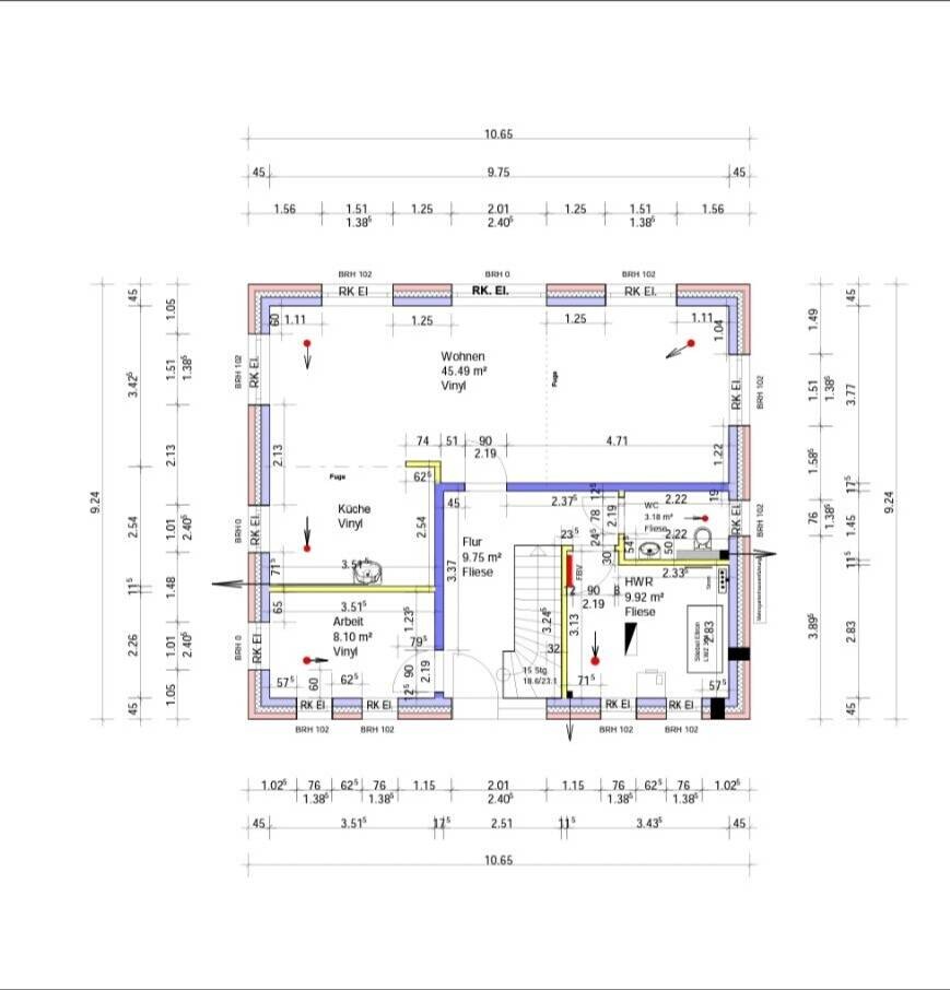

It's great to see the whole project taking shape so well.
May I ask what the exterior dimensions of the house are and how large your windows are? Perhaps you have a marked-up floor plan handy?
Lobster schrieb:
It’s great to see the whole project really taking shape.
May I ask what the exterior dimensions of the house are and how large your windows are? Perhaps you have a marked-up floor plan available?Attached is the floor plan with the window dimensions.Thank you very much – this helps me better understand the dimensions.
Next week, the ground floor will be built with masonry, and we get to decide the final window sizes.
The basic dimensions are similar (11.5 x 9 m) (38 x 29.5 ft).
Since our kitchen layout limits the interior space, the current plan is for windows of 1.38 x 1.38 m (54 x 54 inches) on the "short sides" and 1.51 x 1.38 m (59 x 54 inches) facing the terrace. The terrace door is planned to be 2.63 m (103.5 inches) wide.
Somehow, I’m not sure if 1.38 m (54 inches) might be a bit too small...
Lobster schrieb:
Thank you very much – this helps me better estimate the dimensions.
Next week, the ground floor will be built with masonry, and we will be able to finalize the window sizes.
The basic dimensions are similar (11.5 x 9 m) (38 x 30 ft).
Since we are limited inside by the kitchen layout, we are currently looking at 1.38 x 1.38 m (4 ft 6 in x 4 ft 6 in) on the “short sides” and 1.51 x 1.38 m (5 ft x 4 ft 6 in) towards the terrace. The patio door is planned to be 2.63 m (8 ft 8 in) wide.
Somehow, I’m unsure if 1.38 m (4 ft 6 in) might be a bit too narrow... Depending on how many windows are planned on the short side, I would suggest making them larger. More windows also mean more natural light.Lobster schrieb:
1.38 x 1.38 on the "short sides" and 1.51 x 1.38 towards the terrace. This difference is hardly noticeable visually—neither the discrepancy between the dimensions nor the fact that 12:11 is not perfectly square.
