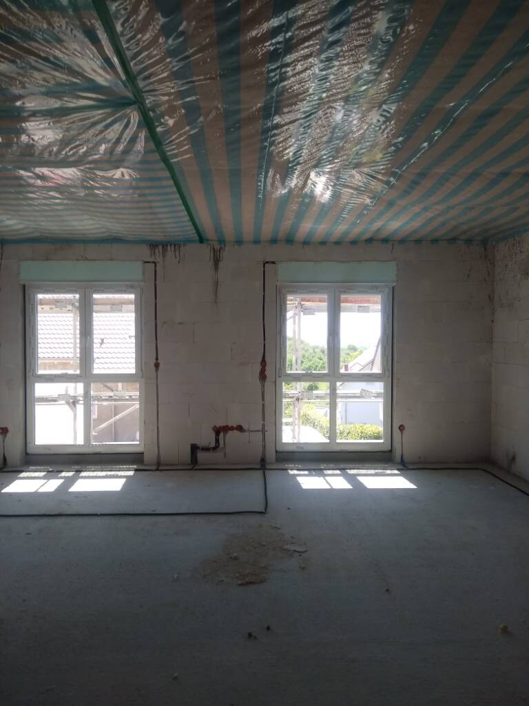

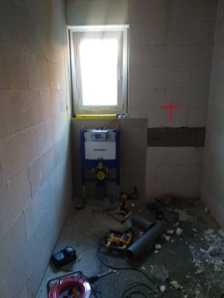

Regarding point 2, I wouldn’t have accepted it like this – in my view, the continuous foamed gap is not okay. It’s best to have a perfectly fitting profile underneath, or blocks, or doweled brackets.Good point. Our DEKRA building supervisor also noted exactly that at all the windows today, resulting in all of them needing to be repaired. Such a building supervisor is really invaluable!We had the supervised shell construction inspection today, and except for the windows and the door color, everything is great. The rough electrical installation was already finished and, according to DEKRA, it is also excellent. The ceiling insulation was installed today, and the plumbing company is already hard at work. Next week will be the supervised inspection of the rough plumbing installation. Some photos were taken during the work in progress.
