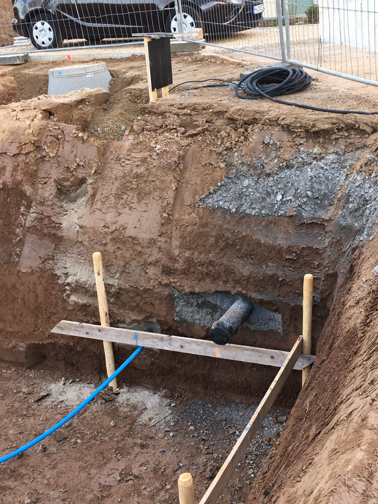

RFR schrieb:
That’s correct. In the end, it will be cut flush with the surface and then a valve will be installed on top.We had already suspected that [emoji4] I have been a silent reader of the house building forum for quite some time and have already learned a lot by observing others. After a longer preparation and planning phase, during which not everything went smoothly and we even changed architects at one point, we finally got started.

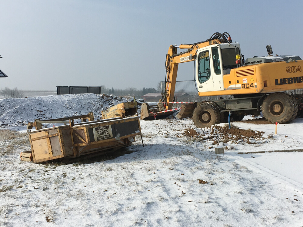

Then, a week ago, the earthworks finally began. The topsoil was removed.
At the end of the day, the construction fence was installed.
Over the weekend, the site was covered in snow.

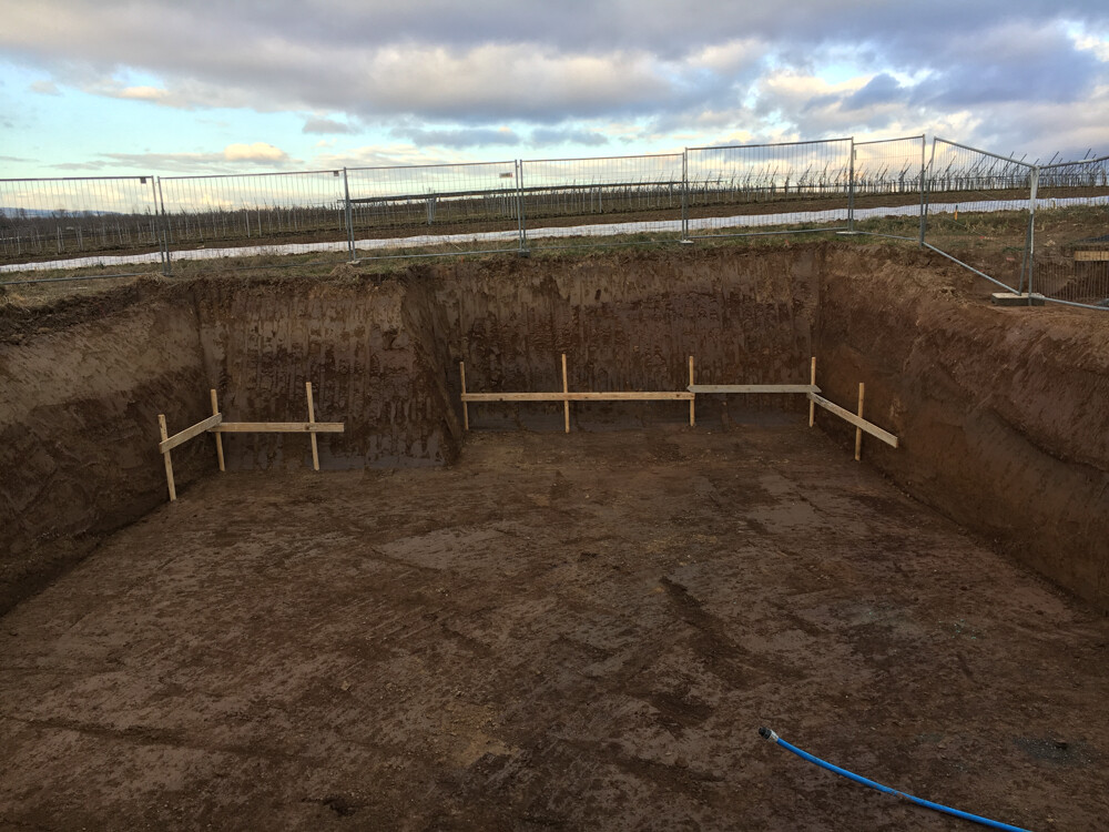

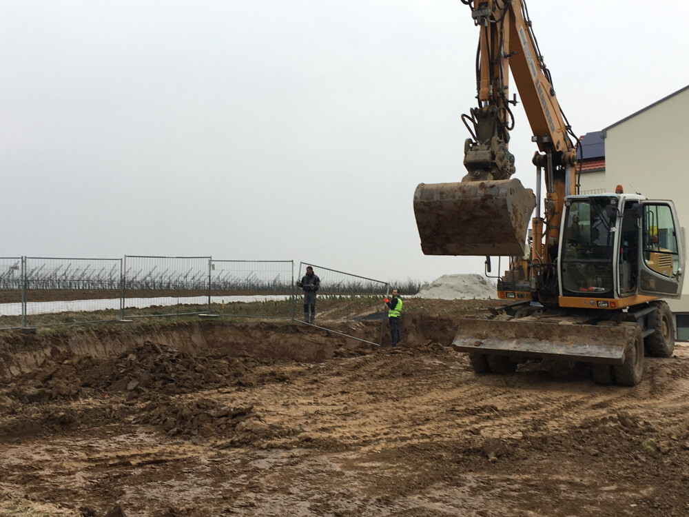

This week, work continued and the excavation for the basement was completed. Here is the result after day 4.

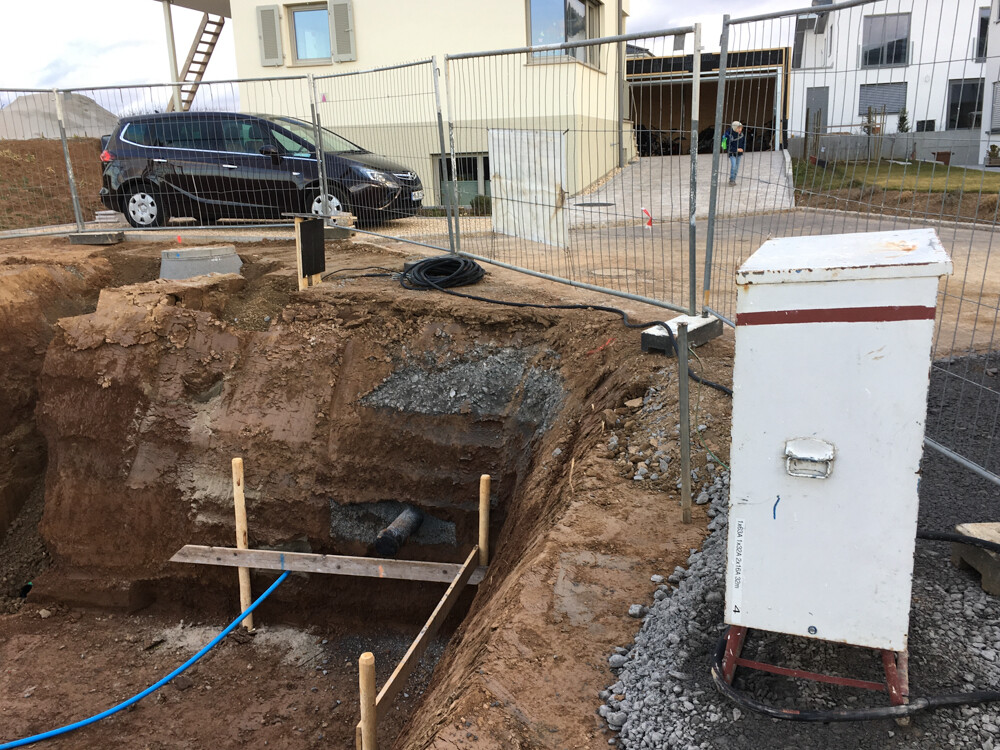

The rest of the week was used by the structural contractor to install the sewage shaft and set up the temporary power supply box.
Meanwhile, the temporary power supply box has been connected and the surveyor set up the batter boards.

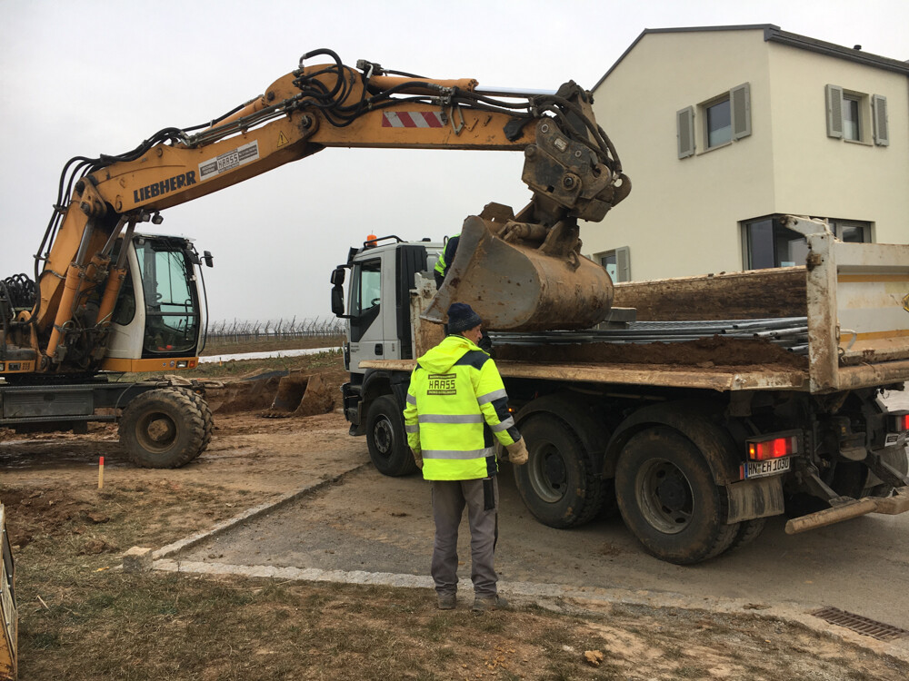

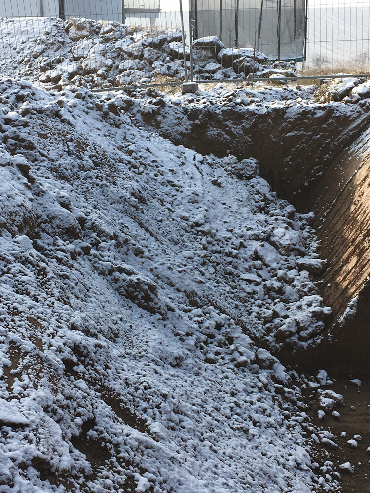

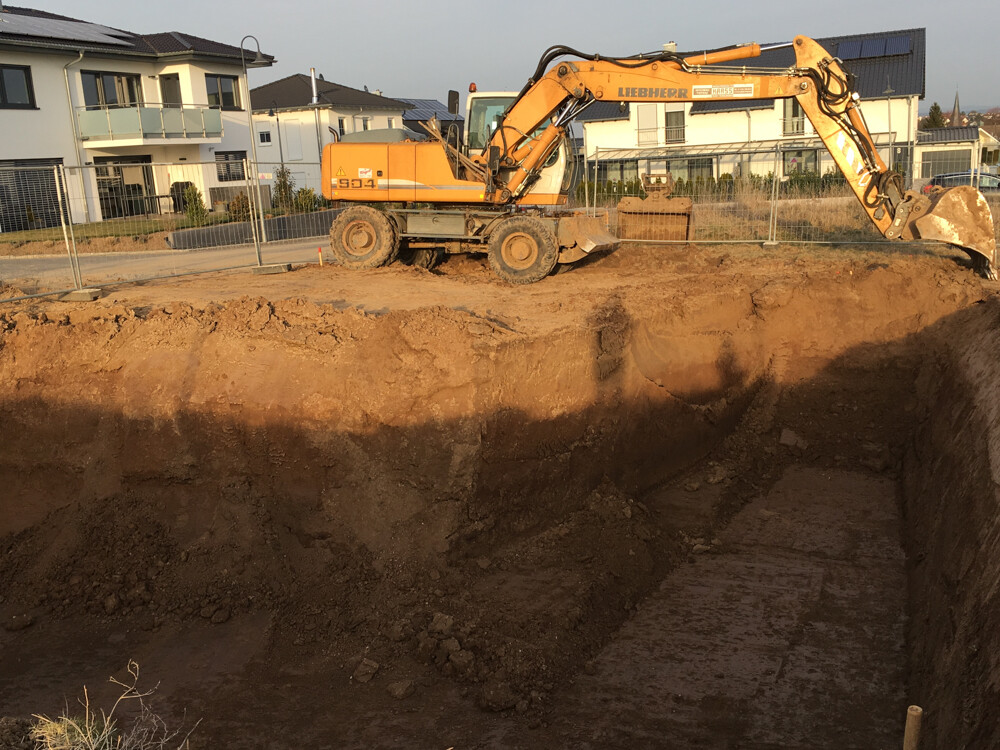

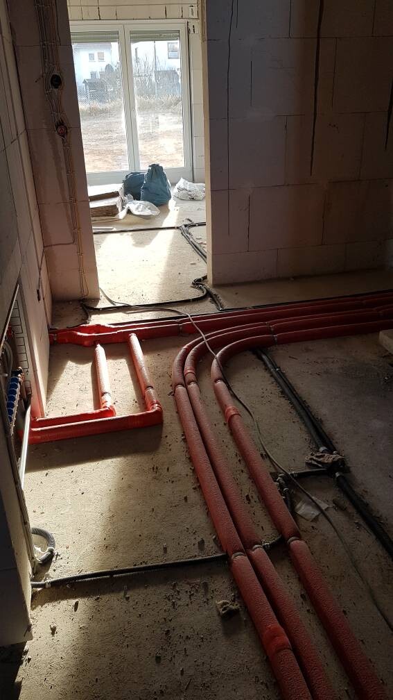

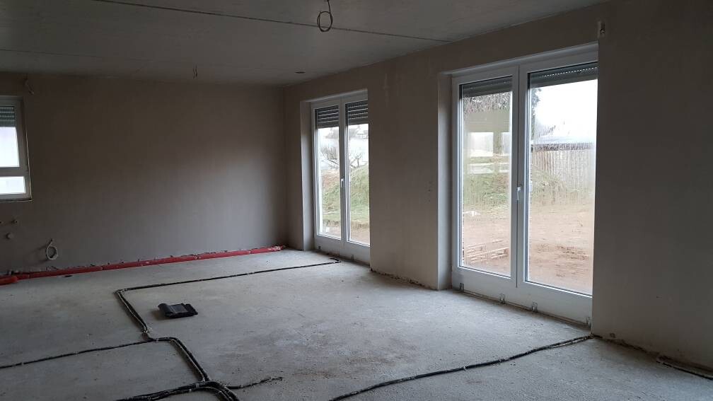

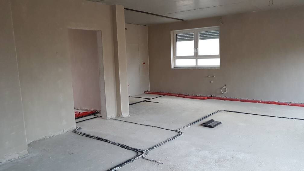

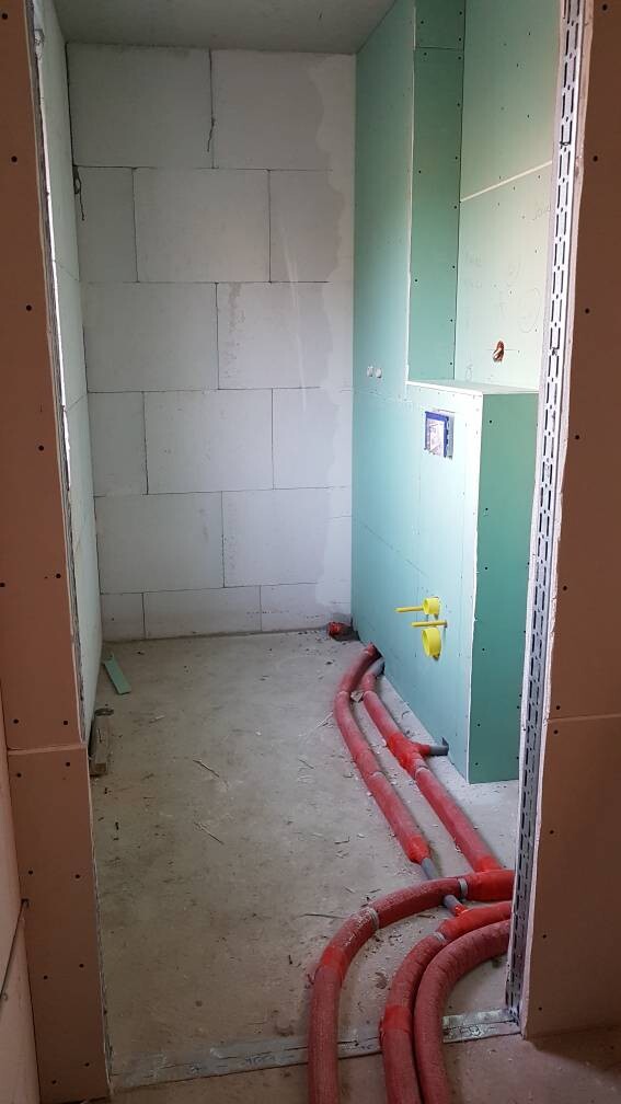

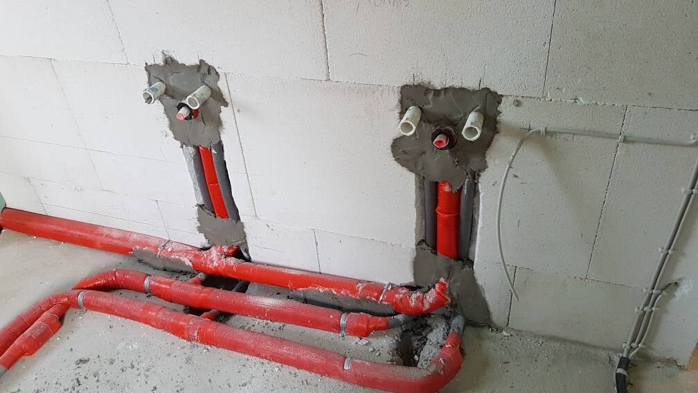

So, the interior plastering has now been completed. Next week, the ventilation ducts and underfloor heating will be installed.

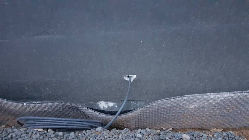

However, we're concerned about the hole for the electrical cable to the garage, since this spot will later be underground. Won't that create a potential leak? We’re a bit worried that it might cause a damp living room wall [emoji848]

R.Hotzenplotz10 Mar 2018 19:35Hi,
If that spot really ends up underground, that is... suboptimal. The electrician wanted to do the same at my place and is still upset today that I didn’t accept it.
Penetrations should either be well above the final ground level or more than 50cm (20 inches) below it, and properly sealed with a Doymer seal or similar. Anything in between is a poor solution and will cause you problems!
Regards,
Andreas
