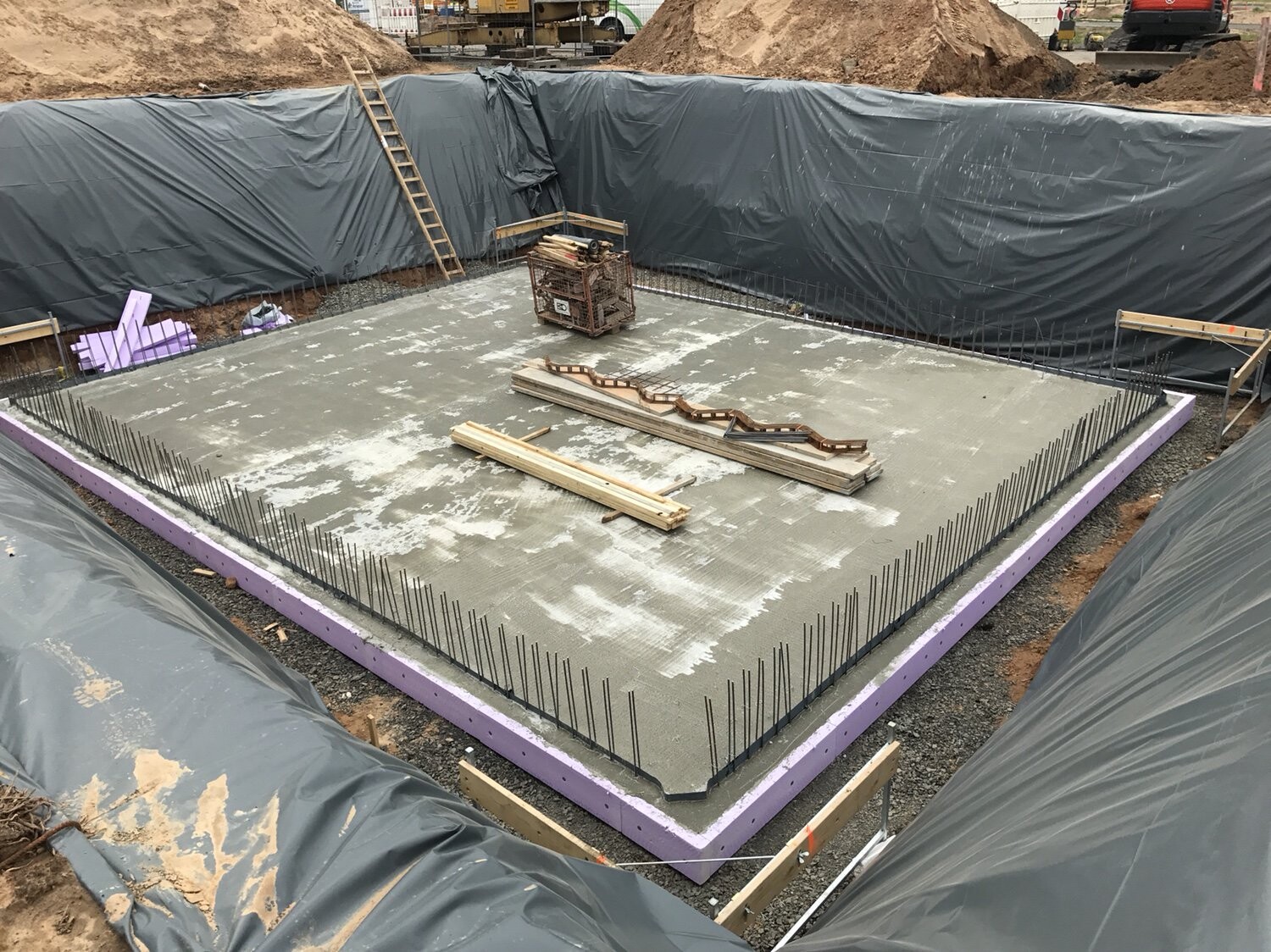

Ah, the basement is finished, just waiting to proceed? And then the wall will be built stone by stone, right? Why isn’t the basement built stone by stone? Isn’t that better, or why are there these two options if I may ask.Because a masonry basement is not as waterproof as one made of waterproof concrete. This is completely normal.
tomtom79 schrieb:
@Eldea that’s not a waterproofing! Where are the sheets between the slab and the walls?What do you mean by sheets?xray107 schrieb:
Google "joint flashing" – the first link is Wikipedia.
Was it installed like that at your place?
More information with these Google terms:
“watertight concrete structures” (first link)
"abp joint seals" (first link) Glatthaar is also mentioned under abp joint sealing. I believe they use their own system for their Aqua basement.
However, they didn’t use a joint tape.
I’m not an expert, so I can’t say for sure if a Glatthaar prefabricated basement is a true waterproof tank (tank waterproofing). [emoji848]
