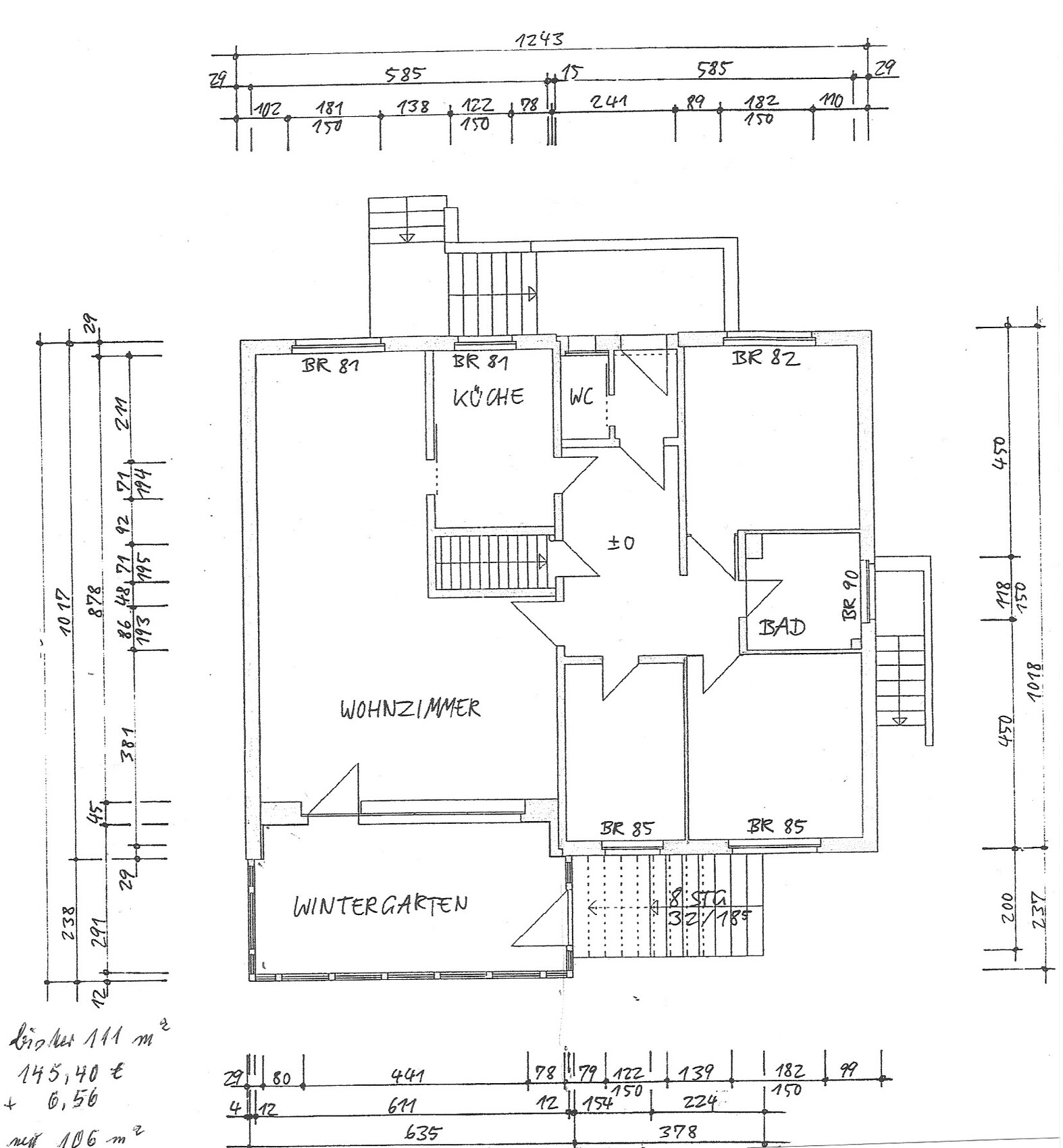

This is a panel building from the late 1970s underneath the exterior finish. The floor plan may no longer be very modern. However, especially on the right side of the plan, some walls can be removed. Only the 15cm (6 inch) wall between the living room/kitchen and the hallway must remain, as the ceiling elements span the full 5.85m (19 feet 2 inches) horizontally from the outside to the center.

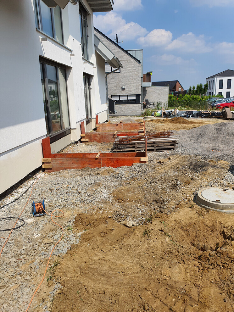

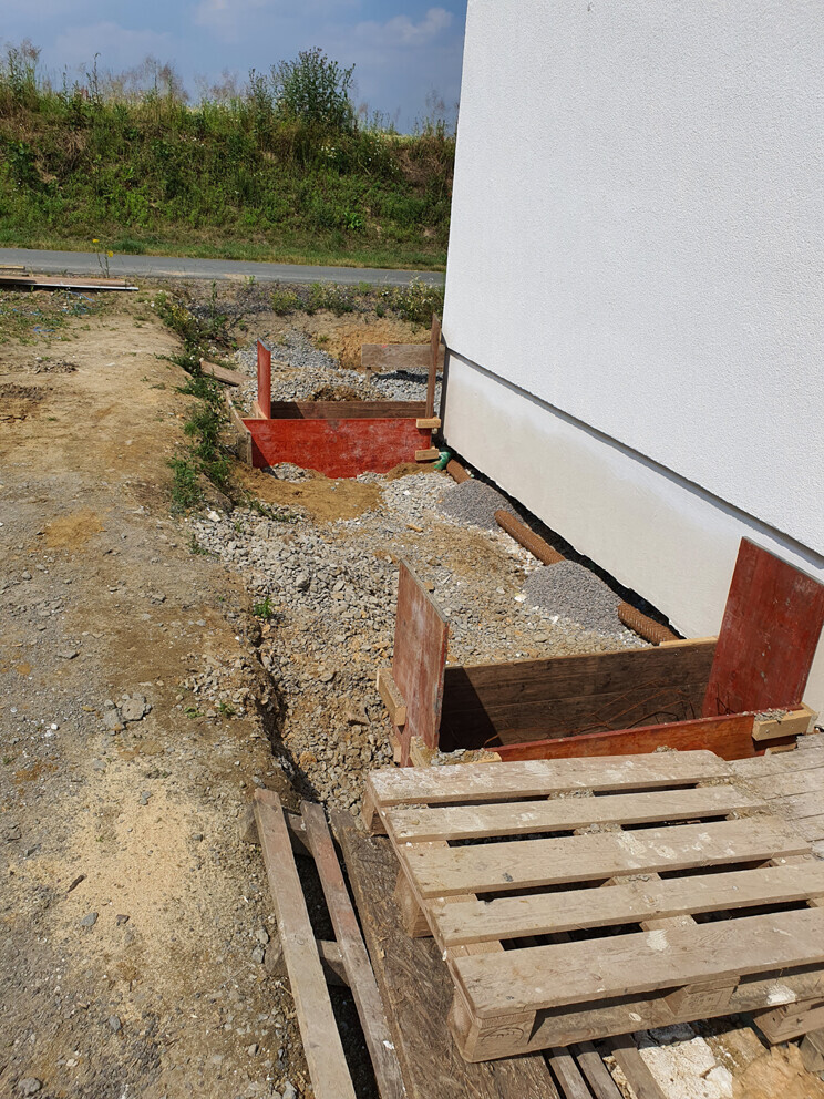

Today I carried out some heavier work again. Prepared seven foundations (formwork) for balconies and external stairs according to the metalworker’s specifications.
At the same time, I partially connected the drainage of the basement floor. Unfortunately, despite using the mini excavator, one connection point was not found 😡. By the way, the cisterns were already about one third full.

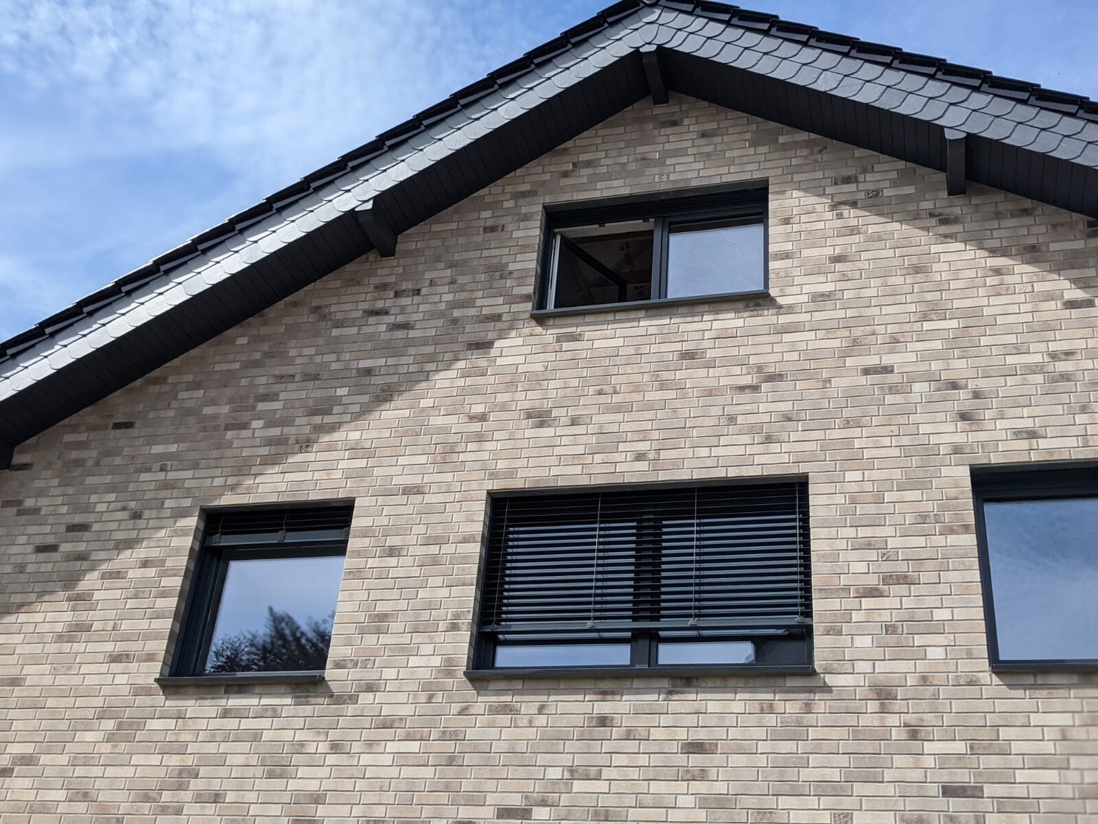

i_b_n_a_n schrieb:
Today, I carried out some heavier work again. Prepared seven foundations (formwork) for balconies and external stairs according to the metalworker’s specifications.
At the same time, partially connected the drainage of the BP. Unfortunately, even with the help of the mini excavator, one connection point could not be found 😡. By the way, the cisterns were already about one third full. The brick house in the background looks interesting.
