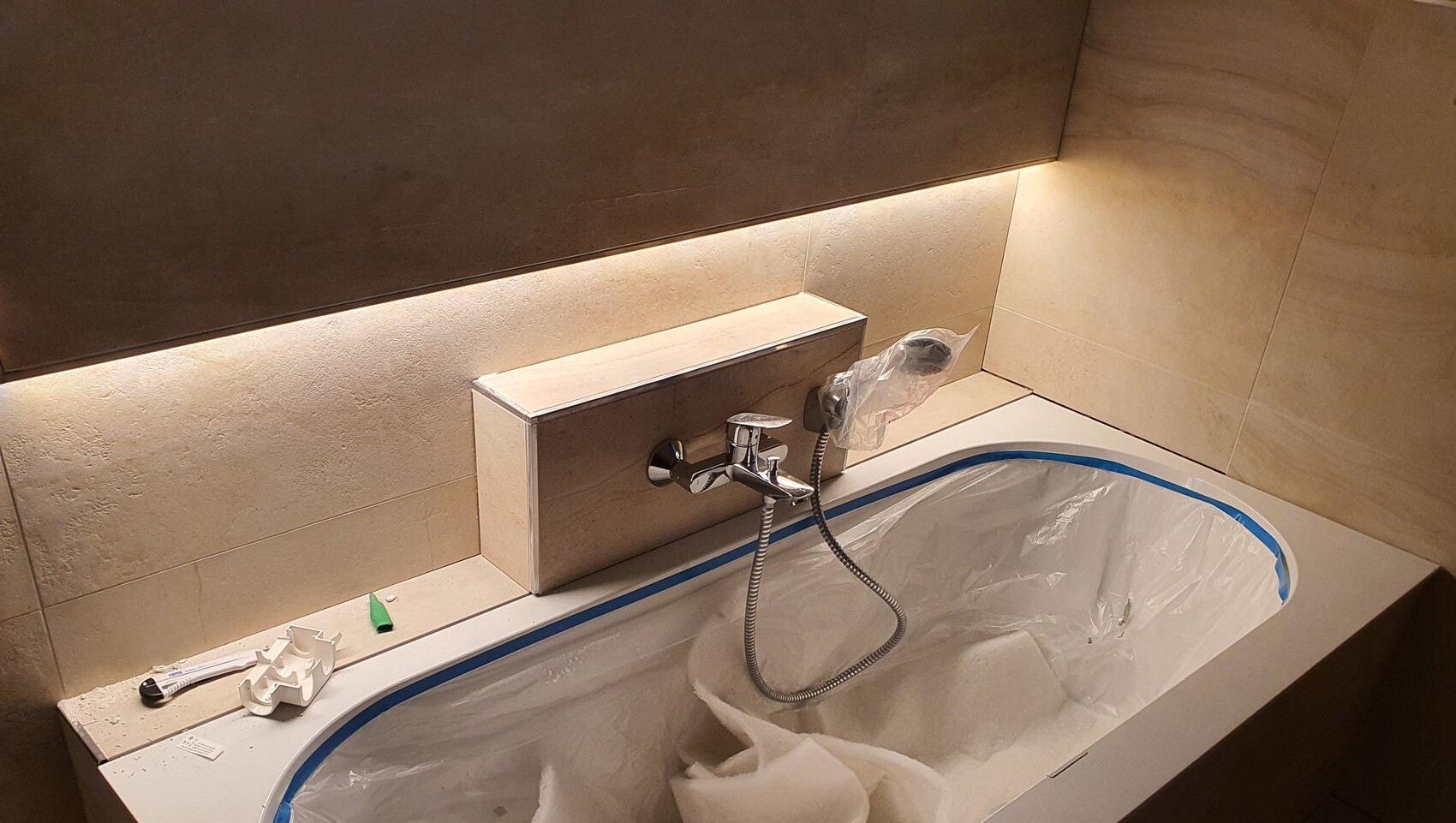

That's true 🙂. For example, we have an LED strip above the bathtub. My daughter (2) loves it and always asks for green :p
The silicone seals are still missing here. The bathroom wasn’t completely finished yet.
Did you also save on the size of the bathtub? What are its dimensions?
It should be around 175x80 cm (69x31 inches) or so. We deliberately chose a slightly smaller size because our last one was too long for us.

We did the same. Based on many other people's and our own experience. If you want to lie properly inside, you usually have to stick your feet out at the end anyway. But if you want to read inside, even 10cm (4 inches) longer makes you slide down, and you end up constantly trying to push yourself back up.

Exactly. And the tub is also quite deep, so you finally get properly covered with water 😀
