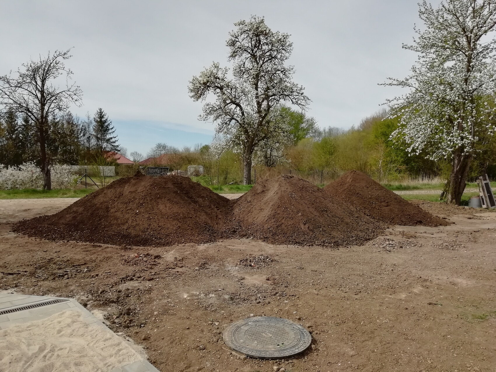

dab_dab schrieb:
Self-installation of technical equipment for the cistern (water level measurement, self-cleaning filter) and the domestic water system with potable water top-up for toilets using rainwater has been completed (pipe clamps and neat pipe routing to follow): I had planned the same for toilets and the washing machine... recently a salesperson told me it wouldn’t be worthwhile for my situation because the yield would be too low... no idea now.
@dab_dab you should have received a private message (unless the system is acting up again)
@tumaa economically, connecting to the toilets usually isn’t worthwhile (additional piping, pump operation, etc.). Also, the toilets often get heavily soiled because the filter only removes suspended solids. Depending on the water, deposits can form. I would never do it with the washing machine. It’s better to have a hot water connection for the washing machine if it’s close to the heating system or manifold (short piping).
You should use your rainwater/well water for the garden instead.

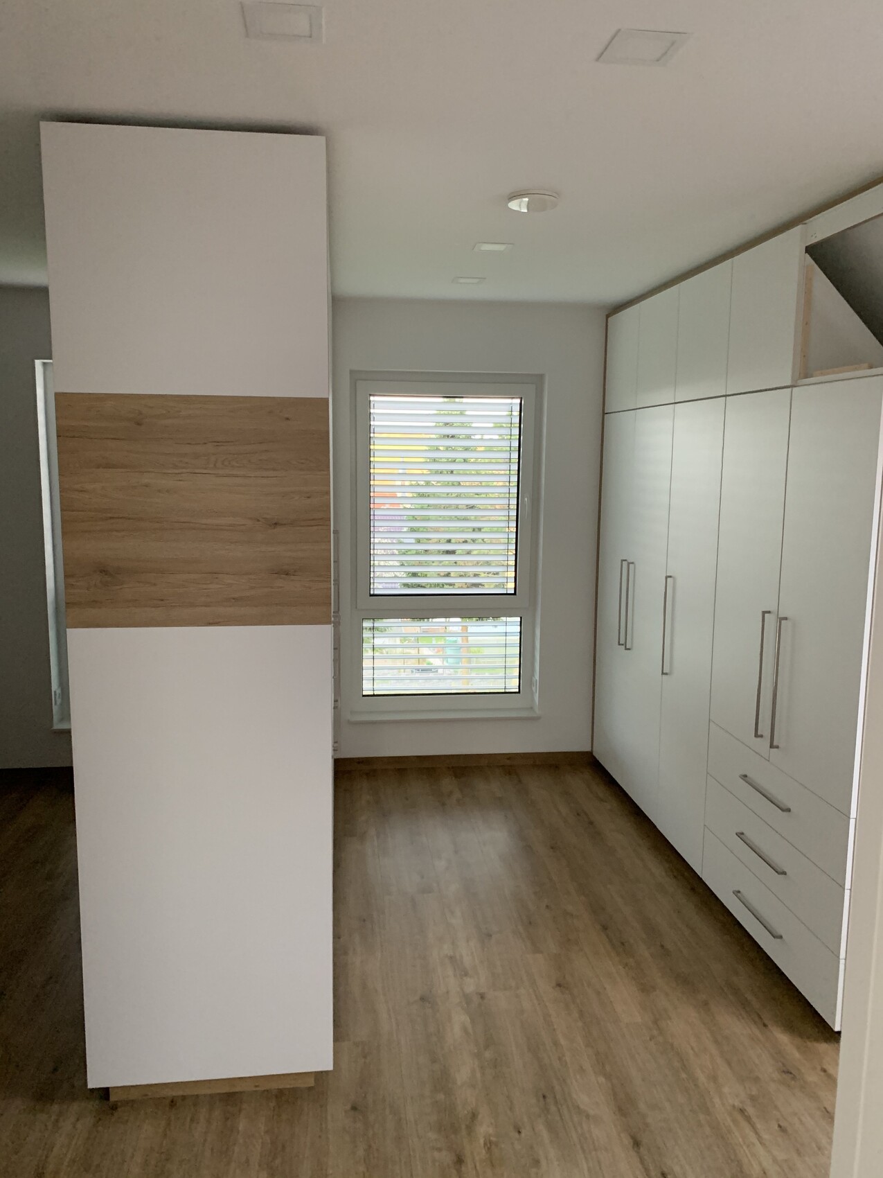

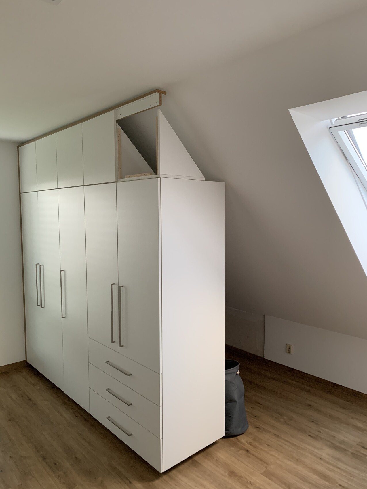

goalkeeper schrieb:
How are you planning to deal with the sloped ceilings in the bedrooms?Good morning
The wardrobe will have a side panel as well, which will include shelves and a surface to place clothes on.
A “frame” will be built into the slope with a sliding section. This will allow access to the “storage” area behind the wardrobe where suitcases and similar items will be kept.
