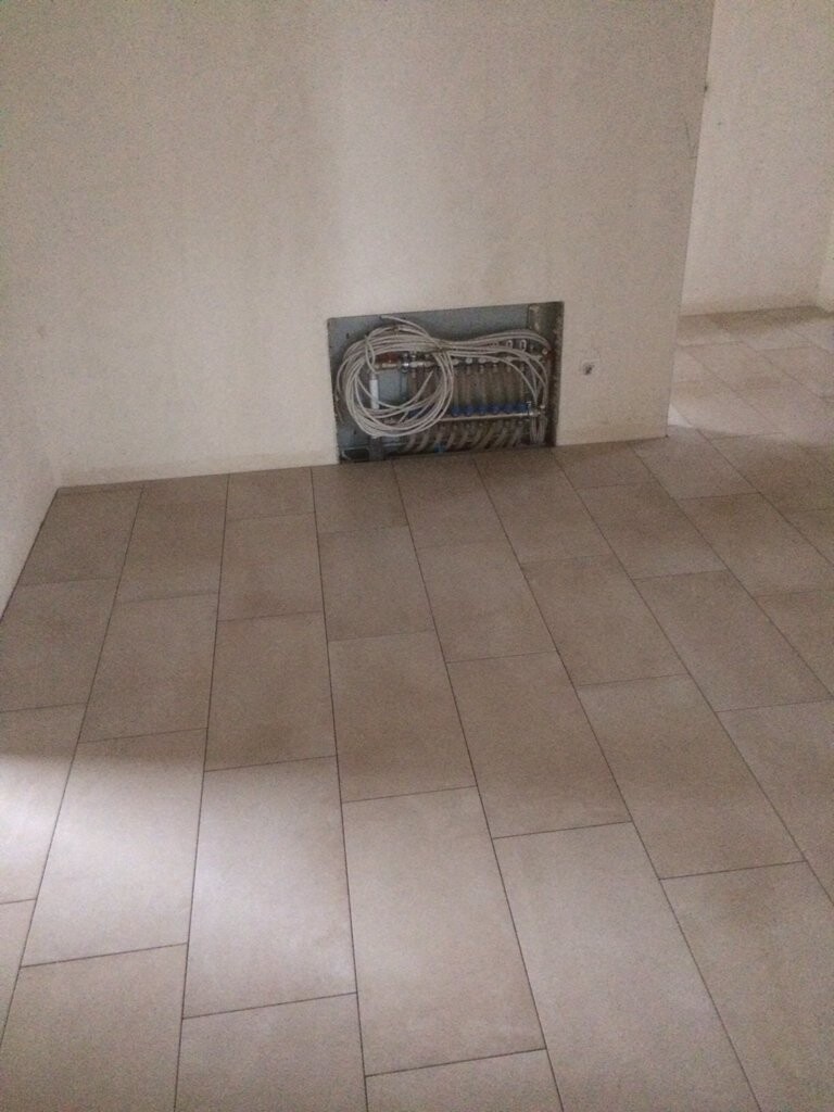

Bieber08152 Aug 2017 13:10In the last picture, electrical cables are lying on the floor without any distance from the wall. Will a screed be poured over them? In my opinion, that would not be allowed.
toxicmolotof2 Aug 2017 13:16The screed layer will appreciate the first and last picture and will immediately provide the de-bonding statement for signature.
Bieber08152 Aug 2017 13:26@DNL please share some details about the planned floor construction ... (possibly in a new thread).

The photos are a few days old, and the screed installer hasn’t raised any complaints. He has been working with the company for a while.
First photo is the upper floor. Second photo is the ground floor, where all the technical equipment will be installed.
Construction layers (roughly, don’t hold me to exact centimeters):
Ground floor: 8 cm (3 inches) insulation and, where pipes are, loose fill. 4 cm (1.5 inches) insulation. 4 cm (1.5 inches) system panels for the underfloor heating. 7 cm (3 inches) screed.
Upper floor: 4 cm (1.5 inches) sound insulation and loose fill, 4 cm (1.5 inches) insulation, 4 cm (1.5 inches) system panels, 7 cm (3 inches) screed.
This means the pipes do not come into contact with the screed. There are still a few centimeters between them.
The cables also do not come into contact with the screed. Is that what you meant, Bieber0815?
