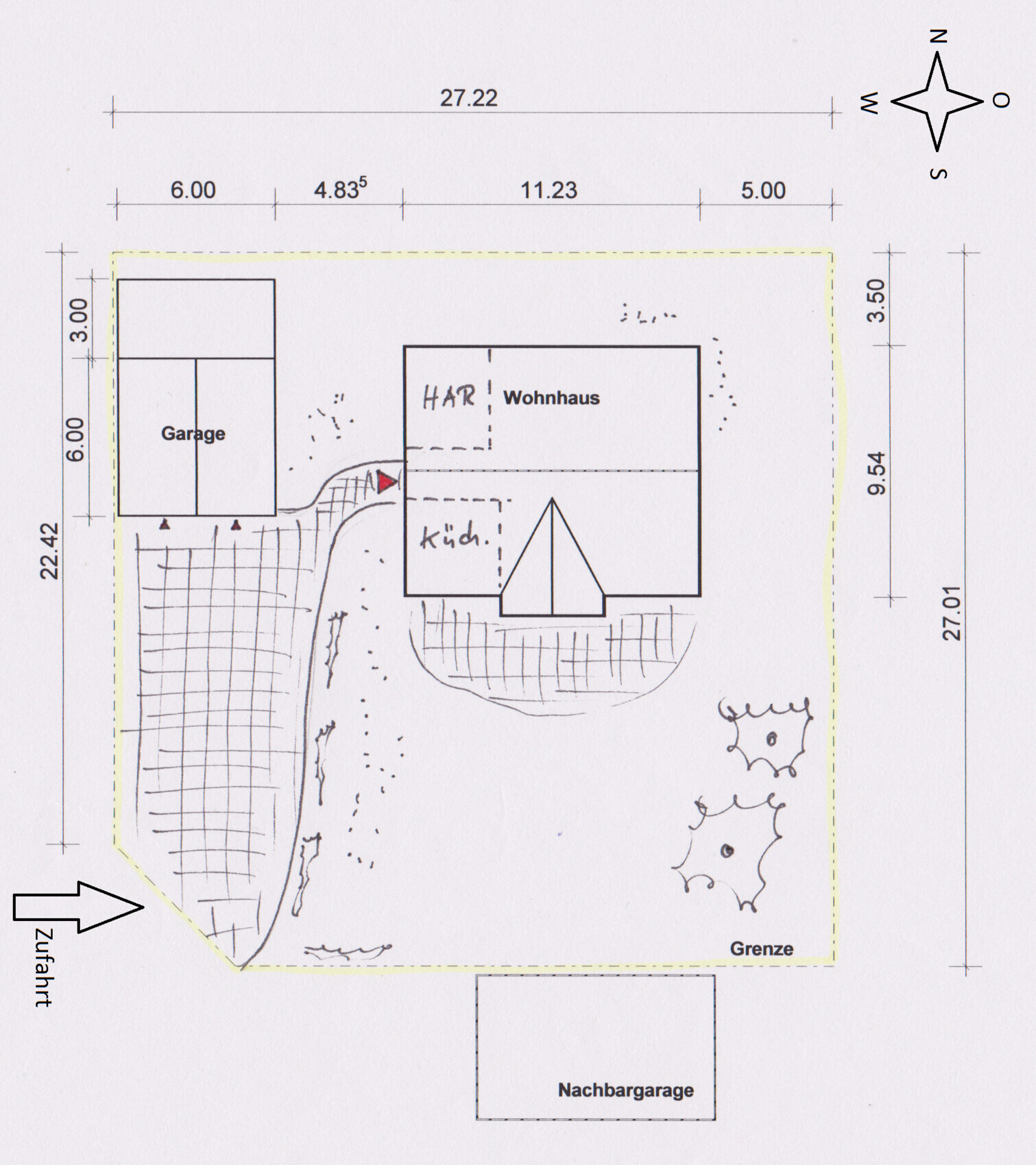

wadenkneifer9 Feb 2014 22:32Hello,
Access to the property from the east is not possible, right? What is on the east side?
I'll start from the beginning:
- Have you considered positioning the house further west and placing the garden/terrace towards the south/east?
- If yes: garage on the west side as in the first design. If not: garage on the south side.

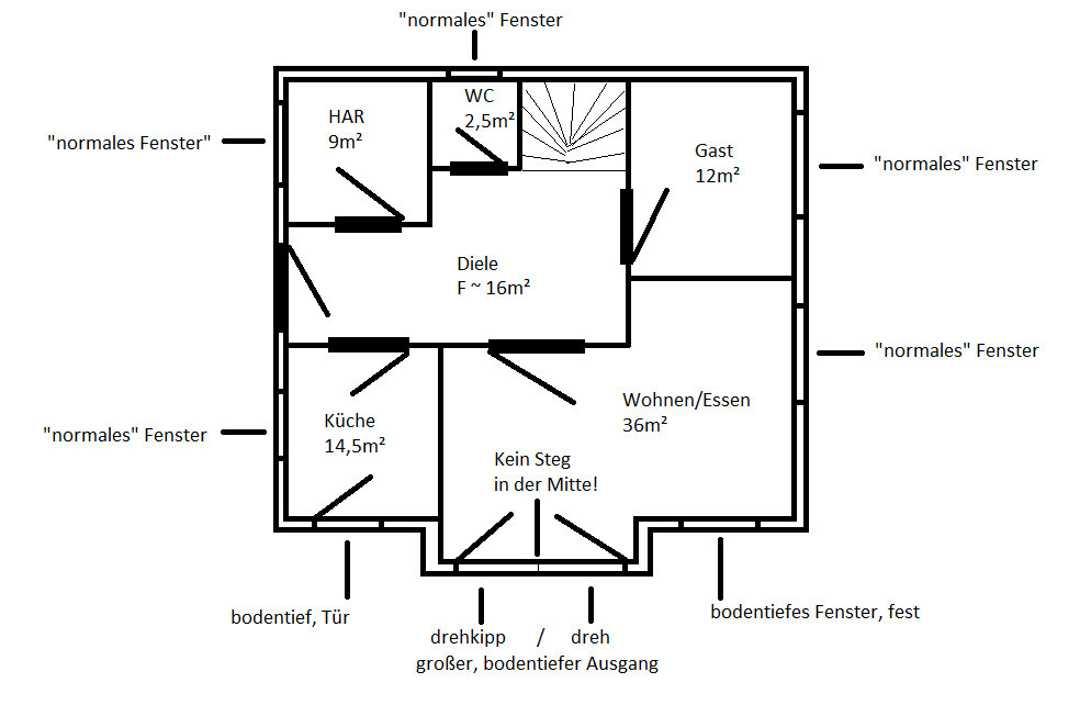

Regarding the floor plan:
- Ground floor:
-- You have a large hallway but hardly any usable space for a coat rack, cabinets, or similar.
-- Maybe switch the utility/storage room and the guest toilet, then you could create a nice area for a coat rack in front.
-- Additional idea: swap the kitchen and living room. So living room in the southwest corner and kitchen in the southeast.
-- Furnishing the living room and kitchen looks a bit challenging to me. For the kitchen units, only the wall facing the living room remains, which seems rather small for a family of four. Living room: dining table in the bay window? Seating area facing the guest room? Where would the TV go then?

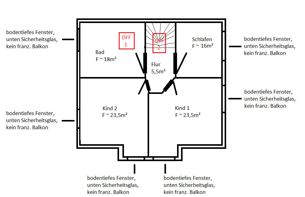

- Upper floor:
-- The ratio of children’s rooms to the master bedroom seems very unbalanced. The master bedroom could become quite cramped, and I don’t see space for a wardrobe there.
-- Why a double casement window in the bathroom? I would strongly consider a floor-to-ceiling window on that side of the bathroom.
