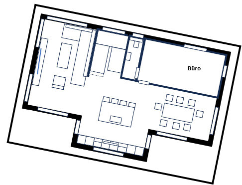

we have purchased a quite challenging sloped plot and have now received the first draft from our architect. I have personally revised it to address some weaknesses that arose due to my requested changes. The exterior dimensions are relatively fixed. I am fairly satisfied but would appreciate some additional feedback before sending it back to the architect.
Development Plan/Restrictions
Plot size: 731 sqm (7870 sq ft)
Slope: Yes, steep slope; the street runs north down into the valley and the garden is elevated on the mountain to the east
Building envelope, building line and boundaries: 3 m (10 feet) to neighbors/street
Orientation: Garden east, street west
Maximum heights/limits: still uncertain. According to the preliminary building inquiry, about 9.50 m (31 feet) from basement slab
Other requirements: according to § 34
Style, roof type, building type: Modern, flat roof
Basement, floors: Basement plus 2 full floors
Number of occupants, ages: 4 persons (41 years, 29 years, 3 years, 1 year), possible third child later
Space needs on ground floor: Living-dining-cooking area, storage/pantry, guest WC, office

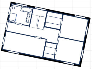

Space needs on upper floor: Bedroom, dressing room, master bathroom, utility room, 2 children’s bedrooms, children’s bathroom
Space needs in basement: Secondary apartment as office and fitness area, technical room, entrance/wardrobe, storage, technical room, garage
Office: Family use or home office? 2 home office rooms
Overnight guests per year: 2 weeks per year
Open or closed layout: Very open living-dining-kitchen area; rest more closed
Conservative or modern construction: ?
Open kitchen, kitchen island: both desired
Number of dining seats: 8-10
Fireplace: rather no
Music/sound wall: if possible
Garage, carport: Large garage with double door
Additional wishes/special features/daily routine, also reasons why something should or should not be included: very different daily rhythms, husband goes to bed late and sleeps accordingly long. Basement office for undisturbed work.
We would like the garden level to be as high as possible above street level since the plot borders a nice meadow that is currently about 1-2 m (3-6 feet) above garden level. However, the house cannot be set too high because otherwise the garage entrance would become too steep.
Planner: Architect, with interior adjustments by myself
What do you particularly like? Why? Open, spacious living area, bay window
What do you dislike? Why? Unfavorable cloakroom situation when arriving from the garage. Long dirt zone through which you have to pass to reach the office.
Price estimate by architect: over 1 million
Personal price limit for house, including features: basically already stretched at 1 million, possibly up to 1.1-1.2 million
Preferred heating technology: Heat pump, underfloor heating
- Can you give up: Installation of the basement office as a separate apartment, but desired for tax reasons
- Cannot give up: Basically everything is in some way desired/important
Why does the design look the way it does? For example:
Due to the challenging slope of the plot, many factors are more or less predetermined. There was already an approved building application from another architect, which independently resembles this design closely.
I fell in love with the kitchen bay window in a show home, which unfortunately means the pantry cannot be used as the direct extension of the kitchen as originally planned... Since the kitchen is very large, the room will probably function more as a storage pantry.
On the upper floor, the second children’s bedroom is located in the northwest rather than the southwest because the higher neighbor's house stands directly to the south, and to the north there is a great view of the green valley.

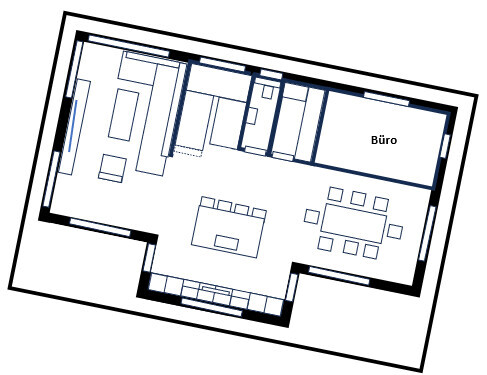

hanghaus202315 Jan 2025 15:55Skya2020 schrieb:
It really isn’t an easy plotThanks for the plan. The plot is actually straightforward. Just place a normal house on the existing level, then add a garage with an entrance underneath — done.I had thought about positioning the house sideways to get a much larger garden.
hanghaus202315 Jan 2025 16:05W
wiltshire15 Jan 2025 19:09hanghaus2023 schrieb:
I tried a somewhat smaller version. An integrated garage in the house is indeed a feature that, if omitted, allows for new, more cost-effective, and possibly more practical solutions. In the case of a sloping site, the garage roof could be discreetly planted, making it just as invisible from the house and garden as with the built-in option.
I just noticed I accidentally uploaded the ground floor plan twice.
Thank you very much for your design. Unfortunately, it doesn’t quite suit our needs. The bedroom cannot be on the ground floor because my husband sleeps until midday, and then we wouldn’t be able to be noisy in the living area. But I’m currently working on another stair design myself and will definitely use yours as inspiration.
wiltshire schrieb:
An attached garage is indeed a feature that, if omitted, allows for new, more affordable, and possibly more practical solutions. With a sloped site, you could discreetly landscape the garage roof, making it invisible when viewed from the house and garden, just like an integrated design.Where would you place the garage then? Because of the sloped site, I thought it was the only logical option.Skya2020 schrieb:
Where would you place the garage? Given the slope of the land, I thought it was the only logical option? It can be expensive if the garage is included within the thermal envelope or if it needs to be insulated to the thermal envelope from within the building envelope.
You can, for example, place the garage in front of the house.
I would create a room program for the architect and then let her design independently from any existing or non-professional drafts (you can usually spot their "bugs" quite well).
