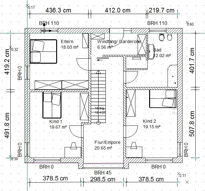

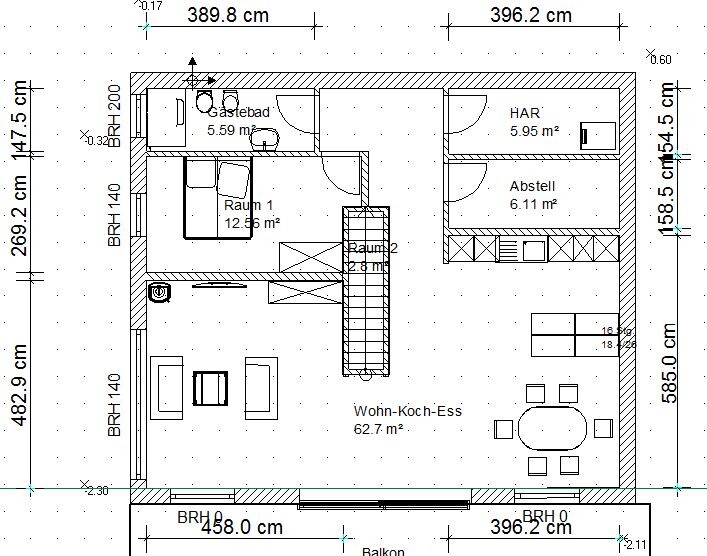

Usually, when building a house, you don’t start from being homeless but already have experience living in an apartment or house (Is the dining table too close to the sideboard? Do you have to run the same marathon to fry an egg in the kitchen as you do for a wedding menu?). This simple option—to draw your current home and mark in red what you find inconvenient—is available to every future homeowner. Therefore, I don’t understand how anyone can struggle so much to find a proper starting point. Surely, finding graph paper and a tape measure shouldn’t be a problem. This is far more helpful than getting overwhelmed by show homes and trying to squeeze a standard model house onto your plot just because “the perfect house must be found,” or, like in your case, having the planner take a floor plan they have been pushing since 1950 for the Müllers just as readily as for the Meiers, only to alter it slightly by adding a secondary living room in the basement.
here are new, furnished floor plans for the (residential) basement and ground floor – however, we have changed the room layout and stair design again because, among other things, Maria was right that the room would otherwise be difficult to furnish. We are still undecided about the attic floor, so there is no floor plan for it yet --> but it could later accommodate a large master area and an additional bathroom.
@Maria: By other points, I mainly meant considerations about the size of the wardrobe area, master bathroom/children’s bathroom versus family bathroom, etc., which are secondary for us and should fit into an otherwise coherent floor plan.
In fact, over the last six months we have spent a large part of our free time focusing on such considerations and have had many, unfortunately not very productive, meetings with our home builder. Of course, you wouldn’t be able to tell this if we haven’t posted here for a while – so we understand your reactions.
Now we hope to receive more helpful suggestions from you here.
You always plan very generously, bigger than everything needs to be ... Yes, in the end, the volume is too much. If I remember correctly, a 45° roof pitch is required (?), then the reduction must be applied to the floor area.
Hello, regarding the budget: the financing is secured, and the current shell construction offers give us hope that we will come close to the planned amount.
A gable roof is required by the city due to the “ensemble-protected” streetscape—> However, we can definitely make good use of the space in the attic because the grandparents often stay for several months and could have their own area there.
We have already scheduled an appointment with an architect for next week. We really appreciate your tips (which is why the living room is now in the basement) and if you have any further recommendations on the current design, we would be happy to consider them during our meeting.
