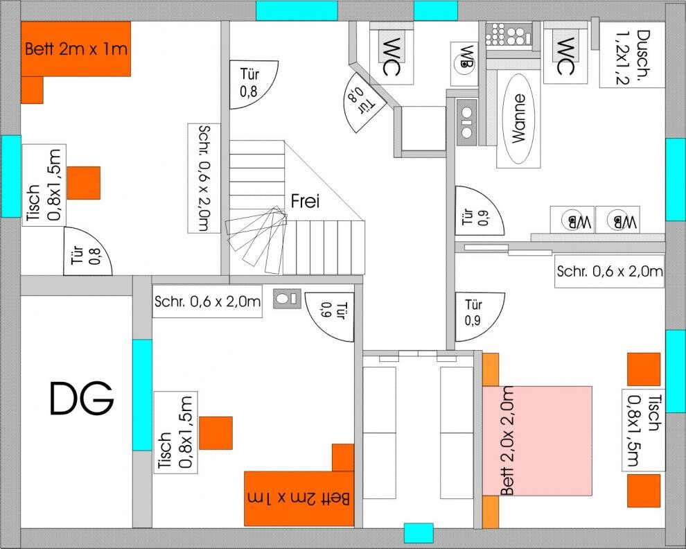

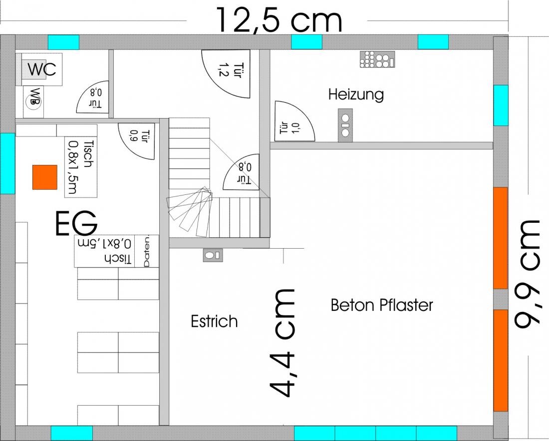

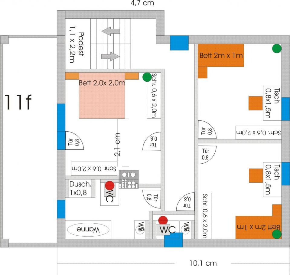

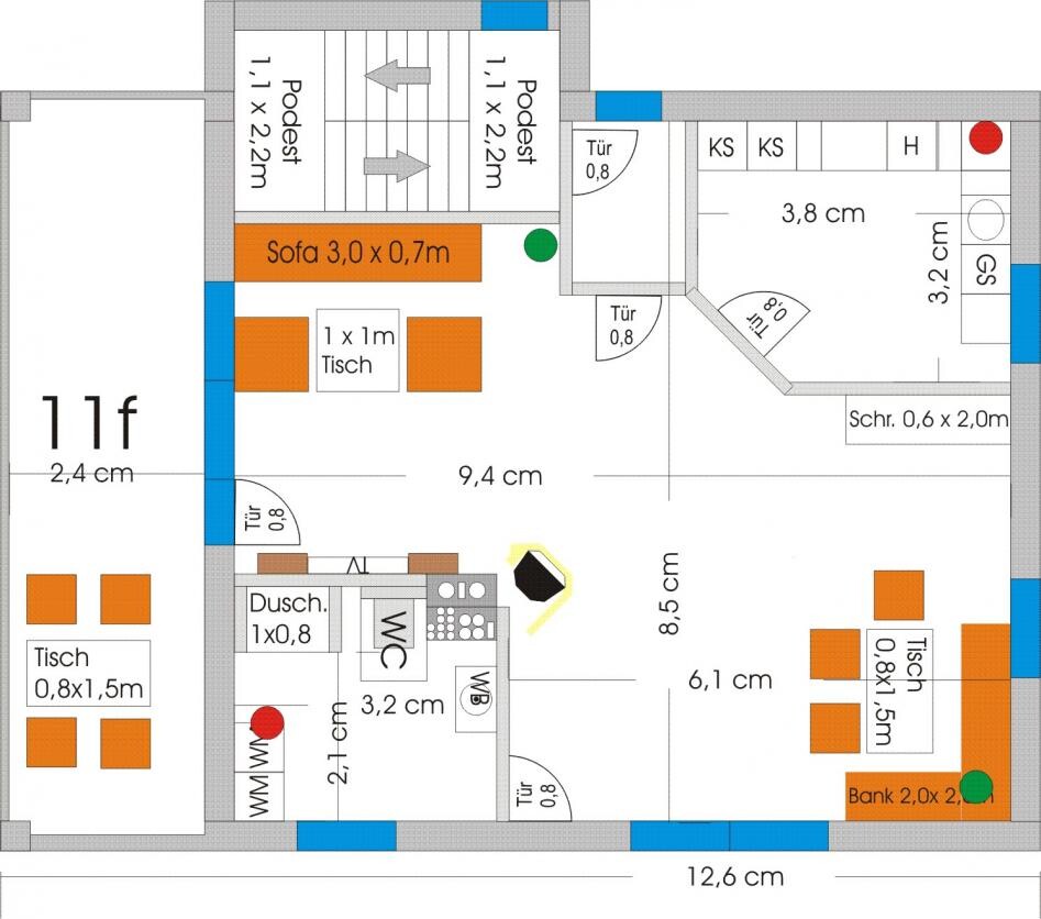

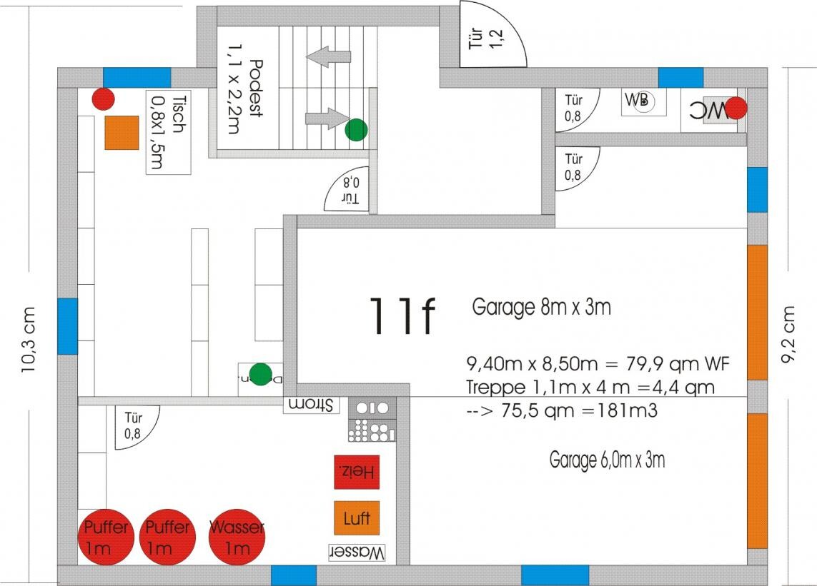

Hello everyone, I finally have a new draft for discussion.

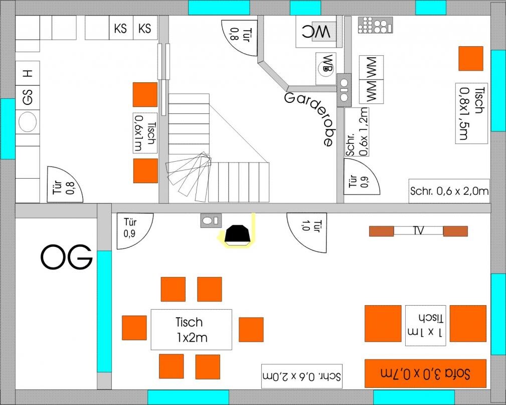

Hello, I’m back. I want to thank everyone who has shared their opinions with me so far. I have taken a lot to heart and made some fundamental changes.
@Bauexperte I also requested a financing offer for 400,000 euros to be on the safe side.
Here are my new floor plans. Maybe you can “tear them apart” again.
Thanks to everyone in advance.

the floor plans again
Detailed floor plan of a house with attic, doors, and stairs.
Floor plan of a house with ground floor, staircase, heating room, and building component labels.
2D upper floor plan with kitchen, dining area, living room, stairs, and furniture

Is there already a ceiling in the attic / upper floor? If not, one room in the attic is missing a window. Why don't you put your utility room with the heating system in the basement? Then you could place the kitchen on the upper floor and create an open kitchen/living area.
