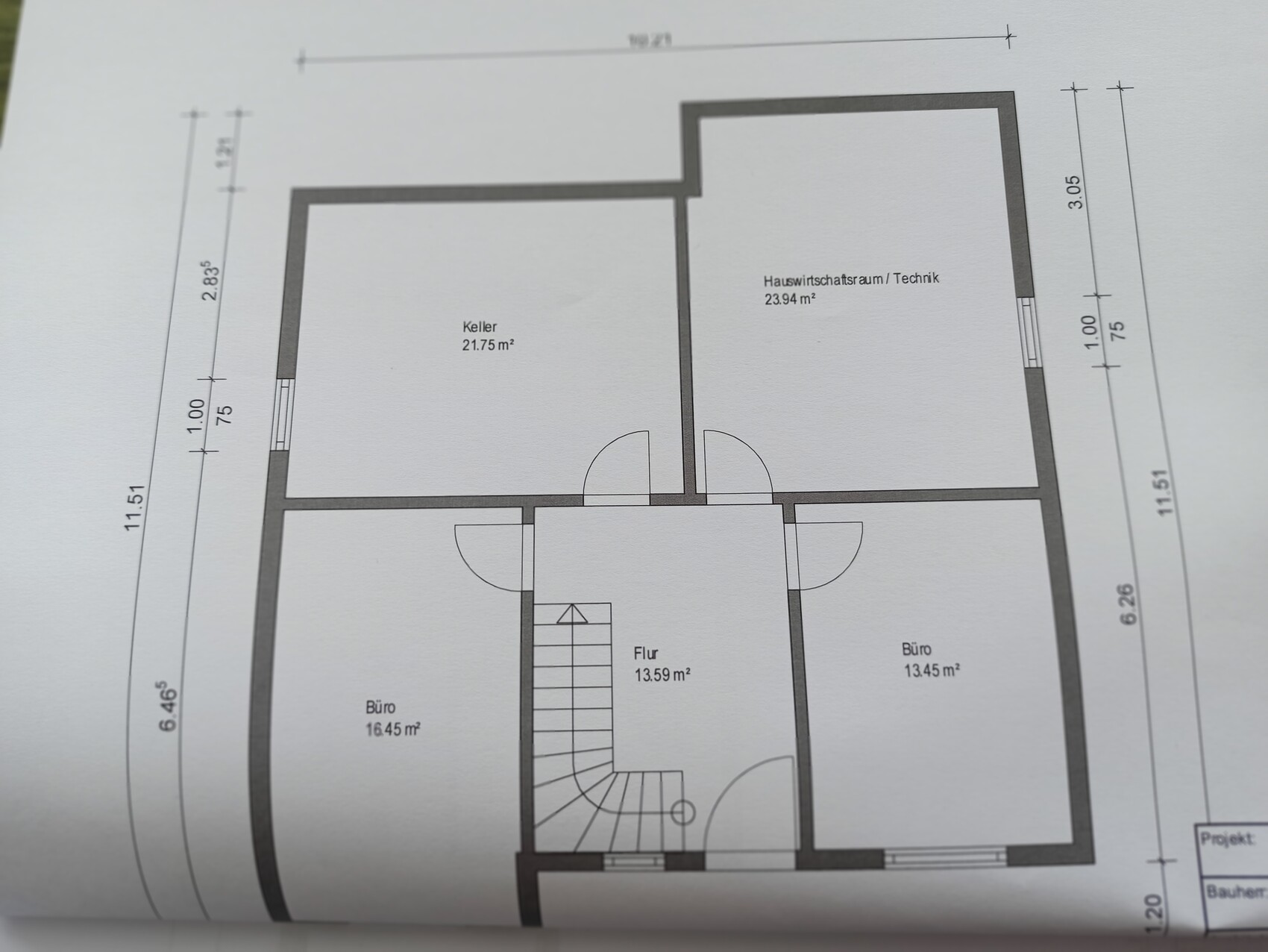

Option 1: Entrance in the front area, with rooms on the right and left that we currently plan to use as offices. A staircase leads up to the main living area.

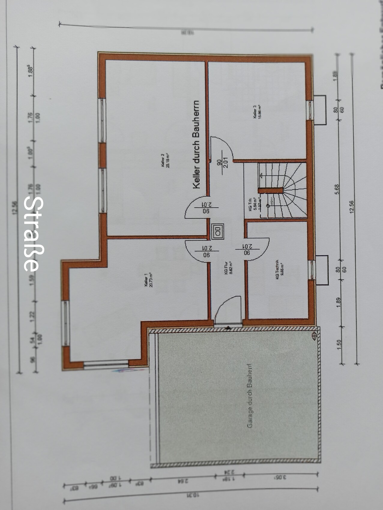

Option 2: The entire front facade will be rooms, maximizing natural light. The main entrance will be on the side of the house. Because of the slope, this would involve paving and stairs. A secondary entrance would be located on the side of the basement. A garage will be added here at some point anyway.

We have now received two suitable offers from the general contractor (GC). "Suitable" in what way?
Thirteen schrieb:
Our plot is on a slope, The house design, however, is not: it simply places a house for a flat plot on a pedestal in the form of a full basement.
Thirteen schrieb:
We are having trouble picturing both concretely, Me too—not just because the basement shown obviously does not belong to the same house design.
This won’t work like that. Please create an introduction thread and a floor plan thread (starting with the completed questionnaire at the top of the floor plan section), include the development plan/planning permission in the floor plan thread, and link both threads to each other. If necessary, you can also use this existing thread, but don’t delay with the questionnaire, site plan, and so on, so that the key information is summarized at the beginning.
I will only believe the house shown is permitted according to the development plan. I have particular questions regarding heights and the number of floors. In any case, the concept could be improved; with this sloped site, the entrance level should be at the lower side.
I agree with 11ant. This is not a hillside house. It’s a standard house with a basement pushed underneath, which is exposed at the front. You often see this design; whether you like it or not is a personal choice. Personally, I don’t think it’s really planned with the slope in mind.
I would definitely design the entrance in the basement level with a nice, spacious hallway and wardrobe area, then plan a nice staircase going upstairs (not too winding, somewhat wider, better railing, etc.). This way, the basement level would be better utilized. For me personally, I wouldn’t plan three floors on a slope like this. I don’t like the tall appearance from the front. I would increase the footprint and build only two floors, placing as many usable rooms as possible in the basement (such as an office and children’s rooms) and use only the rear rooms that are embedded in the slope as classic basement spaces, utility rooms, or mechanical rooms.
