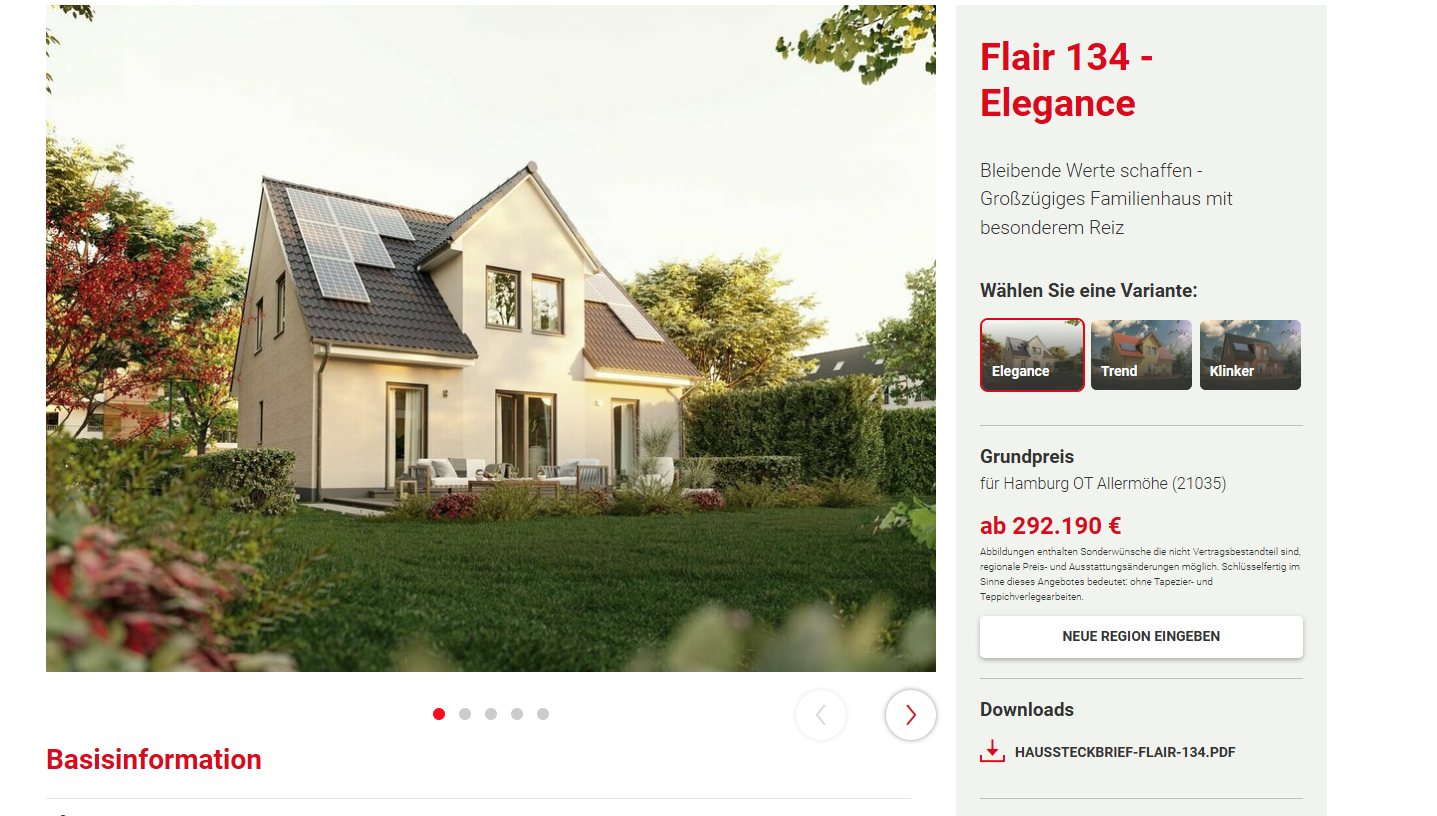

The question here would be how cheaply I could get a “simple” single-family house with about 130-140 sqm (1400-1500 sq ft) of living space. 🙁
Town & Country, for example, offers this starting at a certain price. Turnkey. There are several other providers as well. If the standard features meet your needs, it gives you a first reference point (of course, additional costs will still apply that you as the builder have to cover).
MachsSelbst
12 Nov 2025 20:22
300,000 EUR for the turnkey Flair 134, plus another 25,000 EUR worth of materials for DIY interior finishing (Town & Country typically only tiles the bathrooms/WCs, utility room, kitchen, and hallway are not included). About 50,000 EUR for additional construction costs, and then the demolition and disposal of the existing building, which should not be forgotten.
It will be at least 400,000 EUR, probably more.
And nothing has happened outside yet, not even the excavation and removal of soil for the foundation have been carried out and disposed of...
