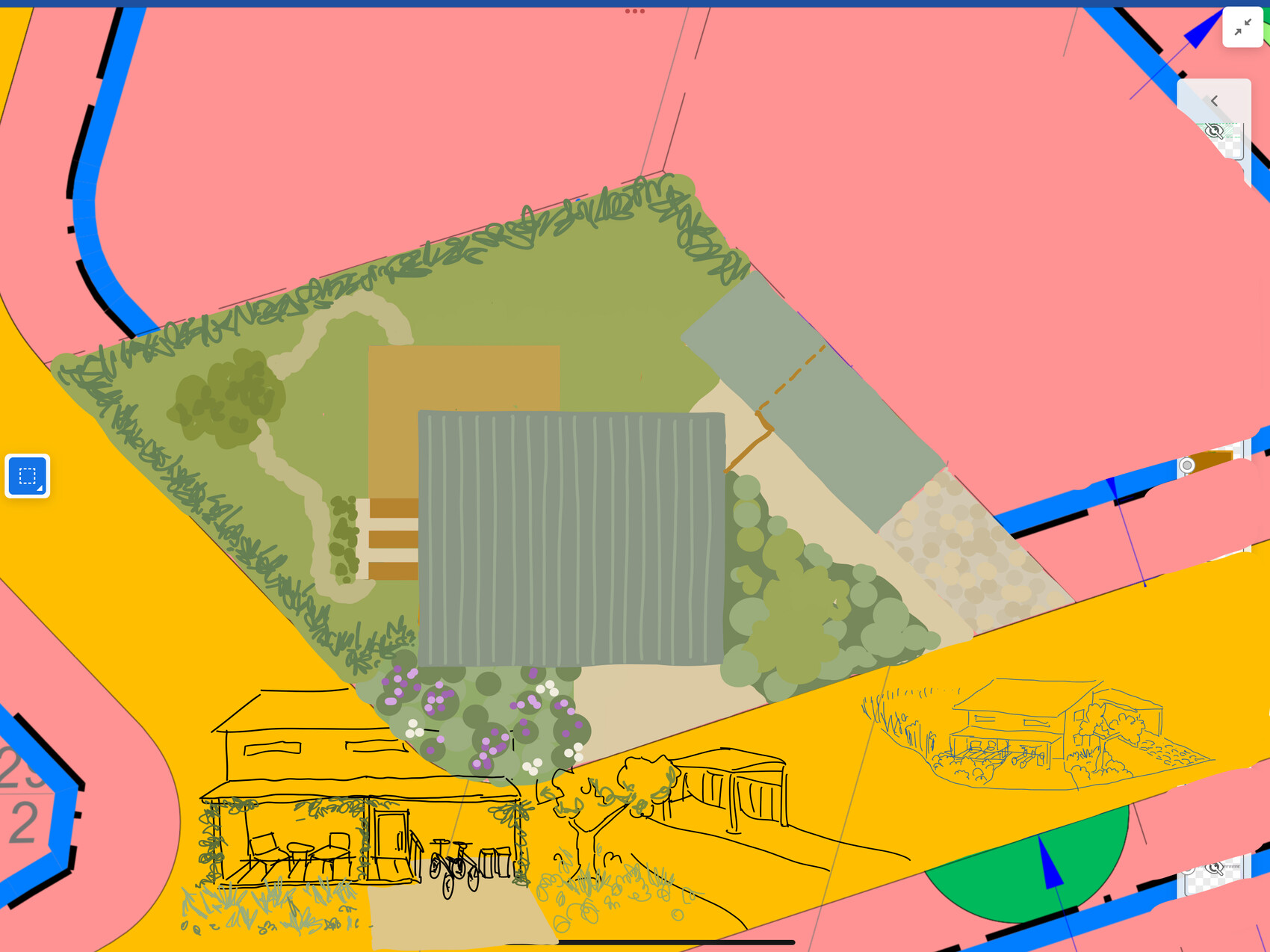

Because our preferred plot allows it and the development plan doesn’t specify ridge direction, we want to orient the shed roof southwards. We also tried placing the house directly against the left or right boundary but didn’t like it. The development plan limits the maximum height to 7 m (23 ft) for houses with a roof pitch under 15°. The high side reaches 7 m (23 ft) with an interior height of 3.23 m (10 ft 7 in), and the low side is 2.32 m (7 ft 7 in) inside. We are also planning a small porch on the south side with space for bikes and possibly trash bins. We plan to add a seating area in the remaining space later.

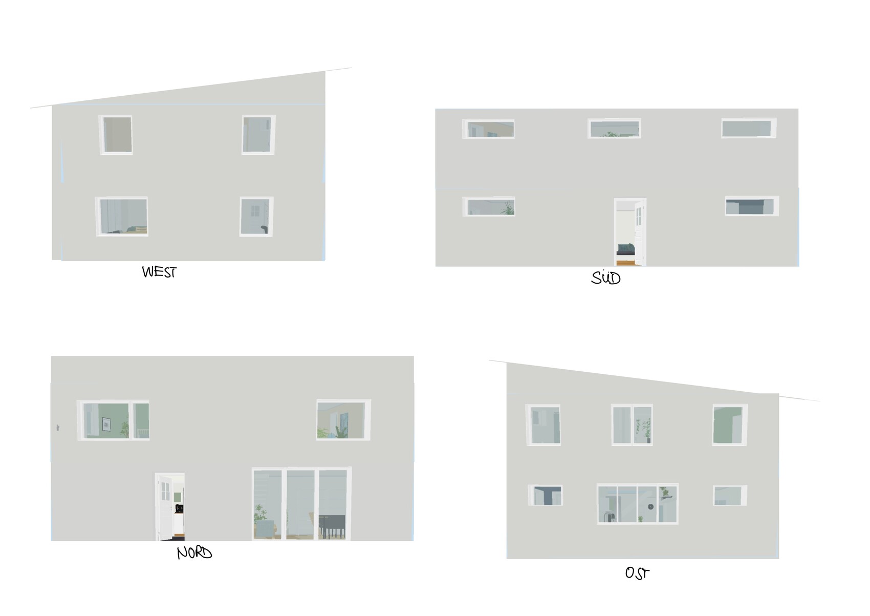

The floor plan was from the very first version by the builder, but it only shares the exterior dimensions with the current plan. The attached house elevation was also drawn by my girlfriend and was mostly relevant for the window layout (the labeling of compass directions and house sides is correct, but the roof isn’t!).

Ibdk14 schrieb:
Is the floor plan yours, or is it a proposal from the construction company? I find it quite strange. For example, where would the dining table be? Why is the utility room located there? It all feels very random and not well thought out at all.It’s ours. The dining table, for example, would be in the upper right corner with a corner bench against the wall of the utility room. That room is located there because the utility connections come in at that point.Ibdk14 schrieb:
Is the floor plan yours, or is it a proposal from the construction company? I find it quite strange. I think it has already been mentioned that only the exterior dimensions were kept from the original.
Ibdk14 schrieb:
Where would, for example, the dining table be? Why is the utility room located there? Everything seems very random and not well thought out at all. My guess is more like: it was overthought too many times.

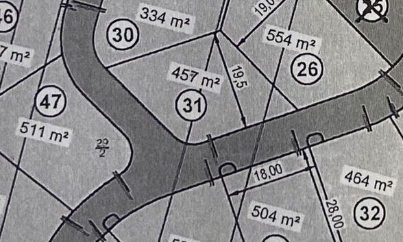

Paswina schrieb:
I think that’s it. Let the discussion begin 🙂I was wondering what discussion you meant… and I see that some important information is missing. You are actually in the wrong subforum. Please fill out this questionnaire, especially the information about the building plot. A site plan with dimensions makes more sense.
Roof overhangs over 50cm (20 inches) are added to the floor area ratio, and I believe the setback rules also then apply to them.
The blue line is not there just for decoration where it is 😉
Edit: As a single-story building, the bathroom won’t work because the required ceiling height is not available there.
