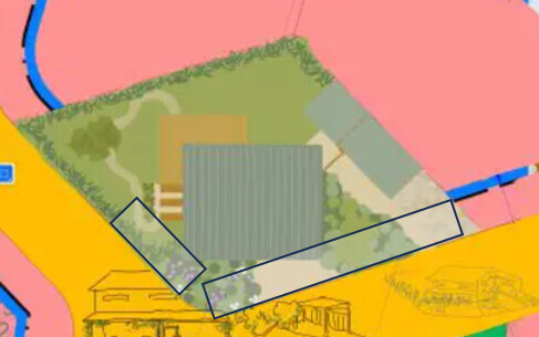

hanghaus202315 Aug 2023 13:30Paswina schrieb:
@hanghaus2023 my girlfriendWhat do you want to say with that? If anything, boyfriend.hanghaus2023 schrieb:
What do you mean by that? If anything, it should be friend.You askedhanghaus2023 schrieb:
Who created the pictures?30 characters 30 characters 30 characters ...https://www.instagram.com/11antgmxde/
Your girlfriend is not respecting the building boundary on the southeast and southwest sides. In my opinion, the terrace and entrance roof should also not extend beyond the building boundary.
Thanks @hanghaus2023, that was just a sketch on the iPad; the builder will draw it properly, also for the building permit / planning permission. We and the builder will double-check the terrace and entrance roof, in our case the veranda, against legal requirements!
