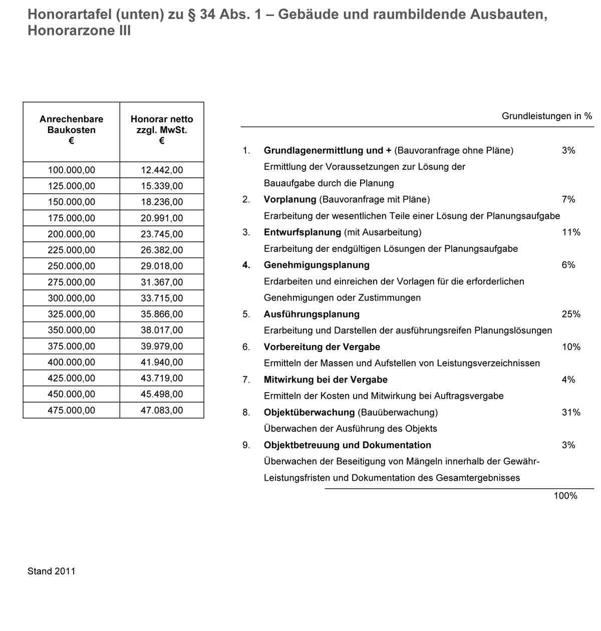

What does an architect typically cost for the entire project from start to finish with an investment sum of about 220,000 EUR (excluding land)?
Around 31,000 EUR according to the fee schedule, assuming standard supervision by the architect.
Document with fee schedule under §34 Para. 1 and construction cost tables, status 2011
