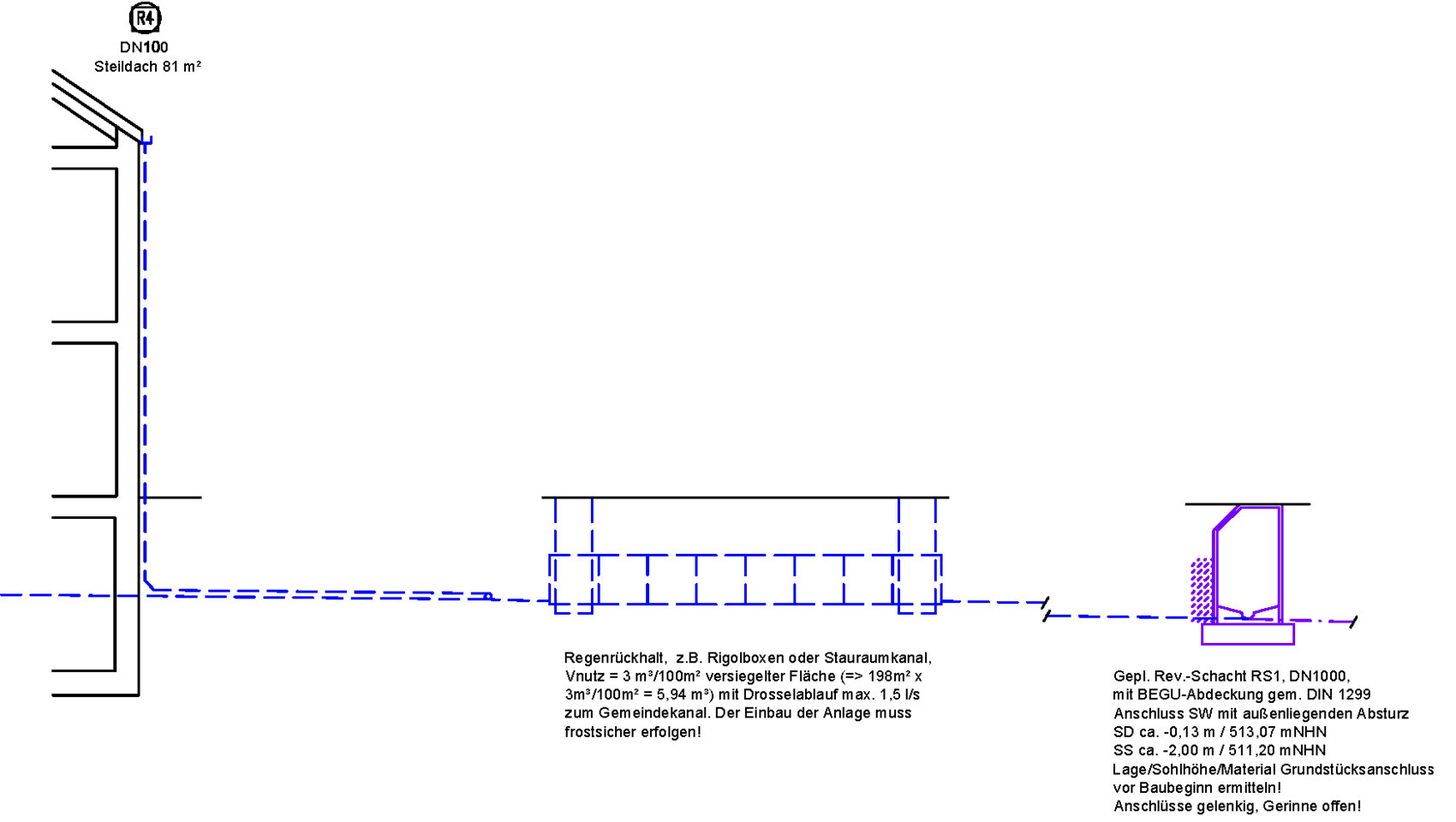

After we received the building permit/planning permission, the architect prepared the drainage plan and submitted it to the local authority (but we haven’t received a response yet).
Do I need to apply separately for the wastewater/drainage connection, or is submitting the plan enough?
The architect has planned a rainwater retention system (which, as far as I understand, is required by the local authority). Do I need to commission this separately? Is it part of the drainage connection work?

Whether your excavation contractor also installs the rainwater retention system should be stated in the documents. Usually, it makes sense to install a combined cistern, where the upper part is used for retention and the lower part for garden irrigation.
