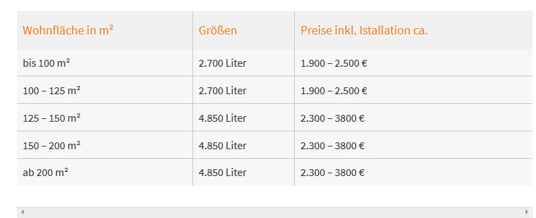

After a brief search, I found the following prices:
Tabular overview of living areas (m²), sizes 2,700/4,850 L and price ranges 1,900-3,800 €.

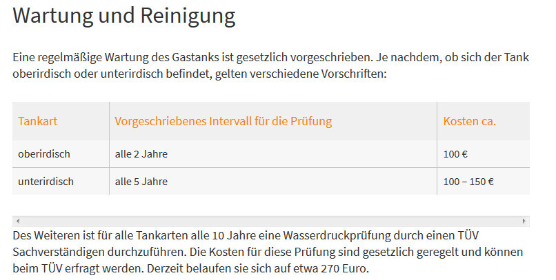

and additionally
Maintenance and cleaning: Table with tank types, inspection intervals and costs; technical inspection mentioned.
So, the important questions are: above ground or underground? House size?
