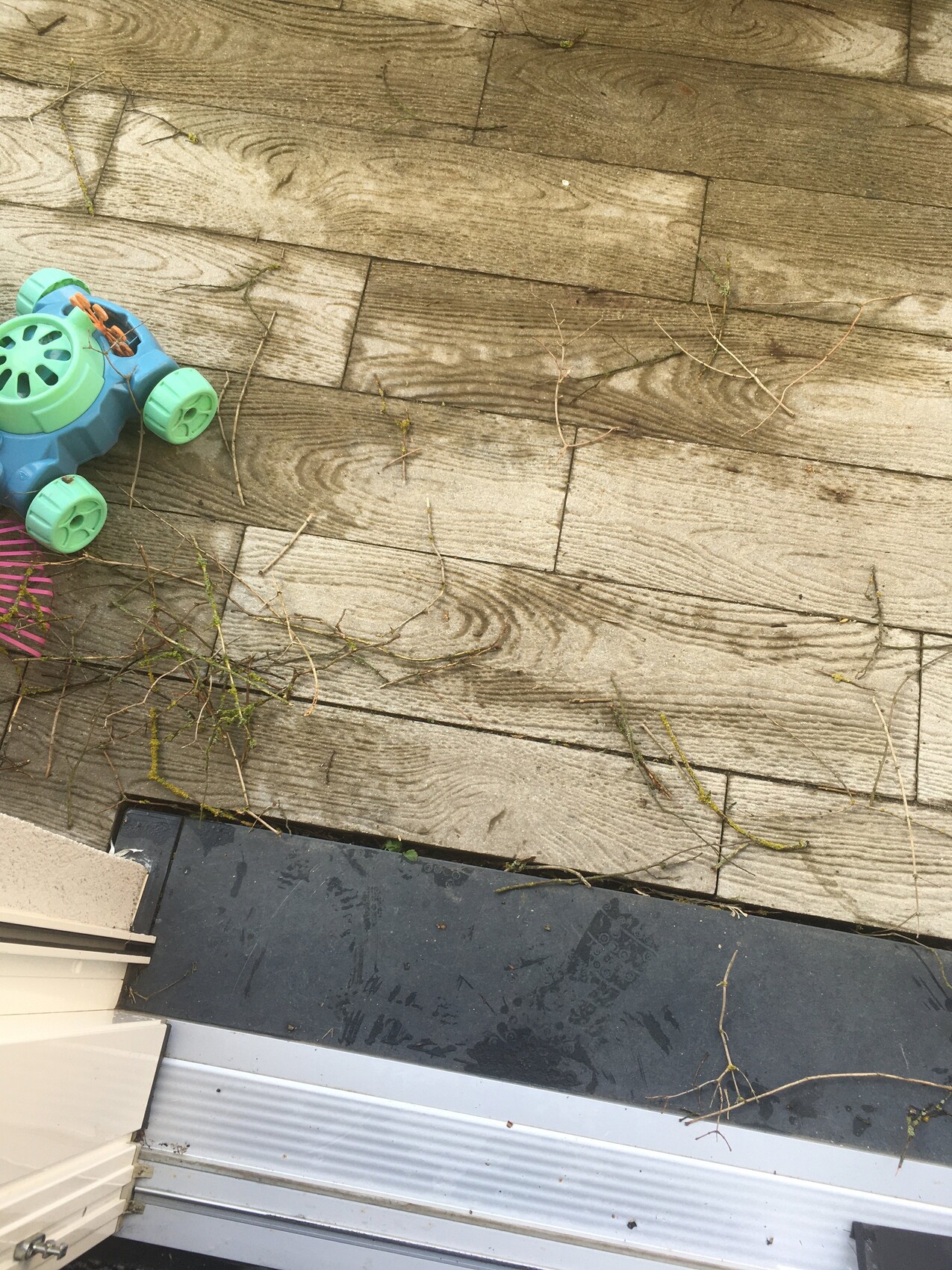

Do not disturb the branches. Last year, the Eurasian jay desperately tried to build a nest on the ridge beam.
I don’t have anything cleaner, drier, without children, or with more windowsills on hand right now.

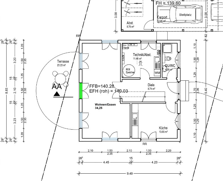

I wanted a threshold-free door but still tilt-and-turn.
I wouldn’t recommend that—flat threshold and tilt-and-turn is not a good combination. Typically, I would choose the door closer to the room or wall center (and usually the widest) as the main exit with a flat threshold, and the outer doors as tilt-and-turn (for example, one sash tilt-and-turn and one fixed, with the tilt-and-turn sash on the right side from the inside for right-handed people).

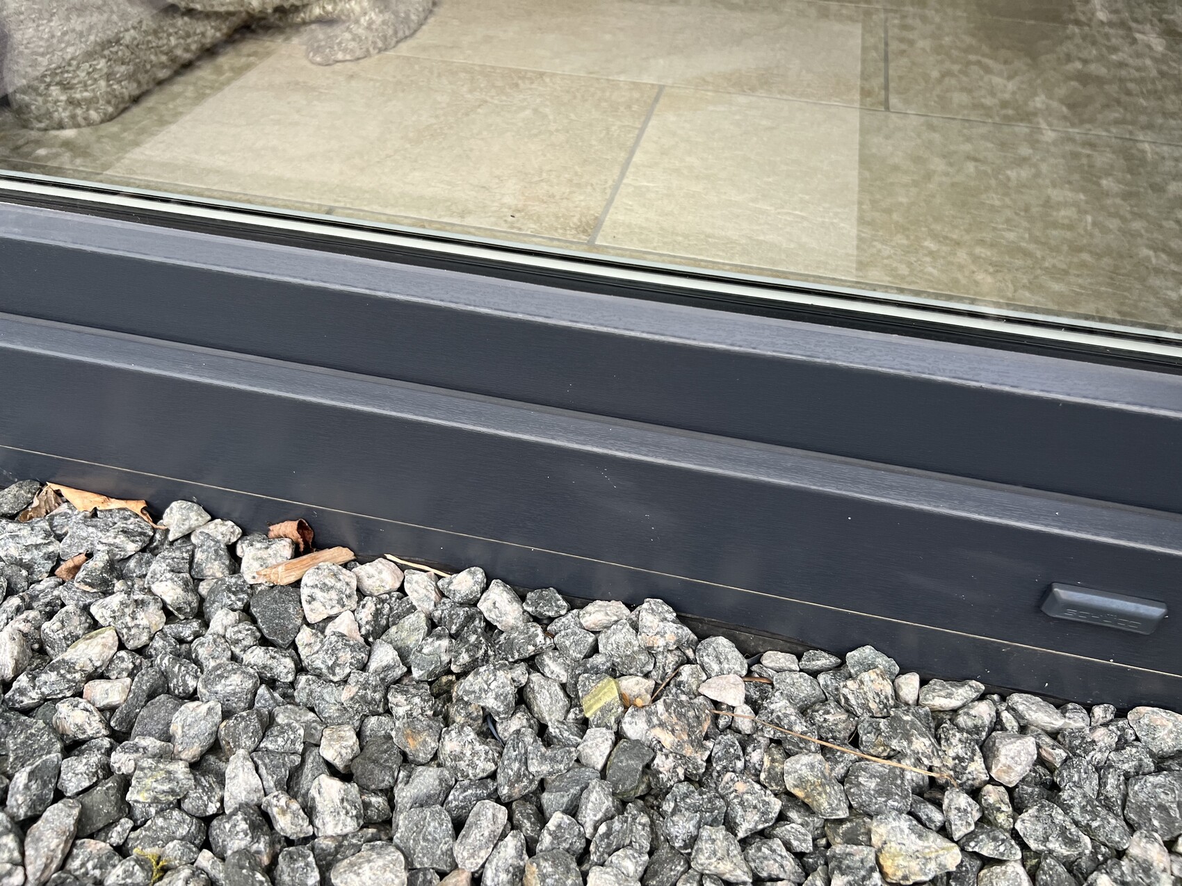

Sounds interesting. Could someone here explain exactly what you need to say or ask for during the selection process to get all floor-to-ceiling windows aligned with the terrace?
I’m not sure if you actually mean the expensive threshold-free windows @Pinkiponk
We were asked whether we wanted a step or external sill. It was explained that we would then have to lay flooring up to the window, which is what we chose, ordered, and the landscaping contractor installed.

Traditionally, I would use the door closest to the center of the room or wall side (and widest) as the exit with a flat threshold, and the outer doors as tilt-and-turn (or one sash tilt-and-turn and one sash fixed, for right-handed users the tilt-and-turn on the inside right).
Something like this (blue = classic fixed/tilt-and-turn, green = flat-threshold fixed/fixed) as shown:
