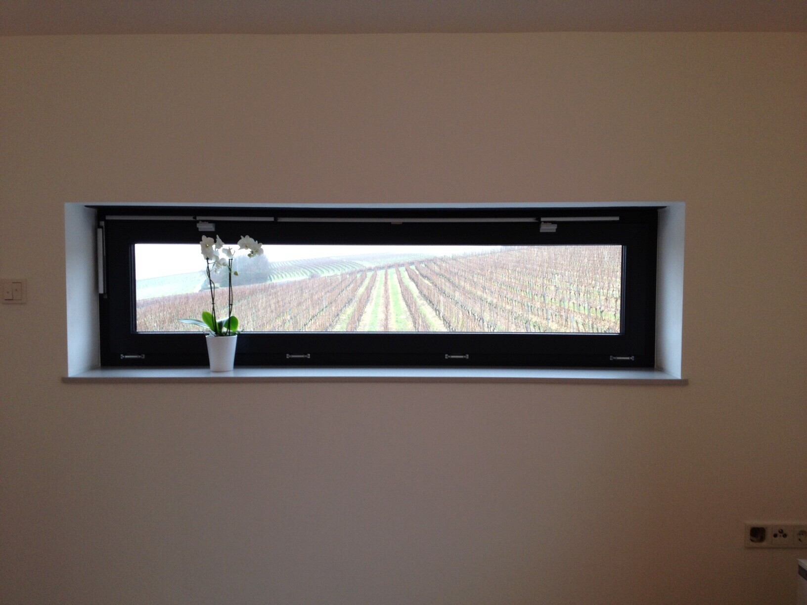

One0016 Jan 2015 12:57
In the living room, there is also a fixed-glass light strip above the sofa or where it will be placed, with an opening size of 200 x 70 cm (79 x 28 inches).
Additionally, on the upper floor, there are light strips in every room and one in the hallway, each with an opening size of 200 x 57 cm (79 x 22 inches). These are tilt windows that can be fully opened for cleaning (see attachment).
For adults, these windows are not suitable for looking outside while standing normally (parapet height approx. 80 cm (31 inches)), but you can easily place a bed, a desk, or a bathtub in front of them, and they provide a lot of extra natural light in the room.
