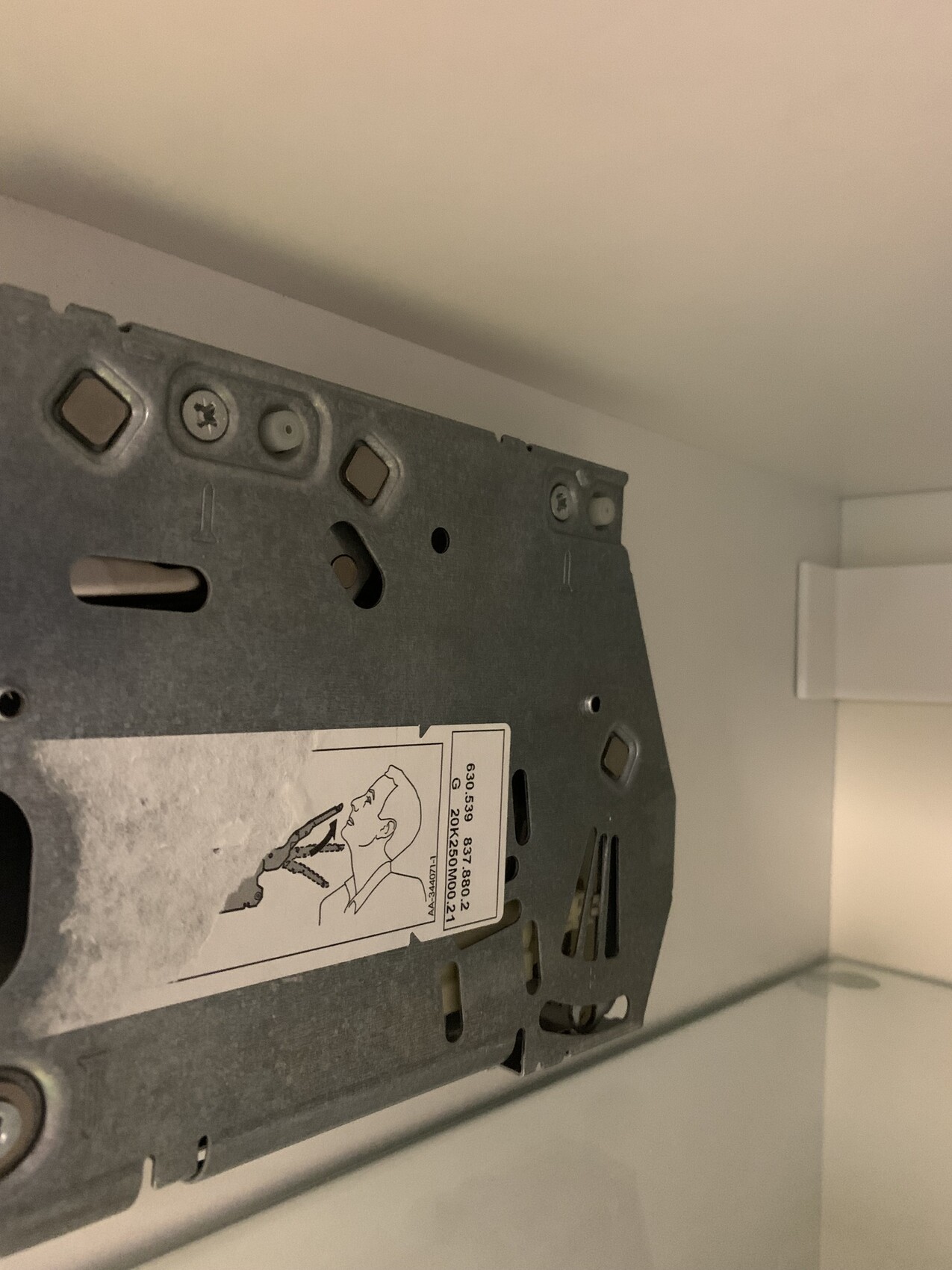

after a long and unsuccessful search on the internet, I hope to find some help here.
We inherited a Faktum kitchen in our house, and suddenly the horizontal door slams shut without any damping.
I assume the damper is broken but the hinge is still intact.
Since I didnât order this kitchen myself, I donât know the names of these parts.
Could you maybe tell me where I can order something like this (just the damper possibly)?
Or if the current hinge from Metod might fit without needing to drill?
I have already contacted Blum and was referred to IKEA service.
Thank you very much in advance
i_b_n_a_n schrieb:
You can buy separately: UTRUSTA soft-close hinge for horizontal doors, white. Item number 837.880.2
The pair costs 44⏠(approx. $47)
P.S. The item number is on every Ikea product ;-) So as long as it's available, it's very easy to reorder ;-) Thank you for your response.
I still donât see how the new hinges for Metod could fit the Faktum versionâdifferent item number than mine, a different version, and a different shape.
To avoid possibly âdigging deeper,â I had the tiny hope of being able to buy just the dampers somewhere.
