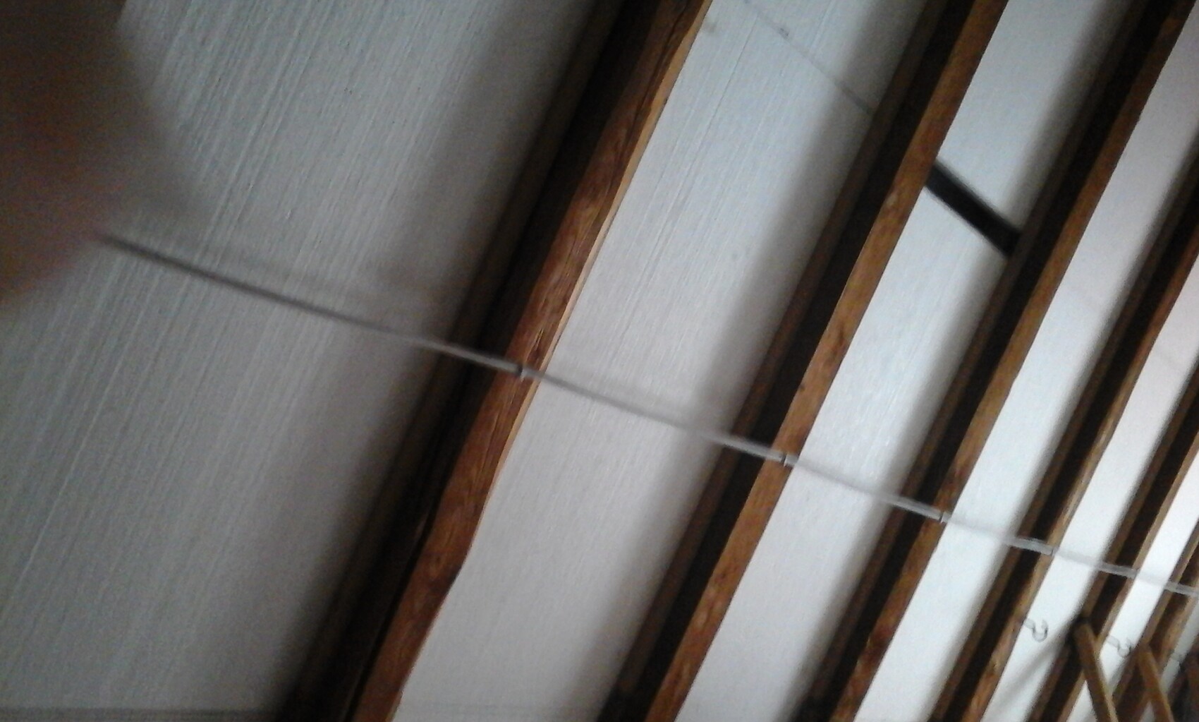

The small amount of polystyrene insulation probably has no effect.

schwabenhome schrieb:How can you be sure of that? If it’s about 5cm (2 inches), it could well have been typical for the building standards at the time.
... that little amount of Styrofoam won’t have any effect!
